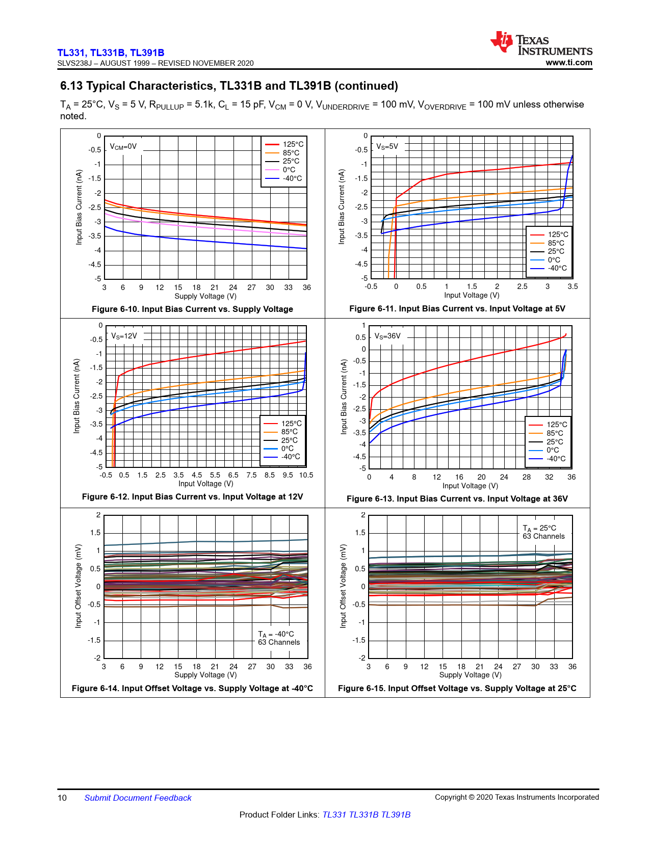

TL331, TL331B, TL391B. www.ti.com. 6.13 Typical Characteristics, TL331B and TL391B (continued)
TL331, TL331B, TL391B www.ti.com 6.13 Typical Characteristics, TL331B and TL391B (continued)
SLVS238J – AUGUST 1999 – REVISED NOVEMBER 2020
TA = 25°C, VS = 5 V, RPULLUP = 5.1k, CL = 15 pF, VCM = 0 V, VUNDERDRIVE = 100 mV, VOVERDRIVE = 100 mV unless otherwise noted. 0 0 V V -0.5 CM=0V 125°C S=5V 85°C -0.5 -1 25°C -1 0°C (nA) -1.5 -40°C (nA) -1.5 -2 -2 rrent rent Cu -2.5 Cur -2.5 ias as -3 -3 B Bi t -3.5 -3.5 125°C Input Inpu 85°C -4 -4 25°C 0°C -4.5 -4.5 -40°C -5 -5 3 6 9 12 15 18 21 24 27 30 33 36 -0.5 0 0.5 1 1.5 2 2.5 3 3.5 Supply Voltage (V) Input Voltage (V)
Figure 6-10. Input Bias Current vs. Supply Voltage Figure 6-11. Input Bias Current vs. Input Voltage at 5V
0 1 V -0.5 S=12V 0.5 VS=36V 0 -1 -0.5 (nA) -1.5 (nA) -1 rent -2 rrent -1.5 Cur -2.5 Cu -2 ias -3 ias -2.5 B B -3.5 125°C -3 125°C Input 85°C Input -3.5 85°C -4 25°C -4 25°C 0°C -4.5 0°C -40°C -4.5 -40°C -5 -5 -0.5 0.5 1.5 2.5 3.5 4.5 5.5 6.5 7.5 8.5 9.5 10.5 0 4 8 12 16 20 24 28 32 36 Input Voltage (V) Input Voltage (V)
Figure 6-12. Input Bias Current vs. Input Voltage at 12V Figure 6-13. Input Bias Current vs. Input Voltage at 36V
2 2 T 1.5 1.5 A = 25°C 63 Channels 1 1 (mV) (mV) ge 0.5 ge 0.5 ta ta Vol Vol t 0 t 0 se se Off -0.5 Off -0.5 t t u u -1 -1 Inp Inp TA = -40°C -1.5 63 Channels -1.5 -2 -2 3 6 9 12 15 18 21 24 27 30 33 36 3 6 9 12 15 18 21 24 27 30 33 36 Supply Voltage (V) Supply Voltage (V)
Figure 6-14. Input Offset Voltage vs. Supply Voltage at -40°C Figure 6-15. Input Offset Voltage vs. Supply Voltage at 25°C
