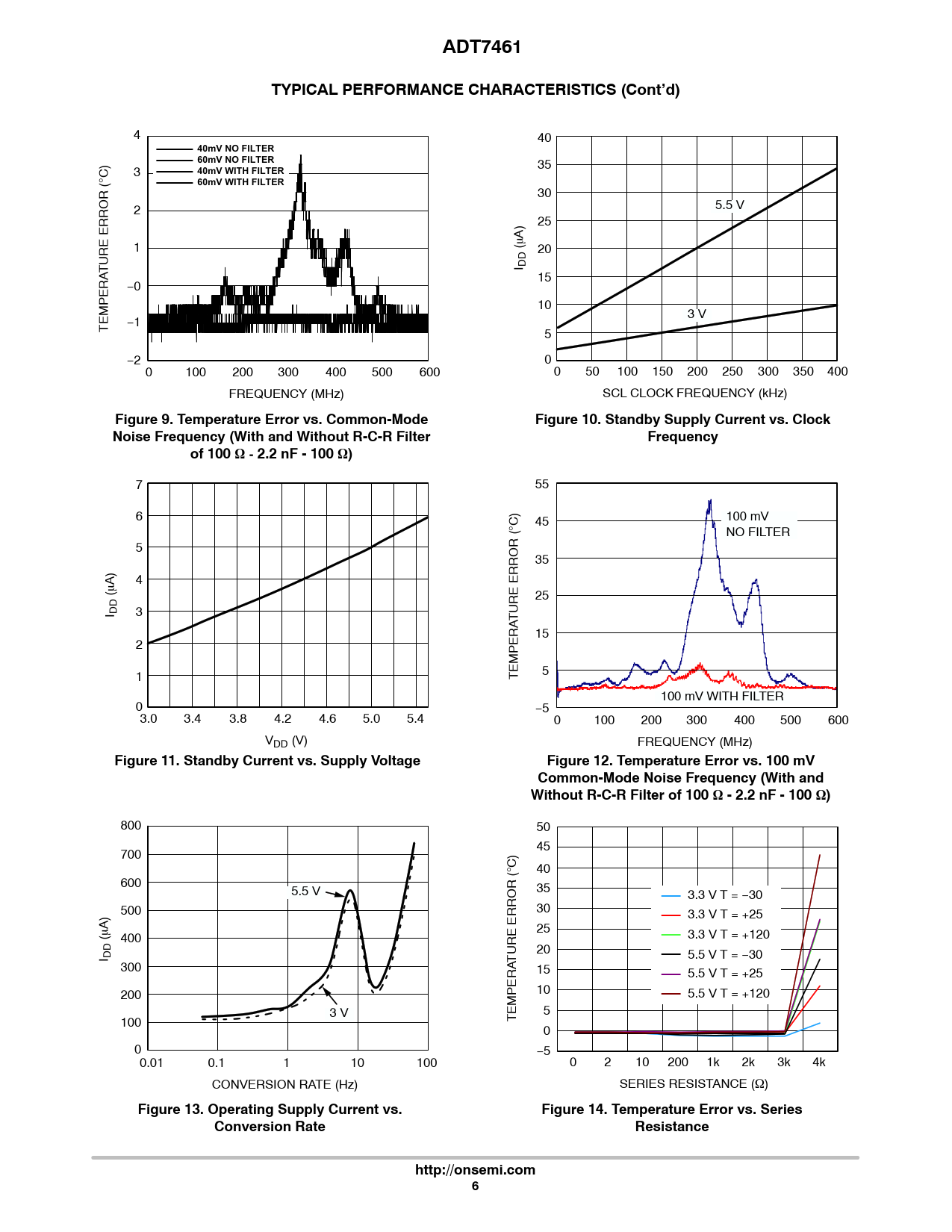

ADT7461. TYPICAL PERFORMANCE CHARACTERISTICS (Cont’d). 40mV NO FILTER. 60mV NO FILTER. 40mV WITH FILTER. 60mV WITH FILTER
ADT7461 TYPICAL PERFORMANCE CHARACTERISTICS (Cont’d) 40mV NO FILTER 60mV NO FILTER 40mV WITH FILTER 60mV WITH FILTER
4 40
35 3
40mV WITH FILTER
°C)
60mV WITH FILTER
30 2 5.5 V 25 1 (mA) 20 TURE ERROR ( I DD 15 −0 10 3 V TEMPERA −1 5 −2 0 0 100 200 300 400 500 600 0 50 100 150 200 250 300 350 400 FREQUENCY (MHz) SCL CLOCK FREQUENCY (kHz)
Figure 9. Temperature Error vs. Common-Mode Figure 10. Standby Supply Current vs. Clock Noise Frequency (With and Without R-C-R Filter Frequency of 100 W Ć 2.2 nF - 100 W)
7 55 6 100 mV °C) 45 NO FILTER 5 35 4 (mA) 25 I DD 3 TURE ERROR ( 15 2 1 TEMPERA 5 100 mV WITH FILTER 0 −5 3.0 3.4 3.8 4.2 4.6 5.0 5.4 0 100 200 300 400 500 600 VDD (V) FREQUENCY (MHz)
Figure 11. Standby Current vs. Supply Voltage Figure 12. Temperature Error vs. 100 mV Common-Mode Noise Frequency (With and Without R-C-R Filter of 100 W - 2.2 nF - 100 W)
800 50 45 700 °C) 40 600 5.5 V 35 3.3 V T = −30 500 30 3.3 V T = +25 25 (mA) 400 3.3 V T = +120 20 I DD TURE ERROR ( 5.5 V T = −30 300 15 5.5 V T = +25 200 10 5.5 V T = +120 3 V 5 100 TEMPERA 0 0 −5 0.01 0.1 1 10 100 0 2 10 200 1k 2k 3k 4k CONVERSION RATE (Hz) SERIES RESISTANCE (W)
Figure 13. Operating Supply Current vs. Figure 14. Temperature Error vs. Series Conversion Rate Resistance http://onsemi.com 6
