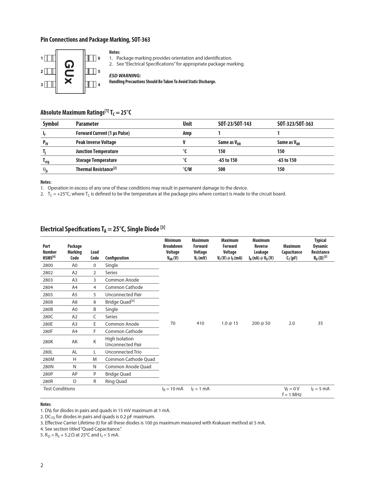

Pages / Page10 / 2 — Pin Connections and Package Marking, SOT-363. Notes:. GUx. ESD WARNING:
File Format / SizePDF / 165 Kb
Pin Connections and Package Marking, SOT-363 Notes: GUx ESD WARNING:
Pin Connections and Package Marking, SOT-363 Notes: 1 GUx 6
1. Package marking provides orientation and identification. 2. See “Electrical Specifications” for appropriate package marking.
2 5 ESD WARNING: Handling Precautions Should Be Taken To Avoid Static Discharge. 3 4 Absolute Maximum Ratings[1] TC = 25°C Symbol Parameter Unit SOT-23/SOT-143 SOT-323/SOT-363 If Forward Current (1 μs Pulse) Amp 1 1 PIV Peak Inverse Voltage V Same as VBR Same as VBR Tj Junction Temperature °C 150 150 Tstg Storage Temperature °C -65 to 150 -65 to 150
T
jc Thermal Resistance[2] °C/W 500 150 Notes:
1. Operation in excess of any one of these conditions may result in permanent damage to the device. 2. TC = +25°C, where TC is defined to be the temperature at the package pins where contact is made to the circuit board.
Electrical Specifications TA = 25°C, Single Diode [3] Minimum Maximum Maximum Maximum Typical Part Package Breakdown Forward Forward Reverse Maximum Dynamic Number Marking Lead Voltage Voltage Voltage Leakage Capacitance Resistance HSMS[4] Code Code Configuration VBR (V) VF (mV) VF (V) @ IF (mA) IR (nA) @ VR (V) CT (pF) RD (Ω)[5]
2800 A0 0 Single 2802 A2 2 Series 2803 A3 3 Common Anode 2804 A4 4 Common Cathode 2805 A5 5 Unconnected Pair 2808 A8 8 Bridge Quad[4] 280B A0 B Single 280C A2 C Series 280E A3 E Common Anode 70 410 1.0 @ 15 200 @ 50 2.0 35 280F A4 F Common Cathode High Isolation 280K AK K Unconnected Pair 280L AL L Unconnected Trio 280M H M Common Cathode Quad 280N N N Common Anode Quad 280P AP P Bridge Quad 280R O R Ring Quad Test Conditions IR = 10 mA IF = 1 mA VF = 0 V IF = 5 mA f = 1 MHz
Notes:
1. DVF for diodes in pairs and quads in 15 mV maximum at 1 mA. 2. DCTO for diodes in pairs and quads is 0.2 pF maximum. 3. Effective Carrier Lifetime (t) for all these diodes is 100 ps maximum measured with Krakauer method at 5 mA. 4. See section titled “Quad Capacitance.” 5. RD = RS + 5.2 Ω at 25°C and If = 5 mA. 2
