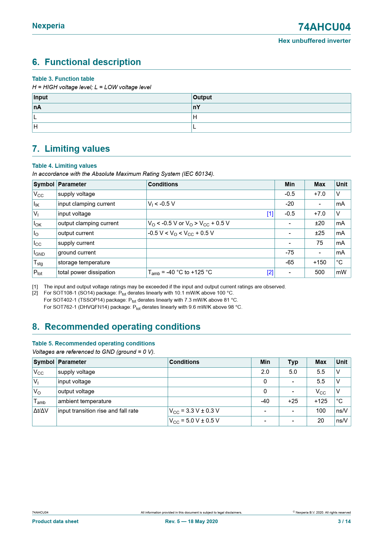

Nexperia. 74AHCU04. Hex unbuffered inverter. 6. Functional description Table 3. Function table. Input. Output
Nexperia 74AHCU04 Hex unbuffered inverter 6 Functional description Table 3 Function table Input Output
link to page 3 link to page 3
Nexperia 74AHCU04 Hex unbuffered inverter 6. Functional description Table 3. Function table
H = HIGH voltage level; L = LOW voltage level
Input Output nA nY
L H H L
7. Limiting values Table 4. Limiting values
In accordance with the Absolute Maximum Rating System (IEC 60134).
Symbol Parameter Conditions Min Max Unit
VCC supply voltage -0.5 +7.0 V IIK input clamping current VI < -0.5 V -20 - mA VI input voltage [1] -0.5 +7.0 V IOK output clamping current VO < -0.5 V or VO > VCC + 0.5 V - ±20 mA IO output current -0.5 V < VO < VCC + 0.5 V - ±25 mA ICC supply current - 75 mA IGND ground current -75 - mA Tstg storage temperature -65 +150 °C Ptot total power dissipation Tamb = -40 °C to +125 °C [2] - 500 mW [1] The input and output voltage ratings may be exceeded if the input and output current ratings are observed. [2] For SOT108-1 (SO14) package: Ptot derates linearly with 10.1 mW/K above 100 °C. For SOT402-1 (TSSOP14) package: Ptot derates linearly with 7.3 mW/K above 81 °C. For SOT762-1 (DHVQFN14) package: Ptot derates linearly with 9.6 mW/K above 98 °C.
8. Recommended operating conditions Table 5. Recommended operating conditions
Voltages are referenced to GND (ground = 0 V).
Symbol Parameter Conditions Min Typ Max Unit
VCC supply voltage 2.0 5.0 5.5 V VI input voltage 0 - 5.5 V VO output voltage 0 - VCC V Tamb ambient temperature -40 +25 +125 °C Δt/ΔV input transition rise and fall rate VCC = 3.3 V ± 0.3 V - - 100 ns/V VCC = 5.0 V ± 0.5 V - - 20 ns/V 74AHCU04 All information provided in this document is subject to legal disclaimers. © Nexperia B.V. 2020. Al rights reserved
