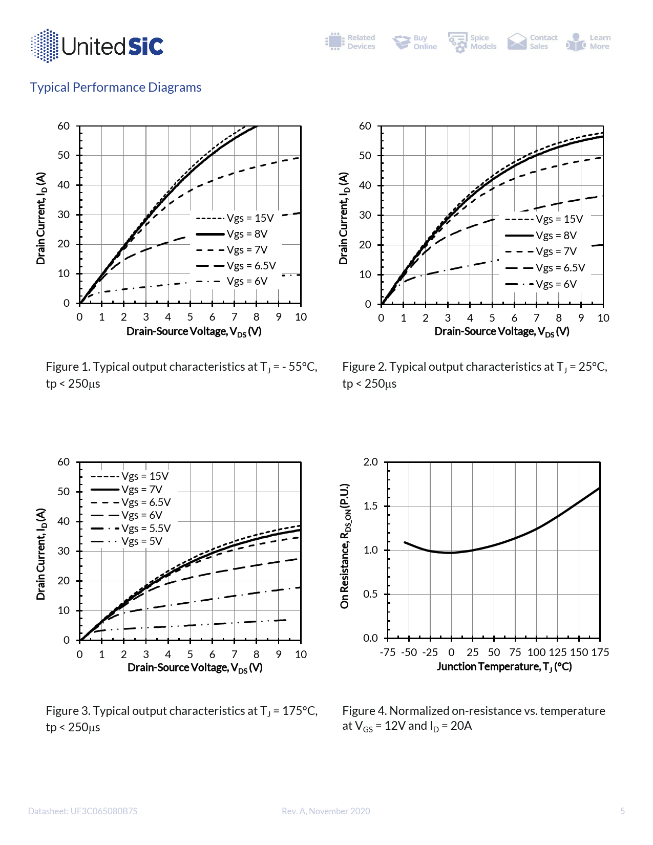

Pages / Page10 / 5 — Typical. Performance. Diagrams. 60. 60. 50. 50. ). A(. A. 40. (. 40. I. …
File Format / SizePDF / 441 Kb
Typical. Performance. Diagrams. 60. 60. 50. 50. ). A(. A. 40. (. 40. I. ,. D. I. ,. D. nte. nt. r. 30. e. r. Vgs. =. 15V. r. 30. r. Vgs. =. 15V. Cu. Vgs. =. 8V. Cu. n. Vgs. =. 8V. 20. n. ai. 20. r. Vgs. =. 7V. air. Vgs. =. 7V. D
Typical Performance Diagrams 60 60 50 50 ) A( A 40 ( 40 I , D I , D nte nt r 30 e r Vgs = 15V r 30 r Vgs = 15V Cu Vgs = 8V Cu n Vgs = 8V 20 n ai 20 r Vgs = 7V air Vgs = 7V D
Typical Performance Diagrams 60 60 50 50 ) A( A 40 ( 40 I , D I , D nte nt r 30 e r Vgs = 15V r 30 r Vgs = 15V Cu Vgs = 8V Cu n Vgs = 8V 20 n ai 20 r Vgs = 7V air Vgs = 7V D Vgs = 6.5V D 10 Vgs = 6.5V 10 Vgs = 6V Vgs = 6V 0 0 0 1 2 3 4 5 6 7 8 9 10 0 1 2 3 4 5 6 7 8 9 10 Drain-Source Voltage, VDS (V) Drain-Source Voltage, VDS (V) Figure 1. Typical output characteristics at TJ = - 55°C, Figure 2. Typical output characteristics at TJ = 25°C, tp < 250ms tp < 250ms 60 2.0 Vgs = 15V ). 50 Vgs = 7V U. ) Vgs = 6.5V P( 1.5 A( N 40 Vgs = 6V _O I S , D Vgs = 5.5V nt R D , e Vgs = 5V r e 30 r c 1.0 an Cu st n 20 si ai e r R D 0.5 10 On 0 0.0 0 1 2 3 4 5 6 7 8 9 10 -75 -50 -25 0 25 50 75 100 125 150 175 Drain-Source Voltage, V Junction Temperature, T DS (V) J (°C) Figure 3. Typical output characteristics at TJ = 175°C, Figure 4. Normalized on-resistance vs. temperature tp < 250ms at VGS = 12V and ID = 20A Datasheet: UF3C065080B7S Rev. A, November 2020 5
