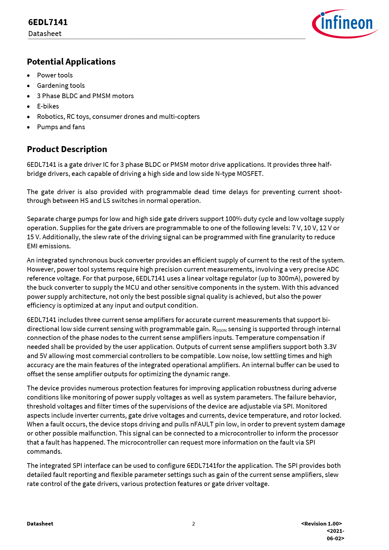

6EDL7141
Datasheet
Potential Applications
Power tools Gardening tools 3 Phase BLDC and PMSM motors E-bikes Robotics, RC toys, consumer drones and multi-copters Pumps and fans
Product Description
6EDL7141 is a gate driver IC for 3 phase BLDC or PMSM motor drive applications. It provides three half- bridge drivers, each capable of driving a high side and low side N-type MOSFET. The gate driver is also provided with programmable dead time delays for preventing current shoot- through between HS and LS switches in normal operation. Separate charge pumps for low and high side gate drivers support 100% duty cycle and low voltage supply operation. Supplies for the gate drivers are programmable to one of the following levels: 7 V, 10 V, 12 V or 15 V. Additionally, the slew rate of the driving signal can be programmed with fine granularity to reduce EMI emissions. An integrated synchronous buck converter provides an efficient supply of current to the rest of the system. However, power tool systems require high precision current measurements, involving a very precise ADC reference voltage. For that purpose, 6EDL7141 uses a linear voltage regulator (up to 300mA), powered by the buck converter to supply the MCU and other sensitive components in the system. With this advanced power supply architecture, not only the best possible signal quality is achieved, but also the power efficiency is optimized at any input and output condition. 6EDL7141 includes three current sense amplifiers for accurate current measurements that support bi- directional low side current sensing with programmable gain. RDSON sensing is supported through internal connection of the phase nodes to the current sense amplifiers inputs. Temperature compensation if needed shall be provided by the user application. Outputs of current sense amplifiers support both 3.3V and 5V allowing most commercial controllers to be compatible. Low noise, low settling times and high accuracy are the main features of the integrated operational amplifiers. An internal buffer can be used to offset the sense amplifier outputs for optimizing the dynamic range. The device provides numerous protection features for improving application robustness during adverse conditions like monitoring of power supply voltages as well as system parameters. The failure behavior, threshold voltages and filter times of the supervisions of the device are adjustable via SPI. Monitored aspects include inverter currents, gate drive voltages and currents, device temperature, and rotor locked. When a fault occurs, the device stops driving and pulls nFAULT pin low, in order to prevent system damage or other possible malfunction. This signal can be connected to a microcontroller to inform the processor that a fault has happened. The microcontroller can request more information on the fault via SPI commands. The integrated SPI interface can be used to configure 6EDL7141for the application. The SPI provides both detailed fault reporting and flexible parameter settings such as gain of the current sense amplifiers, slew rate control of the gate drivers, various protection features or gate driver voltage.
Datasheet
2
<Revision 1.00> <2021- 06-02>
