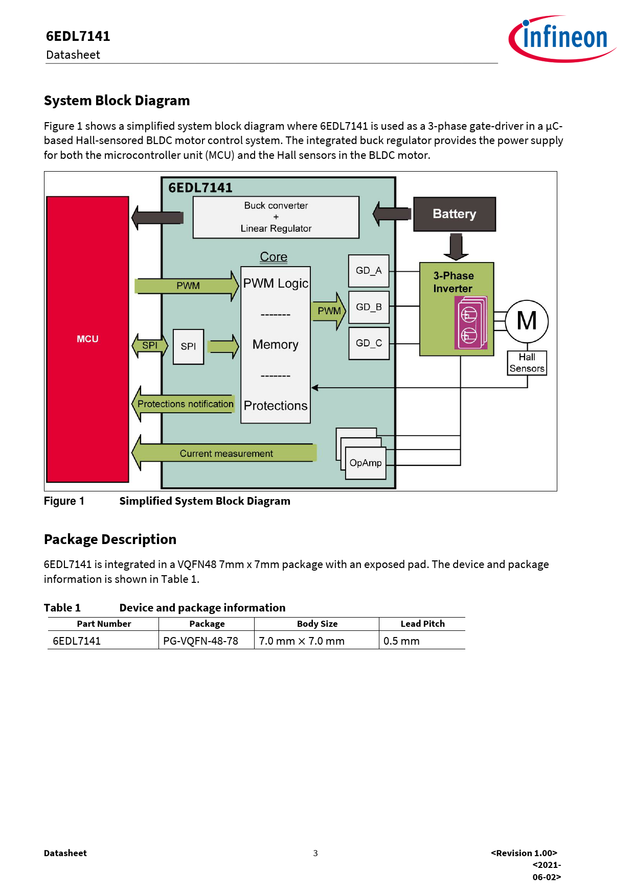

System Block Diagram
Figure 1 shows a simplified system block diagram where 6EDL7141 is used as a 3-phase gate-driver in a µC- based Hall-sensored BLDC motor control system. The integrated buck regulator provides the power supply for both the microcontroller unit (MCU) and the Hall sensors in the BLDC motor.
Figure 1 Simplified System Block Diagram Package Description
6EDL7141 is integrated in a VQFN48 7mm x 7mm package with an exposed pad. The device and package information is shown in Table 1.
Table 1 Device and package information Part Number Package Body Size Lead Pitch
6EDL7141 PG-VQFN-48-78 7.0 mm × 7.0 mm 0.5 mm
