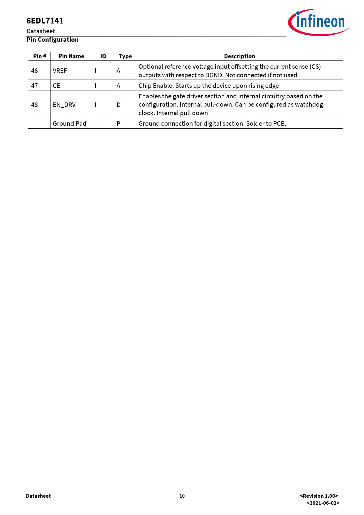

Pin Configuration Pin # Pin Name IO Type Description
Optional reference voltage input offsetting the current sense (CS) 46 VREF I A outputs with respect to DGND. Not connected if not used 47 CE I A Chip Enable. Starts up the device upon rising edge Enables the gate driver section and internal circuitry based on the 48 EN_DRV I D configuration. Internal pull-down. Can be configured as watchdog clock. Internal pull down Ground Pad - P Ground connection for digital section. Solder to PCB.
