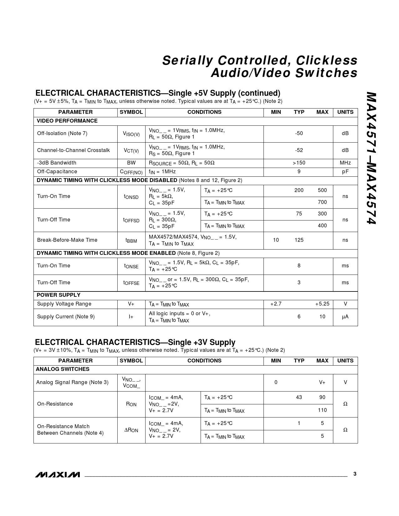

Serially Controlled, Clickless Audio/Video Switches MAX4571–MAX4574 ELECTRICAL CHARACTERISTICS—Single +5V Supply (continued)
(V+ = 5V ±5%, TA = TMIN to TMAX, unless otherwise noted. Typical values are at TA = +25°C.) (Note 2)
PARAMETER SYMBOL CONDITIONS MIN TYP MAX UNITS VIDEO PERFORMANCE
VNO_ _ = 1VRMS, fIN = 1.0MHz, Off-Isolation (Note 7) VISO(V) -50 dB RL = 50Ω, Figure 1 VNO_ _ = 1VRMS, fIN = 1.0MHz, Channel-to-Channel Crosstalk VCT(V) -52 dB RS = 50Ω, Figure 1 -3dB Bandwidth BW RSOURCE = 50Ω, RL = 50Ω >150 MHz Off-Capacitance COFF(NO) fIN = 1MHz 9 pF
DYNAMIC TIMING WITH CLICKLESS MODE DISABLED
(Notes 8 and 12, Figure 2) VNO_ _ = 1.5V, TA = +25°C 200 500 Turn-On Time tONSD RL = 5kΩ, ns CL = 35pF TA = TMIN to TMAX 700 VNO_ _ = 1.5V, TA = +25°C 75 300 Turn-Off Time tOFFSD RL = 300Ω, ns C T L = 35pF A = TMIN to TMAX 400 MAX4572/MAX4574, VNO_ _ = 1.5V, Break-Before-Make Time tBBM 10 125 ns TA = TMIN to TMAX
DYNAMIC TIMING WITH CLICKLESS MODE ENABLED
(Note 8, Figure 2) VNO_ _ = 1.5V, RL = 5kΩ, CL = 35pF, Turn-On Time tONSE 8 ms TA = +25°C VNO_ _ or = 1.5V, RL = 300Ω, CL = 35pF, Turn-Off Time tOFFSE 3 ms TA = +25°C
POWER SUPPLY
Supply Voltage Range V+ TA = TMIN to TMAX +2.7 +5.25 V All logic inputs = 0 or V+, Supply Current (Note 9) I+ 6 10 µA TA = TMIN to TMAX
ELECTRICAL CHARACTERISTICS—Single +3V Supply
(V+ = 3V ±10%, TA = TMIN to TMAX, unless otherwise noted. Typical values are at TA = +25°C.) (Note 2)
PARAMETER SYMBOL CONDITIONS MIN TYP MAX UNITS ANALOG SWITCHES
VNO_ _, Analog Signal Range (Note 3) 0 V+ V VCOM_ ICOM_ = 4mA, TA = +25°C 43 90 On-Resistance RON VNO_ _ =2V, Ω V+ = 2.7V TA = TMIN to TMAX 110 ICOM_ = 4mA, TA = +25°C 1 5 On-Resistance Match ∆RON VNO_ _ = 2V, Ω Between Channels (Note 4) V+ = 2.7V TA = TMIN to TMAX 5
