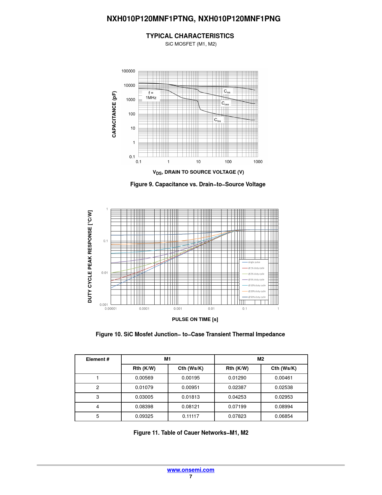

NXH010P120MNF1PTNG, NXH010P120MNF1PNG. TYPICAL CHARACTERISTICS. ANCE (pF). ACIT. CAP. VDS, DRAIN TO SOURCE VOLTAGE (V)
NXH010P120MNF1PTNG, NXH010P120MNF1PNG TYPICAL CHARACTERISTICS
SiC MOSFET (M1, M2)
ANCE (pF) ACIT CAP VDS, DRAIN TO SOURCE VOLTAGE (V) Figure 9. Capacitance vs. Drain−to−Source Voltage
5
C/W] DUTY CYCLE PEAK RESPONSE [ PULSE ON TIME [s] Figure 10. SiC Mosfet Junction− to−Case Transient Thermal Impedance Element # M1 M2 Rth (K/W) Cth (Ws/K) Rth (K/W) Cth (Ws/K)
1 0.00569 0.00195 0.01290 0.00461 2 0.01079 0.00951 0.02387 0.02538 3 0.03005 0.01813 0.04253 0.02953 4 0.08398 0.08121 0.07199 0.08994 5 0.09325 0.11117 0.07823 0.06854
Figure 11. Table of Cauer Networks−M1, M2 www.onsemi.com 7
