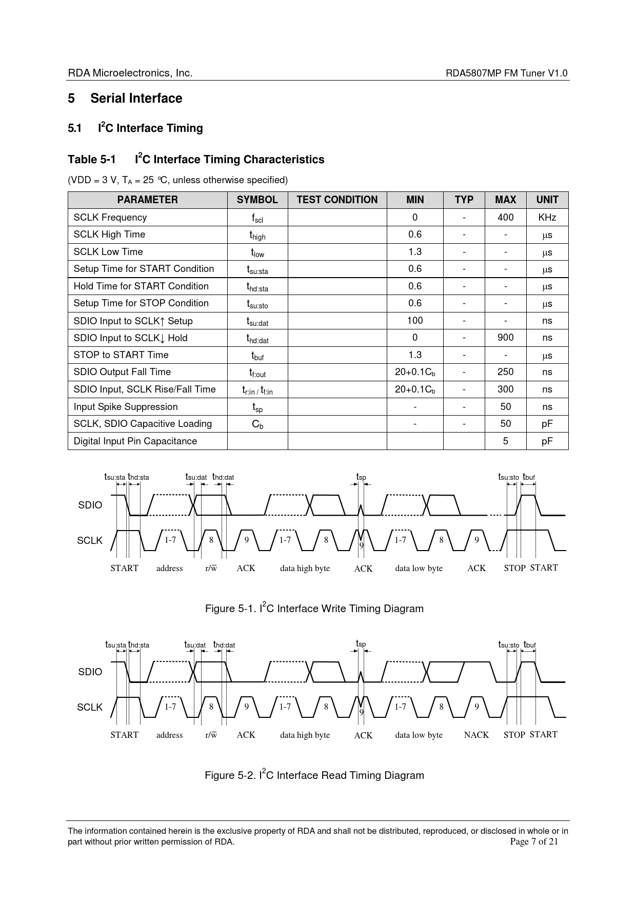

Serial Interface. 5.1. I2C Interface Timing. Table 5-1. I2C Interface Timing Characteristics. PARAMETER. SYMBOL. TEST CONDITION. MIN. TYP
RDA Microelectronics, Inc. RDA5807MP FM Tuner V1.0
5 Serial Interface 5.1 I2C Interface Timing Table 5-1 I2C Interface Timing Characteristics
(VDD = 3 V, TA = 25 °C, unless otherwise specified)
PARAMETER SYMBOL TEST CONDITION MIN TYP MAX UNIT
SCLK Frequency fscl 0 - 400 KHz SCLK High Time thigh 0.6 - - µs SCLK Low Time tlow 1.3 - - µs Setup Time for START Condition tsu:sta 0.6 - - µs Hold Time for START Condition thd:sta 0.6 - - µs Setup Time for STOP Condition tsu:sto 0.6 - - µs SDIO Input to SCLK↑ Setup tsu:dat 100 - - ns SDIO Input to SCLK↓ Hold thd:dat 0 - 900 ns STOP to START Time tbuf 1.3 - - µs SDIO Output Fall Time tf:out 20+0.1Cb - 250 ns SDIO Input, SCLK Rise/Fall Time tr:in / tf:in 20+0.1Cb - 300 ns Input Spike Suppression tsp - - 50 ns SCLK, SDIO Capacitive Loading Cb - - 50 pF Digital Input Pin Capacitance 5 pF tsu:sta thd:sta tsu:dat thd:dat tsp tsu:sto tbuf SDIO SCLK 1-7 8 9 1-7 8 1-7 8 9 9 START address r/w ACK data high byte ACK data low byte ACK STOP START Figure 5-1. I2C Interface Write Timing Diagram tsu:sta thd:sta tsu:dat thd:dat tsp tsu:sto tbuf SDIO SCLK 1-7 8 9 1-7 8 1-7 8 9 9 START address r/w ACK data high byte ACK data low byte NACK STOP START Figure 5-2. I2C Interface Read Timing Diagram The information contained herein is the exclusive property of RDA and shall not be distributed, reproduced, or disclosed in whole or in part without prior written permission of RDA. Page 7 of 21 Document Outline General Description Features Applications Table of Contents Functional Description FM Receiver Synthesizer Power Supply RESET and Control Interface select Control Interface Electrical Characteristics Receiver Characteristics Serial Interface I2C Interface Timing Register Definition Pins Description Application Diagram Audio Loading Resistance Larger than 32Ω & Reference Clock Application: Bill of Materials: Audio Loading Resistance Larger than 32Ω & DCXO Application: Bill of Materials: Physical Dimension PCB Land Pattern Change List Contact Information
