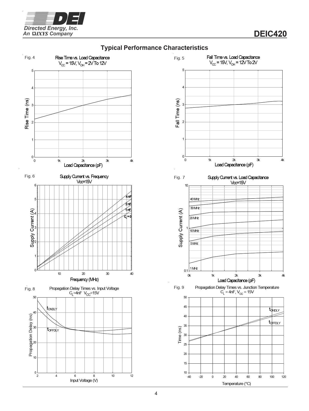

Pages / Page7 / 4 — DEIC420. Typical Performance Characteristics. 4 nF. 2 nF. 1 nF. C = 0
File Format / SizePDF / 262 Kb
DEIC420 Typical Performance Characteristics 4 nF 2 nF 1 nF C = 0
Fig. 4 Rise Time vs. Load Capacitance Fig. 5 Fal Time vs. Load Capacitance V = 15V, V = 2V To 12V V = 15V, V = 12V To 2V CC OH CC OH 5 5 4 4 s) s) 3 3 (n e e (n im T 2 2 ise Fall Tim R 1 1 0 0 0 1k 2k 3k 4k 0 1k 2k 3k 4k Load Capacitance (pF) Load Capacitance (pF) Fig. 6 Supply Current vs. Frequency Fig. 7 Supply Current vs. Load Capacitance Vcc=15V Vcc=15V 6 10
4 nF
5 40 MHz
2 nF
) 30 MHz A
1 nF
A 4
C = 0 L
