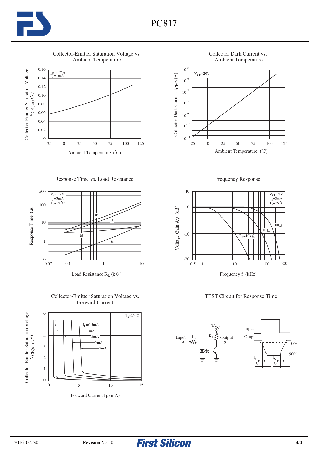

Collector-Emitter Saturation Voltage vs. Collector Dark Current vs. Ambient Temperature Ambient Temperature 0.16 10-5 IF=20mA VCE=20V 0.14 IC=1mA (A) 10-6 0.12 CEO 10-7 0.10 (V) 0.08 10-8 CE(sat) 0.06 V 10-9 0.04 10-10 0.02 Collector Dark Current I Collector-Emitter Saturation Voltage 0 10-11 -25 0 25 50 75 100 125 -25 0 25 50 75 100 125 Ambient Temperature ( C) Ambient Temperature ( C) Response Time vs. Load Resistance Frequency Response 500 40 VCE=2V VCE=2V IC=2mA IC=2mA 100 Ta=25 C T 0 a=25 C tr (dB) V 10 tf 100 1k -10 td RL=10k 1 Response Time (us) ts Voltage Gain A 0 -20 0.07 0.1 1 10 0.5 1 10 100 500 Load Resistance RL (k ) Frequency f (kHz) Collector-Emitter Saturation Voltage vs. TEST Circuit for Response Time Forward Current 6 Ta=25 C 5 IC=0.5mA VCC Input 1mA 4 3mA Input RD RL Output Output (V) 5mA 10% 3 7mA CE(sat) 90% V 2 td tS tr tf 1 0 Collector-Emitter Saturation Voltage 0 5 10 15 Forward Current IF (mA) 2016. 07. 30 Revision No : 0 4/4
