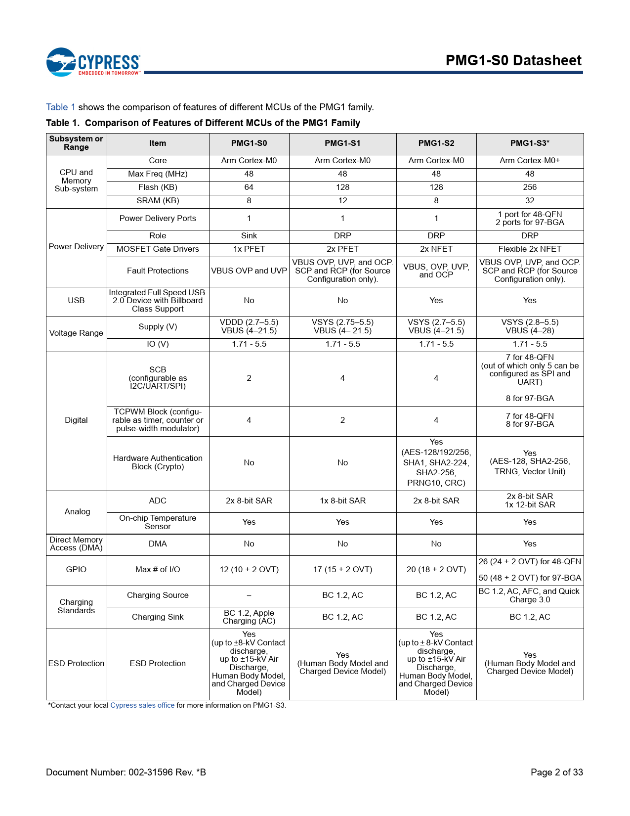

PMG1-S0 Datasheet
Table 1 shows the comparison of features of different MCUs of the PMG1 family.
Table 1. Comparison of Features of Different MCUs of the PMG1 Family Subsystem or Range Item PMG1-S0 PMG1-S1 PMG1-S2 PMG1-S3*
Core Arm Cortex-M0 Arm Cortex-M0 Arm Cortex-M0 Arm Cortex-M0+ CPU and Max Freq (MHz) 48 48 48 48 Memory Sub-system Flash (KB) 64 128 128 256 SRAM (KB) 8 12 8 32 Power Delivery Ports 1 1 1 1 port for 48-QFN 2 ports for 97-BGA Role Sink DRP DRP DRP Power Delivery MOSFET Gate Drivers 1x PFET 2x PFET 2x NFET Flexible 2x NFET VBUS OVP, UVP, and OCP. VBUS OVP, UVP, and OCP. Fault Protections VBUS OVP and UVP SCP and RCP (for Source VBUS, OVP, UVP, SCP and RCP (for Source Configuration only). and OCP Configuration only). Integrated Full Speed USB USB 2.0 Device with Billboard No No Yes Yes Class Support Supply (V) VDDD (2.7–5.5) VSYS (2.75–5.5) VSYS (2.7–5.5) VSYS (2.8–5.5) Voltage Range VBUS (4–21.5) VBUS (4– 21.5) VBUS (4–21.5) VBUS (4–28) IO (V) 1.71 - 5.5 1.71 - 5.5 1.71 - 5.5 1.71 - 5.5 7 for 48-QFN SCB (out of which only 5 can be (configurable as 2 4 4 configured as SPI and I2C/UART/SPI) UART) 8 for 97-BGA TCPWM Block (configu- Digital rable as timer, counter or 4 2 4 7 for 48-QFN pulse-width modulator) 8 for 97-BGA Yes (AES-128/192/256, Yes Hardware Authentication (AES-128, SHA2-256, Block (Crypto) No No SHA1, SHA2-224, SHA2-256, TRNG, Vector Unit) PRNG10, CRC) ADC 2x 8-bit SAR 1x 8-bit SAR 2x 8-bit SAR 2x 8-bit SAR 1x 12-bit SAR Analog On-chip Temperature Sensor Yes Yes Yes Yes Direct Memory Access (DMA) DMA No No No Yes 26 (24 + 2 OVT) for 48-QFN GPIO Max # of I/O 12 (10 + 2 OVT) 17 (15 + 2 OVT) 20 (18 + 2 OVT) 50 (48 + 2 OVT) for 97-BGA Charging Source  BC 1.2, AC BC 1.2, AC BC 1.2, AC, AFC, and Quick Charging Charge 3.0 Standards Charging Sink BC 1.2, Apple Charging (AC) BC 1.2, AC BC 1.2, AC BC 1.2, AC Yes Yes (up to ±8-kV Contact (up to ± 8-kV Contact discharge, Yes discharge, Yes ESD Protection ESD Protection up to ±15-kV Air up to ±15-kV Air Discharge, (Human Body Model and Discharge, (Human Body Model and Human Body Model, Charged Device Model) Human Body Model, Charged Device Model) and Charged Device and Charged Device Model) Model) *Contact your local Cypress sales office for more information on PMG1-S3. Document Number: 002-31596 Rev. *B Page 2 of 33 Document Outline PMG1-S0 Datasheet, Power Delivery Microcontroller Gen1 PMG1 Family General Description PMG1-S0 General Description Features Type-C Support and USB-PD Support Legacy/Proprietary Charging Block System-Level Fault Protection 32-bit MCU Subsystem Clocks and Oscillators Power System-Level ESD Protection Packages Block Diagram Contents Development Support Documentation Online Tools ModusToolbox™ IDE and PMG1 SDK Functional Overview MCU Subsystem CPU Flash SROM USB-PD Subsystem (SS) USB-PD Physical Layer ADC Charger Detection VBUS Undervoltage and Overvoltage Protection VBUS Short Protection PFET Gate Drivers on VBUS Path VBUS Discharge FETs Integrated Digital Blocks Serial Communication Blocks (SCB) Timer/Counter/PWM Block (TCPWM) I/O Subsystem Power Systems Overview Pinouts Application Diagram Electrical Specifications Absolute Maximum Ratings Device-Level Specifications I/O Digital Peripherals Pulse Width Modulation (PWM) for GPIO Pins I2C System Resources Power-on-Reset (POR) with Brown Out SWD Interface Internal Main Oscillator Internal Low-Speed Oscillator Power Down Gate Driver Specifications Analog to Digital Converter Memory Ordering Information Ordering Code Definitions Packaging Acronyms Document Conventions Units of Measure Document History Page Sales, Solutions, and Legal Information Worldwide Sales and Design Support Products PSoC® Solutions Cypress Developer Community Technical Support
