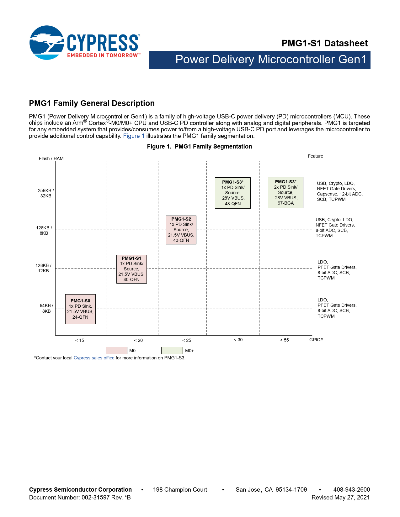

PMG1 (Power Delivery Microcontroller Gen1) is a family of high-voltage USB-C power delivery (PD) microcontrollers (MCU). These chips include an Arm® Cortex®-M0/M0+ CPU and USB-C PD controller along with analog and digital peripherals. PMG1 is targeted for any embedded system that provides/consumes power to/from a high-voltage USB-C PD port and leverages the microcontroller to provide additional control capability. Figure 1 illustrates the PMG1 family segmentation.
Figure 1. PMG1 Family Segmentation
Flash / RAM Feature
PMG1-S3* PMG1-S3*
USB, Crypto, LDO, 1x PD Sink/ 2x PD Sink/ 256KB / NFET Gate Drivers, Source, Source, 32KB Capsense, 12-bit ADC, 28V VBUS, 28V VBUS, SCB, TCPWM 48-QFN 97-BGA
PMG1-S2
USB, Crypto, LDO, 1x PD Sink/ NFET Gate Drivers, 128KB / Source, 8-bit ADC, SCB, 8KB 21.5V VBUS, TCPWM 40-QFN
PMG1-S1
1x PD Sink/ LDO, 128KB / Source, PFET Gate Drivers, 12KB 21.5V VBUS, 8-bit ADC, SCB, 40-QFN TCPWM
PMG1-S0
LDO, 64KB / 1x PD Sink, PFET Gate Drivers, 8KB 21.5V VBUS, 8-bit ADC, SCB, 24-QFN TCPWM < 15 < 20 < 25 < 30 < 55 GPIO# M0 M0+ *Contact your local Cypress sales office for more information on PMG1-S3.
