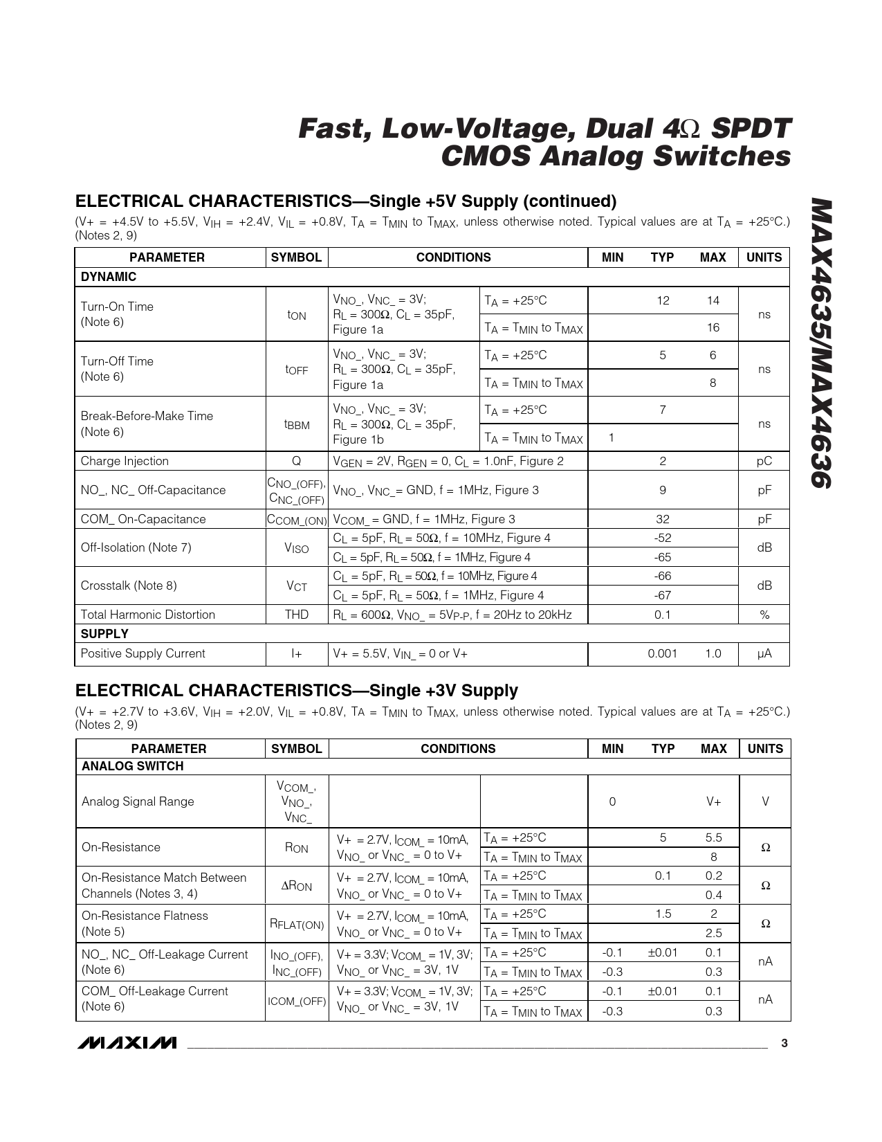

SPDT CMOS Analog Switches MAX4635/MAX4636 ELECTRICAL CHARACTERISTICS—Single +5V Supply (continued)
(V+ = +4.5V to +5.5V, VIH = +2.4V, VIL = +0.8V, TA = TMIN to TMAX, unless otherwise noted. Typical values are at TA = +25°C.) (Notes 2, 9)
PARAMETER SYMBOL CONDITIONS MIN TYP MAX UNITS DYNAMIC
VNO_, VNC_ = 3V; TA = +25°C 12 14 Turn-On Time tON RL = 300Ω, CL = 35pF, ns (Note 6) Figure 1a TA = TMIN to TMAX 16 VNO_, VNC_ = 3V; TA = +25°C 5 6 Turn-Off Time tOFF RL = 300Ω, CL = 35pF, ns (Note 6) Figure 1a TA = TMIN to TMAX 8 VNO_, VNC_ = 3V; TA = +25°C 7 Break-Before-Make Time tBBM RL = 300Ω, CL = 35pF, ns (Note 6) Figure 1b TA = TMIN to TMAX 1 Charge Injection Q VGEN = 2V, RGEN = 0, CL = 1.0nF, Figure 2 2 pC CNO_(OFF), NO_, NC_ Off-Capacitance VNO_, VNC_= GND, f = 1MHz, Figure 3 9 pF CNC_(OFF) COM_ On-Capacitance CCOM_(ON) VCOM_ = GND, f = 1MHz, Figure 3 32 pF CL = 5pF, RL = 50Ω, f = 10MHz, Figure 4 -52 Off-Isolation (Note 7) VISO dB C L = 5p F, RL= 50Ω, f = 1M H z, Fi g ur e 4 -65 CL = 5pF, RL = 50Ω, f = 10M H z, Fig ur e 4 -66 Crosstalk (Note 8) VCT dB CL = 5pF, RL = 50Ω, f = 1MHz, Figure 4 -67 Total Harmonic Distortion THD RL = 600Ω, VNO_ = 5VP-P, f = 20Hz to 20kHz 0.1 %
SUPPLY
Positive Supply Current I+ V+ = 5.5V, VIN_ = 0 or V+ 0.001 1.0 µA
ELECTRICAL CHARACTERISTICS—Single +3V Supply
(V+ = +2.7V to +3.6V, VIH = +2.0V, VIL = +0.8V, TA = TMIN to TMAX, unless otherwise noted. Typical values are at TA = +25°C.) (Notes 2, 9)
PARAMETER SYMBOL CONDITIONS MIN TYP MAX UNITS ANALOG SWITCH
VCOM_, Analog Signal Range VNO_, 0 V+ V VNC_ V + = 2.7V , I TA = +25°C 5 5.5 On-Resistance R C OM_ = 10m A, ON Ω VNO_ or VNC_ = 0 to V+ TA = TMIN to TMAX 8 On-Resistance Match Between V + = 2.7V , I TA = +25°C 0.1 0.2 ∆R C OM_ = 10m A, ON Ω Channels (Notes 3, 4) VNO_ or VNC_ = 0 to V+ TA = TMIN to TMAX 0.4 On-Resistance Flatness V + = 2.7V , I TA = +25°C 1.5 2 R C OM_ = 10m A, FLAT(ON) Ω (Note 5) VNO_ or VNC_ = 0 to V+ TA = TMIN to TMAX 2.5 NO_, NC_ Off-Leakage Current I V + = 3.3V ; V TA = +25°C -0.1 NO_(OFF), C OM_ = 1V , 3V ; ±0.01 0.1 nA (Note 6) INC_(OFF) VNO_ or VNC_ = 3V, 1V TA = TMIN to TMAX -0.3 0.3 COM_ Off-Leakage Current V + = 3.3V ; V C OM_ = 1V , 3V ; TA = +25°C -0.1 ±0.01 0.1 nA (Note 6) ICOM_(OFF) VNO_ or VNC_ = 3V, 1V TA = TMIN to TMAX -0.3 0.3
