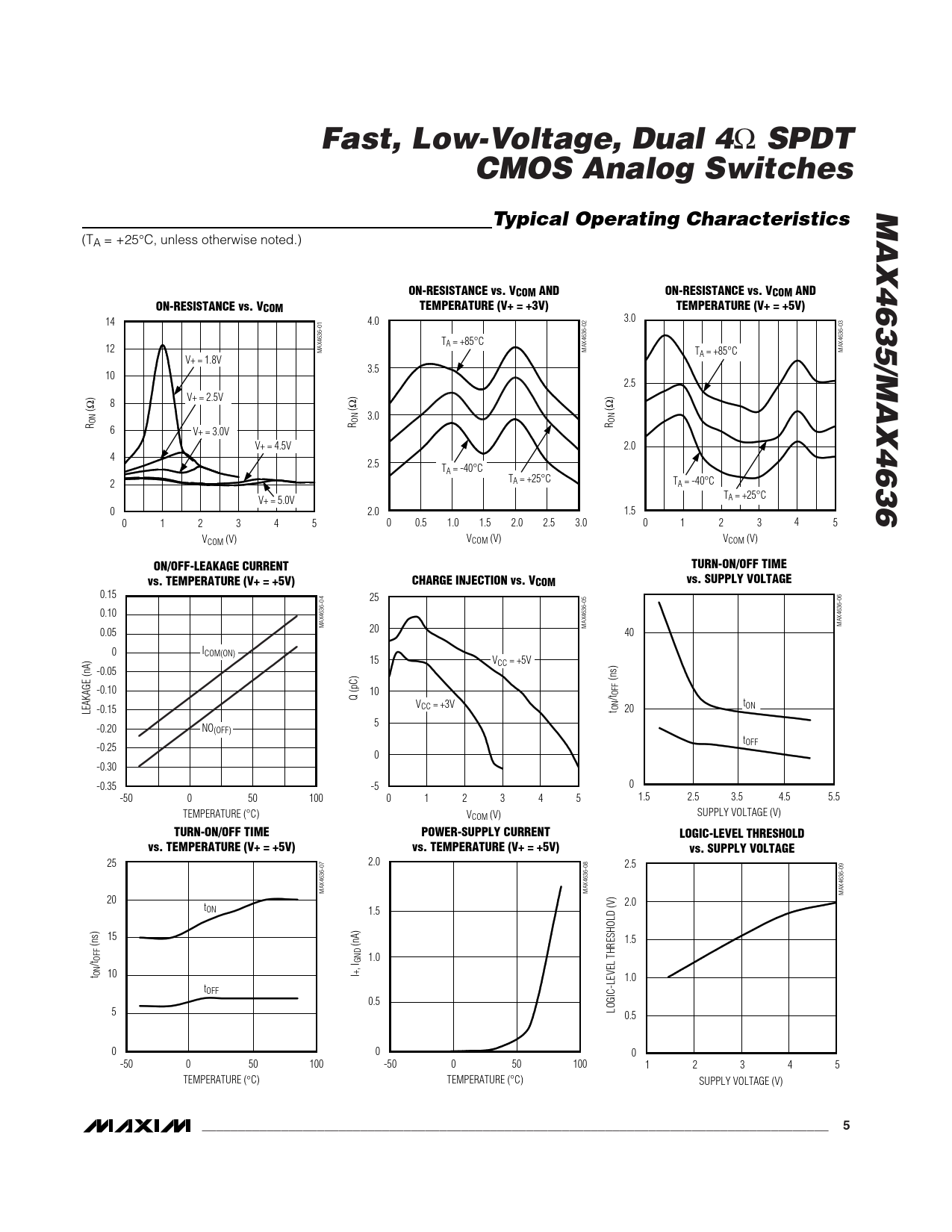

Fast, Low-Voltage, Dual 4. SPDT. CMOS Analog Switches. MAX4635/MAX4636. Typical Operating Characteristics
Fast, Low-Voltage, Dual 4 SPDT CMOS Analog Switches MAX4635/MAX4636 Typical Operating Characteristics
(TA = +25°C, unless otherwise noted.)
ON-RESISTANCE vs. VCOM AND ON-RESISTANCE vs. VCOM AND ON-RESISTANCE vs. VCOM TEMPERATURE (V+ = +3V) TEMPERATURE (V+ = +5V)
14 4.0 3.0 TA = +85°C 12 MAX4636-01 MAX4636-02 MAX4636-03 TA = +85°C V+ = 1.8V 3.5 10 2.5 ) V+ = 2.5V ) 8 Ω Ω Ω ( 3.0 R ON R ON R ON 6 V+ = 3.0V V+ = 4.5V 2.0 4 2.5 TA = -40°C T 2 A = +25°C TA = -40°C T V+ = 5.0V A = +25°C 0 2.0 1.5 0 1 2 3 4 5 0 0.5 1.0 1.5 2.0 2.5 3.0 0 1 2 3 4 5 VCOM (V) VCOM (V) VCOM (V)
ON/OFF-LEAKAGE CURRENT TURN-ON/OFF TIME vs. TEMPERATURE (V+ = +5V) CHARGE INJECTION vs. VCOM vs. SUPPLY VOLTAGE
0.15 25 0.10 MAX4636-04 MAX4636-05 MAX4636-06 0.05 20 40 0 ICOM(ON) 15 VCC = +5V -0.05 (ns) -0.10 10 Q (pC) /t OFF VCC = +3V tON LEAKAGE (nA) -0.15 t ON 20 5 -0.20 NO(OFF) tOFF -0.25 0 -0.30 -0.35 -5 0 -50 0 50 100 0 1 2 3 4 5 1.5 2.5 3.5 4.5 5.5 TEMPERATURE (°C) V SUPPLY VOLTAGE (V) COM (V)
TURN-ON/OFF TIME POWER-SUPPLY CURRENT LOGIC-LEVEL THRESHOLD vs. TEMPERATURE (V+ = +5V) vs. TEMPERATURE (V+ = +5V) vs. SUPPLY VOLTAGE
25 2.0 2.5 MAX4636-07 MAX4636-08 MAX4636-09 20 2.0 tON 1.5 15 1.5 (ns) (nA) GND 1.0 /t OFF t ON 10 I+, I 1.0 tOFF 0.5 5 LOGIC-LEVEL THRESHOLD (V) 0.5 0 0 0 -50 0 50 100 -50 0 50 100 1 2 3 4 5 TEMPERATURE (°C) TEMPERATURE (°C) SUPPLY VOLTAGE (V)
