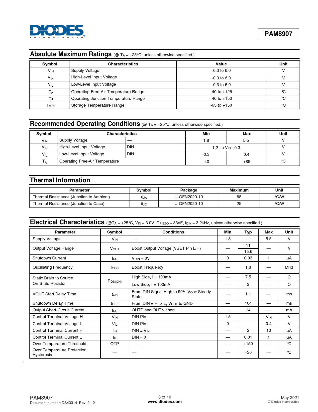

PAM8907. Absolute Maximum Ratings. Symbol. Characteristics. Value. Unit. Recommended Operating Conditions. Min. Max. O F. D E. C N
PAM8907 Absolute Maximum Ratings Symbol Characteristics Value Unit Recommended Operating Conditions Min Max O F D E C N
(@ TA = +25°C, unless otherwise specified.)
VIN Supply Voltage -0.3 to 6.0 V VIH High-Level Input Voltage -0.3 to 6.0 V VIL Low-Level Input Voltage -0.3 to 6.0 V TA Operating Free-Air Temperature Range -40 to +125 °C T
J Operating Junction Temperature Range -40 to +150 °C
N
TSTG Storage Temperature Range -65 to +150 °C
IO T Recommended Operating Conditions A
M Symbol Characteristics Min Max Unit R
VIN Supply Voltage — 1.8 5.5 V
O F
VIH High-Level Input Voltage DIN 1.2 to VIN+ 0.3 V VIL Low-Level Input Voltage DIN -0.3 0.4 V
IN
TA Operating Free-Air Temperature -40 +85 °C
D E C N Thermal Information A V Parameter Symbol Package Maximum Unit D
Thermal Resistance (Junction to Ambient) JA U-QFN2020-10 68 °C/W
A
Thermal Resistance (Junction to Case) JC U-QFN2020-10 25 °C/W
Electrical Characteristics
(@TA = +25°C, VIN = 3.0V, CPIEZO = 33nF, fDIN = 3.2kHz, unless otherwise specified.)
Parameter Symbol Conditions Min Typ Max Unit
Supply Voltage VIN — 1.8 — 5.5 V 11 Output Voltage Range VOUT
Boost Output Voltage (VSET Pin L/H)
V
15.6 Shutdown Current ISD VDIN = 0V 0 0.03 1 µA Oscillating Frequency fOSC Boost Frequency — 1.8 — MHz Static Drain to Source High Side, I = 100mA — 7.5 — Ω R On-State Resistor DS(ON) Low Side, I = 100mA — 3 — Ω From DIN Signal High to 90% V VOUT Start Delay Time t OUT Steady ON — 1.1 — ms State Shutdown Delay Time tOFF From DIN = H- > L, VOUT to GND — 104 — ms Output Short-Circuit Current ISC OUTP and OUTN short — 14 — mA Control Terminal Voltage H VIH DIN Pin 1.5 — VIN V Control Terminal Voltage L VIL DIN Pin 0 — 0.4 V Control Terminal Current H IIH DIN = VIN — 2 10 µA Control Terminal Current L IIL DIN = 0 — 0.01 1 µA Over Temperature Threshold OTP — — +150 — °C Over Temperature Protection — — — +30 — °C Hysteresis . PAM8907 3 of 10 May 2021 Document number: DS43314 Rev. 2 - 2
