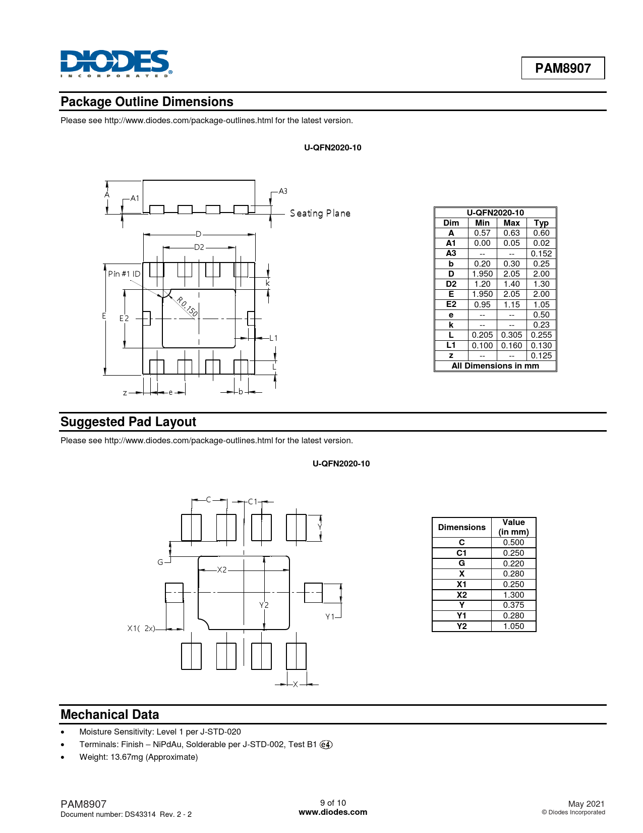

PAM8907 Package Outline Dimensions
Please see http://www.diodes.com/package-outlines.html for the latest version.
U-QFN2020-10
A A3 A1
S eating Plane
N U-QFN2020-10 Dim Min Max Typ IO
D
A
0.57 0.63 0.60
T
D2
A1
0.00 0.05 0.02
A A3
-- -- 0.152
b
0.20 0.30 0.25
M
Pin #1 ID
D
1.950 2.05 2.00
R
k
D2
1.20 1.40 1.30
O E
1.950 2.05 2.00
F
R0.15
E2
0.95 1.15 1.05 0 E E 2
e
-- -- 0.50
IN k
-- -- 0.23
D
L1
L
0.205 0.305 0.255
E L1
0.100 0.160 0.130
C z
-- -- 0.125
N
L
All Dimensions in mm A V
z e b
D A Suggested Pad Layout
U-QFN2020-10
C C1
Y
Value Dimensions (in mm) C
0.500
C1
0.250 G
G
0.220 X2
X
0.280
X1
0.250
X2
1.300 Y2
Y
0.375 Y1
Y1
0.280 X1( 2x)
Y2
1.050 X
