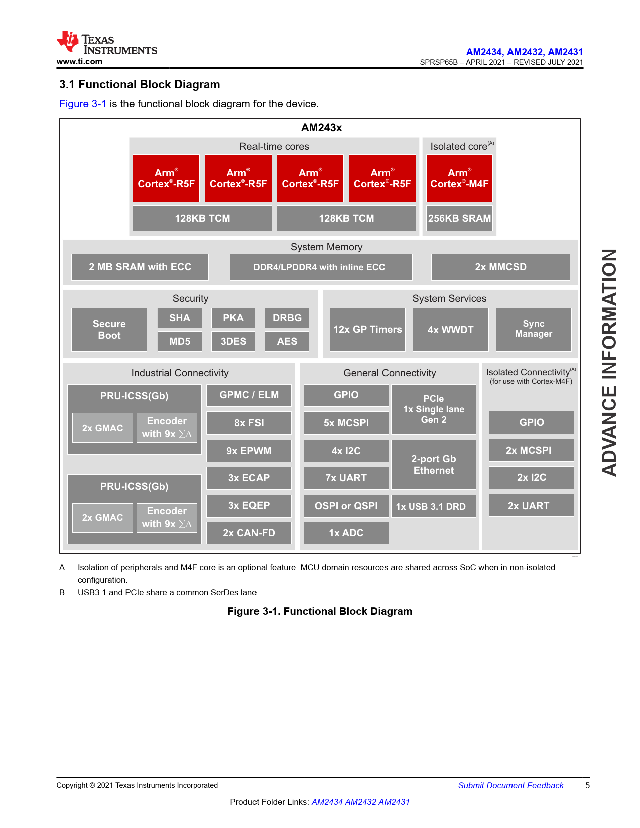

3.1 Functional Block Diagram
Figure 3-1 is the functional block diagram for the device.
A 243x M
Real-time cores Isolated core(A)
Arm® Arm® Arm® Arm® Arm® Cortex -R5F ® Cortex -R5F ® Cortex -R5F ® Cortex -R5F ® ® Cortex -M4F 128KB TCM 128KB TCM 256KB SRAM
System Memory
2 MB SRAM with ECC DDR4/LPDDR4 with inline ECC 2x MMCSD TION
Security System Services
SHA PKA DRBG MA Secure Sync 12x GP Timers 4x WWDT R Boot Manager MD5 3DES AES
Industrial Connectivity General Connectivity Isolated Connectivity(A) (for use with Cortex-M4F)
PRU-ICSS(Gb) GPMC / ELM GPIO PCIe 1x Single lane Encoder NCE INFO 8x FSI 5x MCSPI Gen 2 GPIO 2x GMAC with 9x
A V 9x EPWM 4x I2C 2x MCSPI 2-port Gb Ethernet AD 3x ECAP 7x UART 2x I2C PRU-ICSS(Gb) 3x EQEP OSPI or QSPI 2x UART Encoder 1x USB 3.1 DRD 2x GMAC with 9x
2x CAN-FD 1x ADC
intro_001 A. Isolation of peripherals and M4F core is an optional feature. MCU domain resources are shared across SoC when in non-isolated configuration. B. USB3.1 and PCIe share a common SerDes lane.
Figure 3-1. Functional Block Diagram
