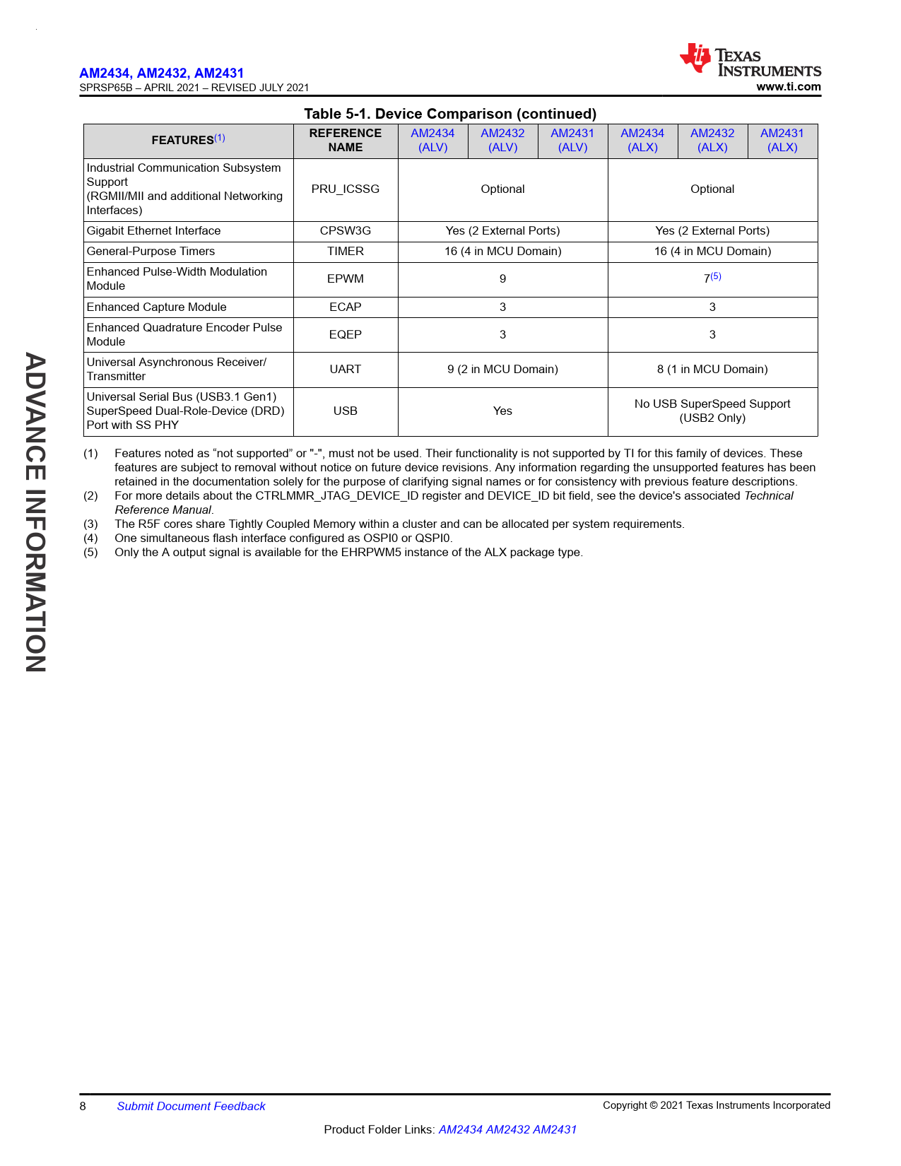

Pages / Page316 / 8 — AM2434. , AM2432, AM2431. www.ti.com. Table 5-1. Device Comparison …
File Format / SizePDF / 6.4 Mb
AM2434. , AM2432, AM2431. www.ti.com. Table 5-1. Device Comparison (continued). FEATURES. REFERENCE. NAME. NCE INFO. MA TION
AM2434 , AM2432, AM2431 www.ti.com Table 5-1 Device Comparison (continued) FEATURES REFERENCE NAME NCE INFO MA TION
link to page 8 link to page 8
SPRSP65B – APRIL 2021 – REVISED JULY 2021
www.ti.com Table 5-1. Device Comparison (continued)
AM2434 AM2432 AM2431 AM2434 AM2432 AM2431
FEATURES
(1)
REFERENCE NAME
(ALV) (ALV) (ALV) (ALX) (ALX) (ALX) Industrial Communication Subsystem Support PRU_ICSSG Optional Optional (RGMII/MII and additional Networking Interfaces) Gigabit Ethernet Interface CPSW3G Yes (2 External Ports) Yes (2 External Ports) General-Purpose Timers TIMER 16 (4 in MCU Domain) 16 (4 in MCU Domain) Enhanced Pulse-Width Modulation EPWM 9 7(5) Module Enhanced Capture Module ECAP 3 3 Enhanced Quadrature Encoder Pulse EQEP 3 3 Module
AD
Universal Asynchronous Receiver/ UART 9 (2 in MCU Domain) 8 (1 in MCU Domain) Transmitter
V
Universal Serial Bus (USB3.1 Gen1)
A
No USB SuperSpeed Support SuperSpeed Dual-Role-Device (DRD) USB Yes (USB2 Only)
NCE INFO
Port with SS PHY (1) Features noted as “not supported” or "-", must not be used. Their functionality is not supported by TI for this family of devices. These features are subject to removal without notice on future device revisions. Any information regarding the unsupported features has been retained in the documentation solely for the purpose of clarifying signal names or for consistency with previous feature descriptions. (2) For more details about the CTRLMMR_JTAG_DEVICE_ID register and DEVICE_ID bit field, see the device's associated Technical Reference Manual. (3) The R5F cores share Tightly Coupled Memory within a cluster and can be allocated per system requirements. (4) One simultaneous flash interface configured as OSPI0 or QSPI0.
R
(5) Only the A output signal is available for the EHRPWM5 instance of the ALX package type.
