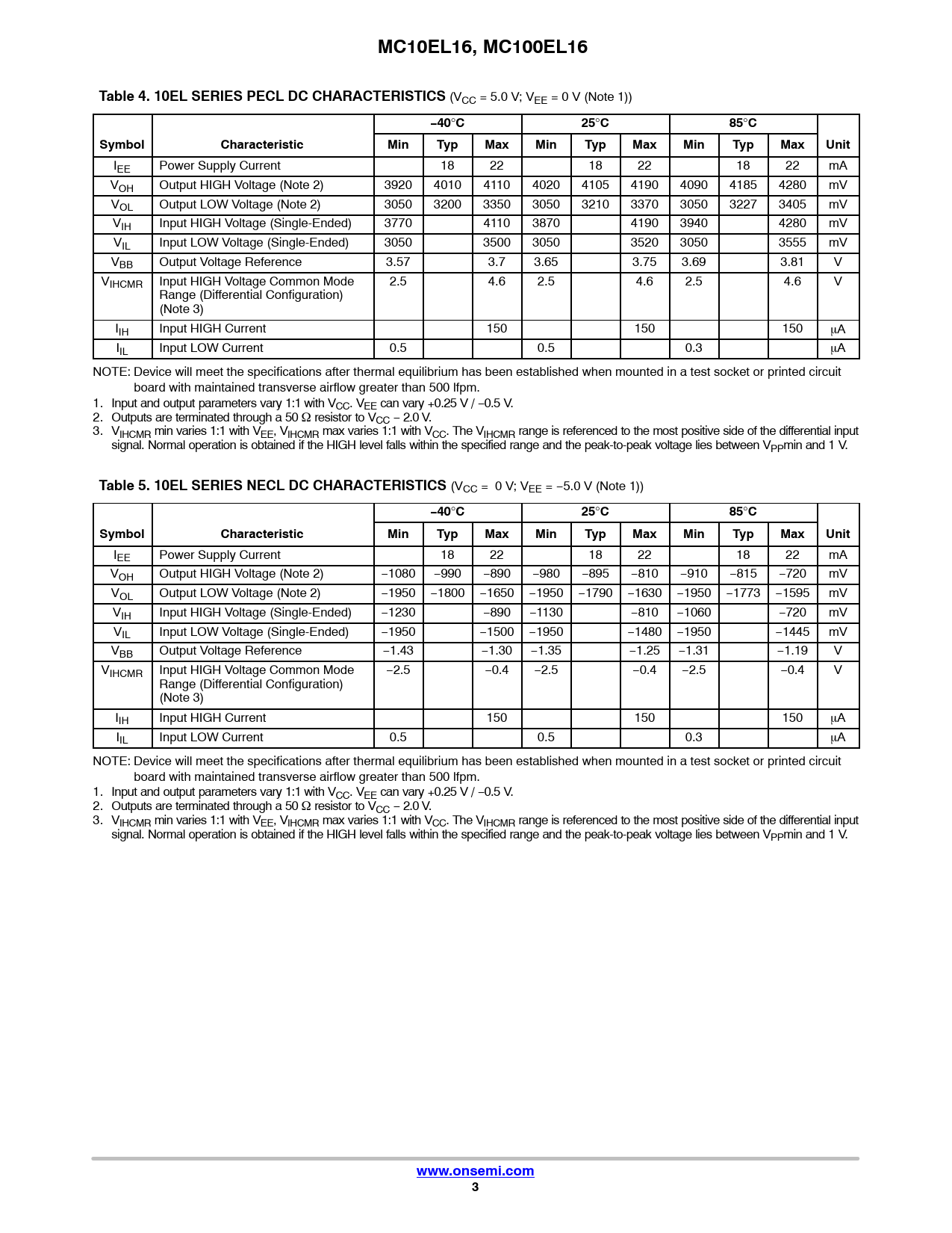

MC10EL16, MC100EL16 Table 4. 10EL SERIES PECL DC CHARACTERISTICS
(VCC = 5.0 V; VEE = 0 V
(Note 1))
−40
C 25
C 85
C Symbol Characteristic Min Typ Max Min Typ Max Min Typ Max Unit
IEE Power Supply Current 18 22 18 22 18 22 mA VOH Output HIGH Voltage (Note 2) 3920 4010 4110 4020 4105 4190 4090 4185 4280 mV VOL Output LOW Voltage (Note 2) 3050 3200 3350 3050 3210 3370 3050 3227 3405 mV VIH Input HIGH Voltage (Single-Ended) 3770 4110 3870 4190 3940 4280 mV VIL Input LOW Voltage (Single-Ended) 3050 3500 3050 3520 3050 3555 mV VBB Output Voltage Reference 3.57 3.7 3.65 3.75 3.69 3.81 V VIHCMR Input HIGH Voltage Common Mode 2.5 4.6 2.5 4.6 2.5 4.6 V Range (Differential Configuration) (Note 3) IIH Input HIGH Current 150 150 150 mA IIL Input LOW Current 0.5 0.5 0.3 mA NOTE: Device will meet the specifications after thermal equilibrium has been established when mounted in a test socket or printed circuit board with maintained transverse airflow greater than 500 lfpm. 1. Input and output parameters vary 1:1 with VCC. VEE can vary +0.25 V / −0.5 V. 2. Outputs are terminated through a 50 W resistor to VCC − 2.0 V. 3. VIHCMR min varies 1:1 with VEE, VIHCMR max varies 1:1 with VCC. The VIHCMR range is referenced to the most positive side of the dif erential input signal. Normal operation is obtained if the HIGH level falls within the specified range and the peak-to-peak voltage lies between VPPmin and 1 V.
Table 5. 10EL SERIES NECL DC CHARACTERISTICS
(VCC = 0 V; VEE = −5.0 V (Note 1))
−40
C 25
C 85
IEE Power Supply Current 18 22 18 22 18 22 mA VOH Output HIGH Voltage (Note 2) −1080 −990 −890 −980 −895 −810 −910 −815 −720 mV VOL Output LOW Voltage (Note 2) −1950 −1800 −1650 −1950 −1790 −1630 −1950 −1773 −1595 mV VIH Input HIGH Voltage (Single-Ended) −1230 −890 −1130 −810 −1060 −720 mV VIL Input LOW Voltage (Single-Ended) −1950 −1500 −1950 −1480 −1950 −1445 mV VBB Output Voltage Reference −1.43 −1.30 −1.35 −1.25 −1.31 −1.19 V VIHCMR Input HIGH Voltage Common Mode −2.5 −0.4 −2.5 −0.4 −2.5 −0.4 V Range (Differential Configuration) (Note 3) IIH Input HIGH Current 150 150 150 mA IIL Input LOW Current 0.5 0.5 0.3 mA NOTE: Device will meet the specifications after thermal equilibrium has been established when mounted in a test socket or printed circuit board with maintained transverse airflow greater than 500 lfpm. 1. Input and output parameters vary 1:1 with VCC. VEE can vary +0.25 V / −0.5 V. 2. Outputs are terminated through a 50 W resistor to VCC − 2.0 V. 3. VIHCMR min varies 1:1 with VEE, VIHCMR max varies 1:1 with VCC. The VIHCMR range is referenced to the most positive side of the dif erential input signal. Normal operation is obtained if the HIGH level falls within the specified range and the peak-to-peak voltage lies between VPPmin and 1 V.
