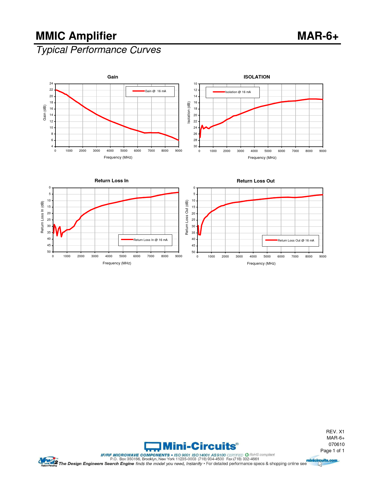

Typical Performance Curves
Gain ISOLATION
24 10 22 Gain @ 16 mA 12 Isolation @ 16 mA 20 14 18 ) 16 ) B B 16 (d 18 (d n in 14 tio a 20 la G o 12 22 Is 10 24 8 26 6 28 4 30 0 1000 2000 3000 4000 5000 6000 7000 8000 9000 0 1000 2000 3000 4000 5000 6000 7000 8000 9000 Frequency (MHz) Frequency (MHz)
Return Loss In Return Loss Out
0 0 5 5 10 ) 10 B B 15 15 (d t (d u In 20 s O 20 s s o s 25 o 25 L L rn 30 rn 30 tu e tu e R 35 35 R 40 40 Return Loss In @ 16 mA Return Loss Out @ 16 mA 45 45 50 50 0 1000 2000 3000 4000 5000 6000 7000 8000 9000 0 1000 2000 3000 4000 5000 6000 7000 8000 9000 Frequency (MHz) Frequency (MHz) REV. X1 MAR-6+ 070610 Page 1 of 1 Document Outline MAR-6+ Data Sheet View Data View Graphs Case Style Tape and Reel PCB Layout Eval Board Enviromental Ratings
