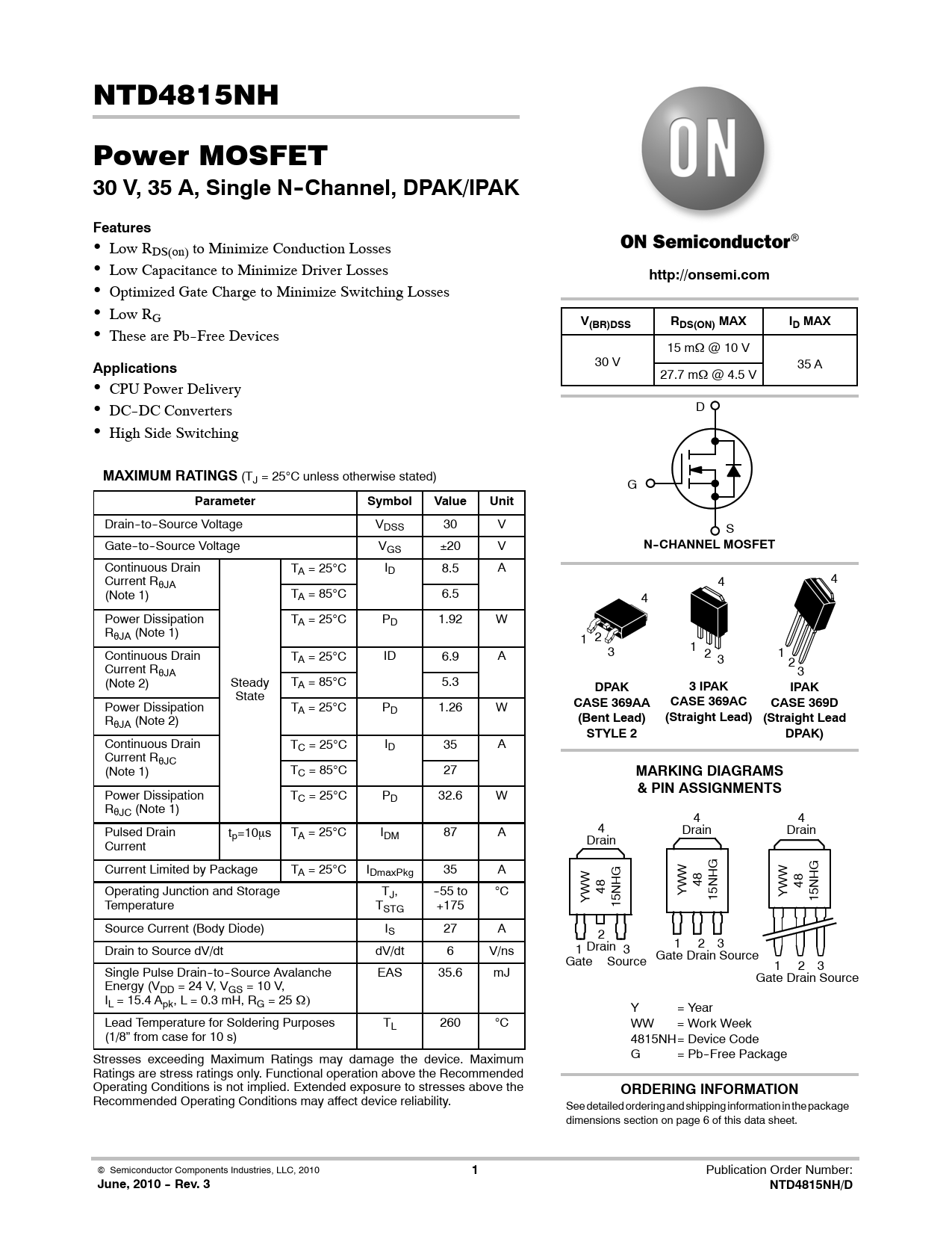

30 V, 35 A, Single N- Channel, DPAK/IPAK. Features. http://onsemi.com. V(BR)DSS. RDS(ON) MAX. ID MAX. Applications. MAXIMUM RATINGS
30 V, 35 A, Single N- Channel, DPAK/IPAK Features http://onsemi.com V(BR)DSS RDS(ON) MAX ID MAX Applications MAXIMUM RATINGS
NTD4815NH Power MOSFET
• Low RDS(on) to Minimize Conduction Losses • Low Capacitance to Minimize Driver Losses
http://onsemi.com
• Optimized Gate Charge to Minimize Switching Losses • Low RG
• These are Pb- Free Devices 15 mΩ @ 10 V
Applications
30 V 35 A 27.7 mΩ @ 4.5 V • CPU Power Delivery • DC- DC Converters D • High Side Switching
MAXIMUM RATINGS
(TJ = 25°C unless otherwise stated) G
Parameter Symbol Value Unit
Drain- to- Source Voltage VDSS 30 V S Gate- to- Source Voltage VGS ±20 V
N- CHANNEL MOSFET
Continuous Drain TA = 25°C ID 8.5 A Current R 4 θJA 4 (Note 1) TA = 85°C 6.5 4 Power Dissipation TA = 25°C PD 1.92 W RθJA (Note 1) 1 2 1 Continuous Drain T 3 1 A = 25°C ID 6.9 A 2 3 Current R 2 θJA 3 (Note 2) Steady TA = 85°C 5.3
DPAK 3 IPAK IPAK
State Power Dissipation T
CASE 369AA CASE 369AC CASE 369D
A = 25°C PD 1.26 W R
(Bent Lead) (Straight Lead) (Straight Lead
θJA (Note 2)
STYLE 2 DPAK)
Continuous Drain TC = 25°C ID 35 A Current RθJC (Note 1) TC = 85°C 27
MARKING DIAGRAMS
Power Dissipation T
& PIN ASSIGNMENTS
C = 25°C PD 32.6 W RθJC (Note 1) 4 4 Pulsed Drain t 4 Drain Drain p=10ms TA = 25°C IDM 87 A Current Drain Current Limited by Package TA = 25°C IDmaxPkg 35 A 48 48 Operating Junction and Storage TJ, - 55 to °C 48 YWW YWW 15NHG YWW 15NHG Temperature TSTG +175 15NHG Source Current (Body Diode) IS 27 A 2 Drain to Source dV/dt dV/dt 6 V/ns 1 Drain 3 1 2 3 Gate Source Gate Drain Source Single Pulse Drain- to- Source Avalanche EAS 35.6 mJ 1 2 3 Gate Drain Source Energy (VDD = 24 V, VGS = 10 V, IL = 15.4 Apk, L = 0.3 mH, RG = 25 Ω) Y = Year Lead Temperature for Soldering Purposes TL 260 °C WW = Work Week (1/8” from case for 10 s) 4815NH= Device Code Stresses exceeding Maximum Ratings may damage the device. Maximum G = Pb- Free Package Ratings are stress ratings only. Functional operation above the Recommended Operating Conditions is not implied. Extended exposure to stresses above the
