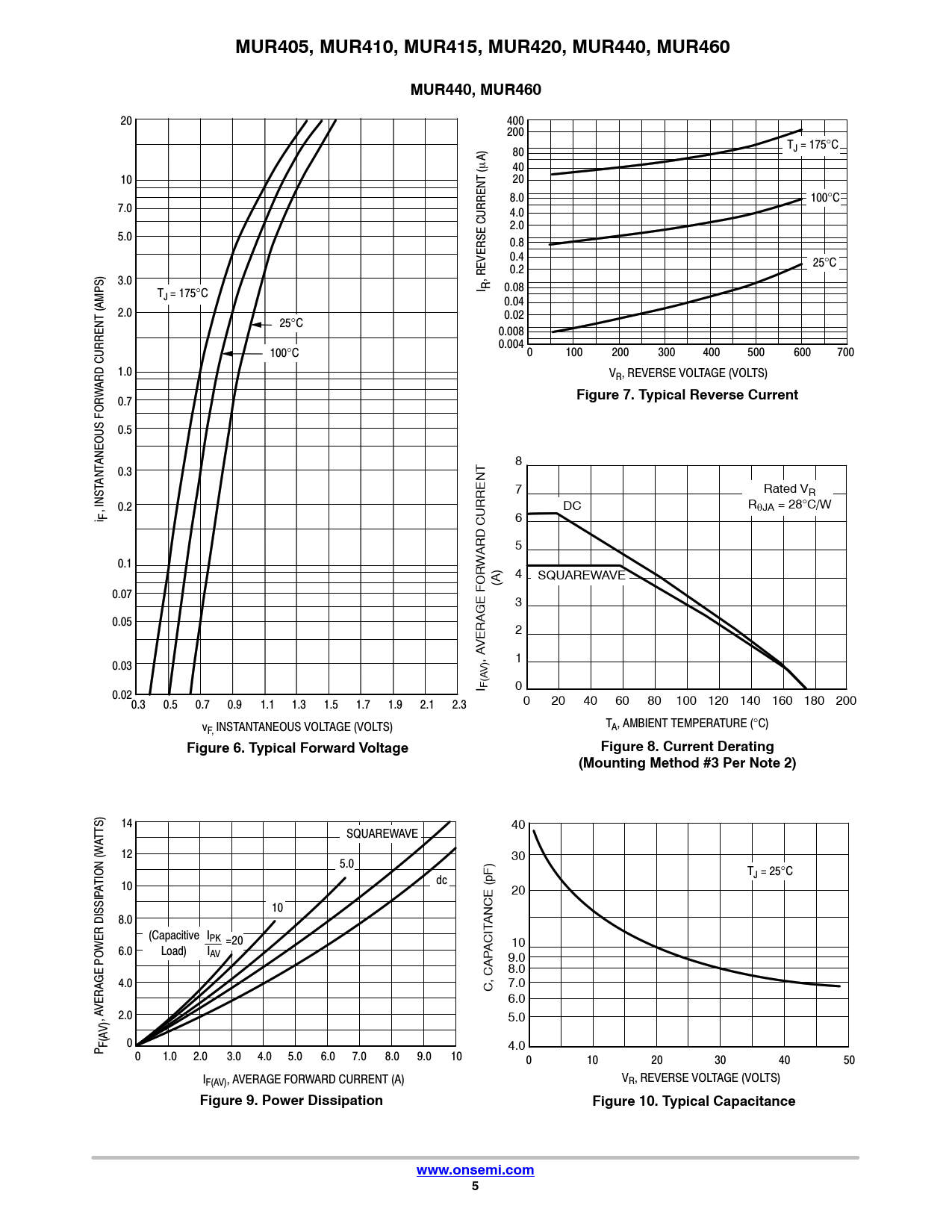

MUR405, MUR410, MUR415, MUR420, MUR440, MUR460. MUR440, MUR460. Figure 7. Typical Reverse Current
MUR405, MUR410, MUR415, MUR420, MUR440, MUR460 MUR440, MUR460 Figure 7 Typical Reverse Current
link to page 7
20 400 200 T 80 J = 175°C A) m 40 ( 10 20 8.0 100°C 7.0 4.0 2.0 5.0 0.8 0.4 25°C 0.2 3.0 , REVERSE CURRENT I R 0.08 TJ = 175°C 0.04 (AMPS) 2.0 0.02 25°C 0.008 0.004 100°C 0 100 200 300 400 500 600 700 1.0 VR, REVERSE VOLTAGE (VOLTS) ARD CURRENT W
0.7 0.5 ANEOUS FOR 8 0.3 ANT 7 Rated VR , INST 0.2 DC RqJA = 28°C/W Fi 6 5 ARD CURRENT 0.1 W 4 SQUAREWAVE (A) 0.07 3 0.05 2 VERAGE FOR , A 1 0.03 ) V I F(A 0 0.020.3 0.5 0.7 0.9 1.1 1.3 1.5 1.7 1.9 2.1 2.3 0 20 40 60 80 100 120 140 160 180 200 v T F, INSTANTANEOUS VOLTAGE (VOLTS) A, AMBIENT TEMPERATURE (°C)
Figure 6. Typical Forward Voltage Figure 8. Current Derating (Mounting Method #3 Per Note 2)
14 40 TTS) SQUAREWAVE A 12 30 5.0 TJ = 25°C TION (W dc A 10 20 10 8.0 ANCE (pF) (Capacitive IPK =20 10 6.0 Load) I ACIT AV 9.0 8.0 4.0 C, CAP 7.0 6.0 VERAGE POWER DISSIP 2.0 , A 5.0 V) F(A 0 P 4.0 0 1.0 2.0 3.0 4.0 5.0 6.0 7.0 8.0 9.0 10 0 10 20 30 40 50 IF(AV), AVERAGE FORWARD CURRENT (A) VR, REVERSE VOLTAGE (VOLTS)
Figure 9. Power Dissipation Figure 10. Typical Capacitance www.onsemi.com 5
