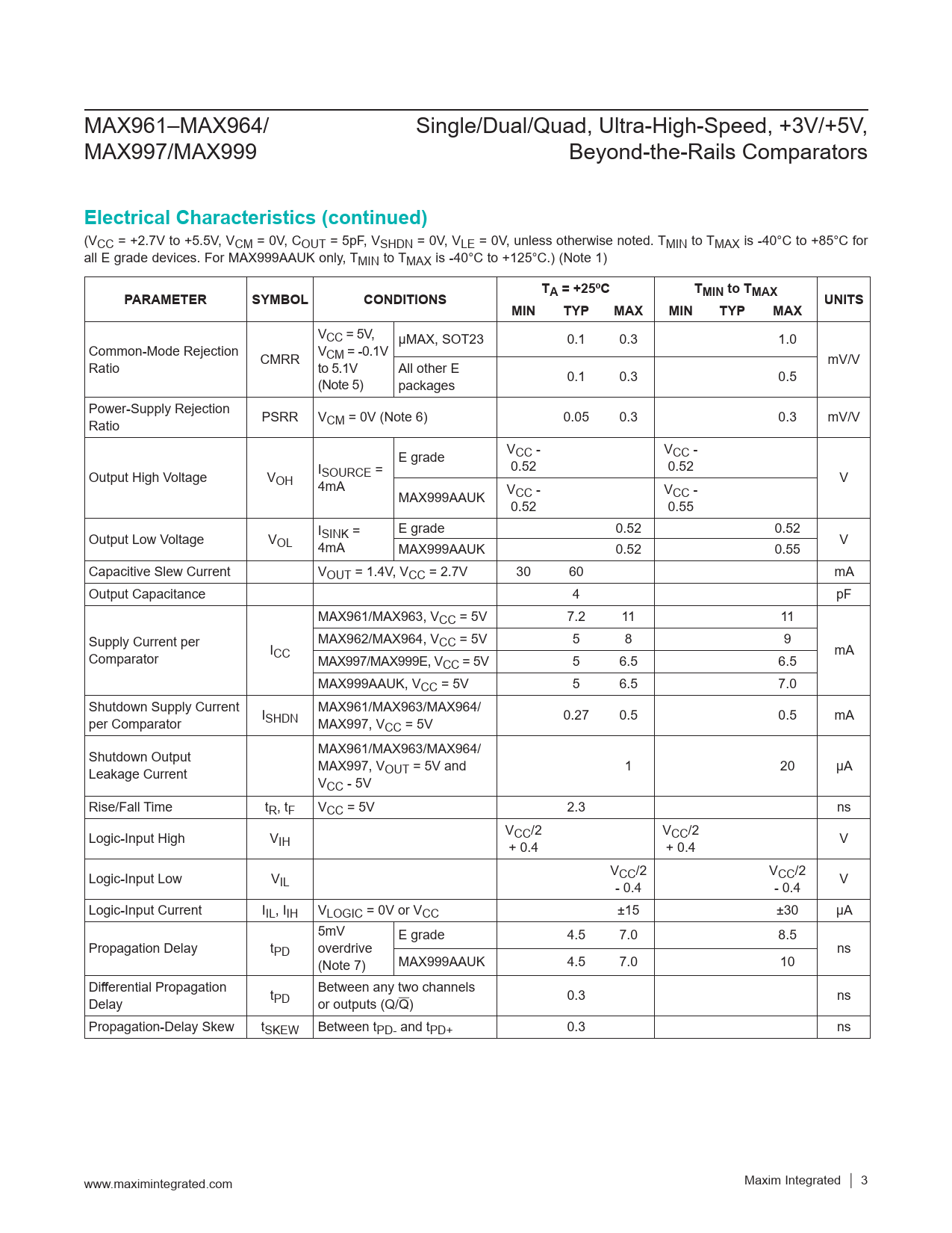

| Manufacturer | Maxim |
| Description | Single/Dual/Quad, Ultra-High-Speed, +3V/+5V, Beyond-the-Rails Comparators |
| Pages / Page | 13 / 3 — Electrical Characteristics (continued). PARAMETER. SYMBOL. CONDITIONS. A … |
| File Format / Size | PDF / 1.8 Mb |
Electrical Characteristics (continued). PARAMETER. SYMBOL. CONDITIONS. A = +25ºC. TMIN to TMAX. UNITS. MIN. TYP. MAX
MAX961–MAX964/ Single/Dual/Quad, Ultra-High-Speed, +3V/+5V, MAX997/MAX999 Beyond-the-Rails Comparators
(VCC = +2.7V to +5.5V, VCM = 0V, COUT = 5pF, VSHDN = 0V, VLE = 0V, unless otherwise noted. TMIN to TMAX is -40°C to +85°C for all E grade devices. For MAX999AAUK only, TMIN to TMAX is -40°C to +125°C.) (Note 1)
T PARAMETER SYMBOL CONDITIONS A = +25ºC TMIN to TMAX UNITS MIN TYP MAX MIN TYP MAX
VCC = 5V, µMAX, SOT23 0.1 0.3 1.0 Common-Mode Rejection VCM = -0.1V Ratio CMRR to 5.1V mV/V All other E (Note 5) packages 0.1 0.3 0.5 Power-Supply Rejection Ratio PSRR VCM = 0V (Note 6) 0.05 0.3 0.3 mV/V E grade VCC - VCC - 0.52 0.52 Output High Voltage V ISOURCE = OH 4mA V MAX999AAUK VCC - VCC - 0.52 0.55 E grade 0.52 0.52 Output Low Voltage V ISINK = OL 4mA V MAX999AAUK 0.52 0.55 Capacitive Slew Current VOUT = 1.4V, VCC = 2.7V 30 60 mA Output Capacitance 4 pF MAX961/MAX963, VCC = 5V 7.2 11 11 Supply Current per MAX962/MAX964, VCC = 5V 5 8 9 Comparator ICC mA MAX997/MAX999E, VCC = 5V 5 6.5 6.5 MAX999AAUK, VCC = 5V 5 6.5 7.0 Shutdown Supply Current MAX961/MAX963/MAX964/ per Comparator ISHDN MAX997, VCC = 5V 0.27 0.5 0.5 mA Shutdown Output MAX961/MAX963/MAX964/ Leakage Current MAX997, VOUT = 5V and 1 20 µA VCC - 5V Rise/Fall Time tR, tF VCC = 5V 2.3 ns Logic-Input High V VCC/2 VCC/2 IH + 0.4 + 0.4 V Logic-Input Low V VCC/2 VCC/2 IL - 0.4 - 0.4 V Logic-Input Current IIL, IIH VLOGIC = 0V or VCC ±15 ±30 µA 5mV E grade 4.5 7.0 8.5 Propagation Delay tPD overdrive ns (Note 7) MAX999AAUK 4.5 7.0 10 Differential Propagation Between any two channels Delay tPD or outputs (Q/Q) 0.3 ns Propagation-Delay Skew tSKEW Between tPD- and tPD+ 0.3 ns www.maximintegrated.com Maxim Integrated │ 3
