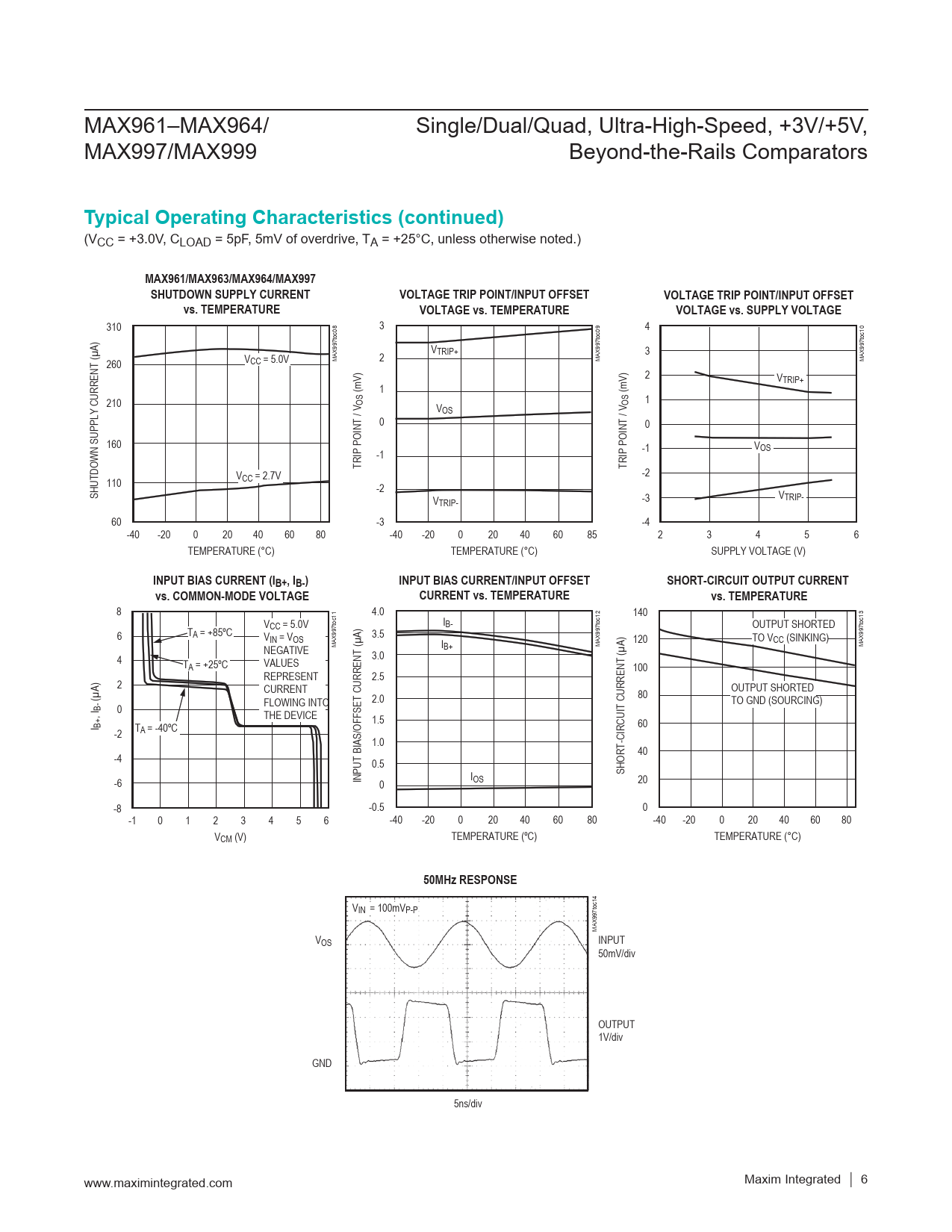

Typical Operating Characteristics (continued). MAX961/MAX963/MAX964/MAX997. SHUTDOWN SUPPLY CURRENT
Typical Operating Characteristics (continued) MAX961/MAX963/MAX964/MAX997 SHUTDOWN SUPPLY CURRENT
MAX961–MAX964/ Single/Dual/Quad, Ultra-High-Speed, +3V/+5V, MAX997/MAX999 Beyond-the-Rails Comparators
(VCC = +3.0V, CLOAD = 5pF, 5mV of overdrive, TA = +25°C, unless otherwise noted.)
MAX961/MAX963/MAX964/MAX997 SHUTDOWN SUPPLY CURRENT VOLTAGE TRIP POINT/INPUT OFFSET VOLTAGE TRIP POINT/INPUT OFFSET vs. TEMPERATURE VOLTAGE vs. TEMPERATURE VOLTAGE vs. SUPPLY VOLTAGE
310 3 4 VTRIP+ 3 260 V MAX997toc08 CC = 5.0V 2 MAX997toc09 MAX997toc10 2 VTRIP+ (mV) 1 (mV) 210 OS 1 V OS OS 0 0 160 V -1 -1 OS TRIP POINT / V TRIP POINT / V V -2 110 CC = 2.7V SHUTDOWN SUPPLY CURRENT (µA) -2 V V TRIP- -3 TRIP- 60 -3 -4 -40 -20 0 20 40 60 80 -40 -20 0 20 40 60 85 2 3 4 5 6 TEMPERATURE (°C) TEMPERATURE (°C) SUPPLY VOLTAGE (V)
INPUT BIAS CURRENT (IB+, IB-) INPUT BIAS CURRENT/INPUT OFFSET SHORT-CIRCUIT OUTPUT CURRENT vs. COMMON-MODE VOLTAGE CURRENT vs. TEMPERATURE vs. TEMPERATURE
8 4.0 140 VCC = 5.0V IB- OUTPUT SHORTED 6 TA = +85ºC VIN = VOS 3.5 120 TO VCC (SINKING) MAX997toc11 NEGATIVE I MAX997toc12 B+ MAX997toc13 4 3.0 T VALUES A = +25ºC 100 REPRESENT 2.5 2 CURRENT OUTPUT SHORTED (µA) 80 FLOWING INTO 2.0 TO GND (SOURCING) , I B- 0 THE DEVICE I B+ 1.5 60 -2 TA = -40ºC 1.0 40 -4 0.5 SHORT-CIRCUIT CURRENT (µA) -6 INPUT BIAS/OFFSET CURRENT (µA) I 0 OS 20 -8 -0.5 0 -1 0 1 2 3 4 5 6 -40 -20 0 20 40 60 80 -40 -20 0 20 40 60 80 VCM (V) TEMPERATURE (ºC) TEMPERATURE (°C)
50MHz RESPONSE
VIN = 100mVP-P MAX997toc14 VOS INPUT 50mV/div OUTPUT 1V/div GND 5ns/div www.maximintegrated.com Maxim Integrated │
