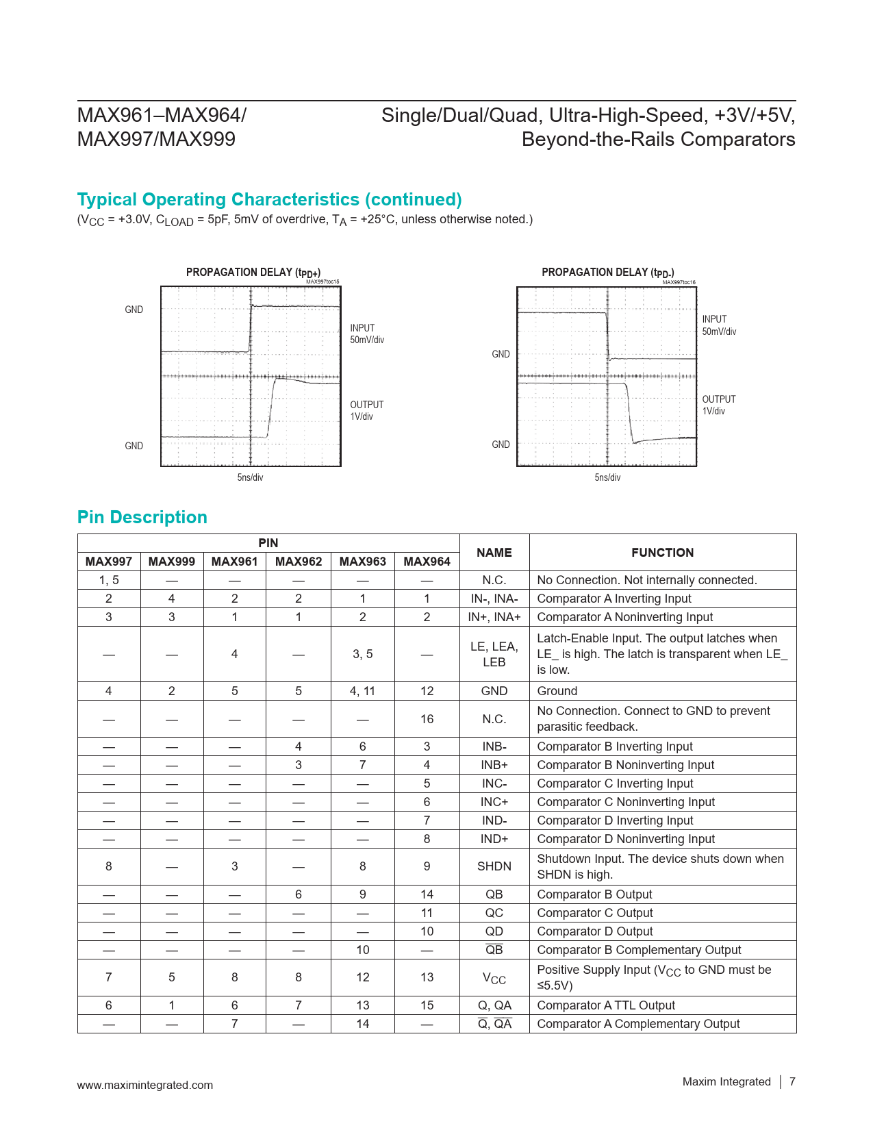

MAX961–MAX964/ Single/Dual/Quad, Ultra-High-Speed, +3V/+5V, MAX997/MAX999 Beyond-the-Rails Comparators
Typical Operating Characteristics (continued)
(VCC = +3.0V, CLOAD = 5pF, 5mV of overdrive, TA = +25°C, unless otherwise noted.)
PROPAGATION DELAY (tPD+) PROPAGATION DELAY (tPD-)
MAX997toc15 MAX997toc16 GND INPUT INPUT 50mV/div 50mV/div GND OUTPUT OUTPUT 1V/div 1V/div GND GND 5ns/div 5ns/div
Pin Description PIN NAME FUNCTION MAX997 MAX999 MAX961 MAX962 MAX963 MAX964
1, 5 — — — — — N.C. No Connection. Not internally connected. 2 4 2 2 1 1 IN-, INA- Comparator A Inverting Input 3 3 1 1 2 2 IN+, INA+ Comparator A Noninverting Input Latch-Enable Input. The output latches when — — 4 — 3, 5 — LE, LEA, LEB LE_ is high. The latch is transparent when LE_ is low. 4 2 5 5 4, 11 12 GND Ground — — — — — 16 N.C. No Connection. Connect to GND to prevent parasitic feedback. — — — 4 6 3 INB- Comparator B Inverting Input — — — 3 7 4 INB+ Comparator B Noninverting Input — — — — — 5 INC- Comparator C Inverting Input — — — — — 6 INC+ Comparator C Noninverting Input — — — — — 7 IND- Comparator D Inverting Input — — — — — 8 IND+ Comparator D Noninverting Input 8 — 3 — 8 9 SHDN Shutdown Input. The device shuts down when SHDN is high. — — — 6 9 14 QB Comparator B Output — — — — — 11 QC Comparator C Output — — — — — 10 QD Comparator D Output — — — — 10 — QB Comparator B Complementary Output 7 5 8 8 12 13 V Positive Supply Input (VCC to GND must be CC ≤5.5V) 6 1 6 7 13 15 Q, QA Comparator A TTL Output — — 7 — 14 — Q, QA Comparator A Complementary Output www.maximintegrated.com Maxim Integrated │
