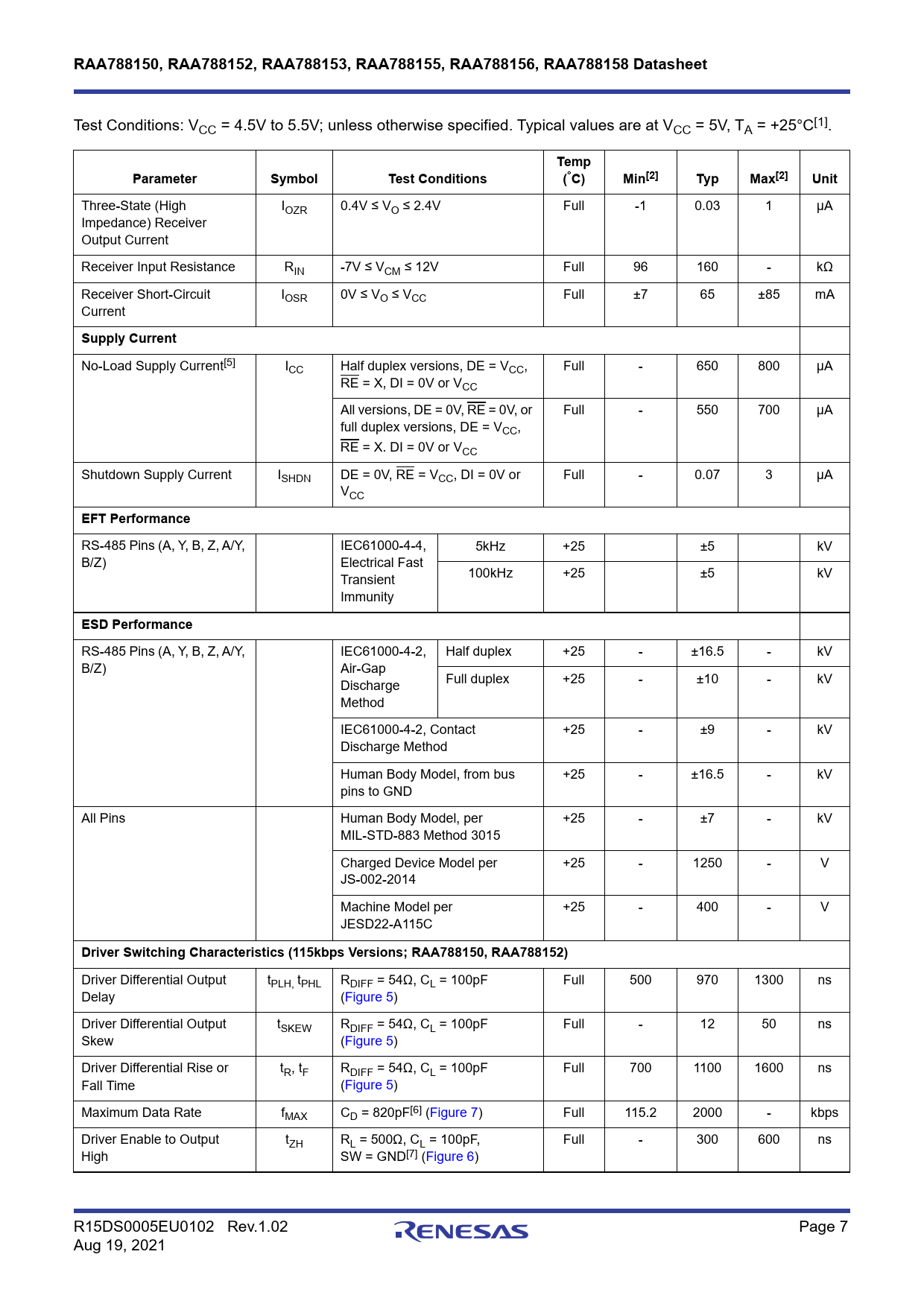

RAA788150, RAA788152, RAA788153, RAA788155, RAA788156, RAA788158 Datasheet
Test Conditions: VCC = 4.5V to 5.5V; unless otherwise specified. Typical values are at VCC = 5V, TA = +25°C[1].
Temp Parameter Symbol Test Conditions (°C) Min[2] Typ Max[2] Unit
Three-State (High IOZR 0.4V ≤ VO ≤ 2.4V Full -1 0.03 1 µA Impedance) Receiver Output Current Receiver Input Resistance RIN -7V ≤ VCM ≤ 12V Full 96 160 - kΩ Receiver Short-Circuit IOSR 0V ≤ VO ≤ VCC Full ±7 65 ±85 mA Current
Supply Current
No-Load Supply Current[5] ICC Half duplex versions, DE = VCC, Full - 650 800 µA RE = X, DI = 0V or VCC Al versions, DE = 0V, RE = 0V, or Full - 550 700 µA full duplex versions, DE = VCC, RE = X. DI = 0V or VCC Shutdown Supply Current ISHDN DE = 0V, RE = VCC, DI = 0V or Full - 0.07 3 µA VCC
EFT Performance
RS-485 Pins (A, Y, B, Z, A/Y, IEC61000-4-4, 5kHz +25 ±5 kV B/Z) Electrical Fast Transient 100kHz +25 ±5 kV Immunity
ESD Performance
RS-485 Pins (A, Y, B, Z, A/Y, IEC61000-4-2, Half duplex +25 - ±16.5 - kV B/Z) Air-Gap Discharge Full duplex +25 - ±10 - kV Method IEC61000-4-2, Contact +25 - ±9 - kV Discharge Method Human Body Model, from bus +25 - ±16.5 - kV pins to GND All Pins Human Body Model, per +25 - ±7 - kV MIL-STD-883 Method 3015 Charged Device Model per +25 - 1250 - V JS-002-2014 Machine Model per +25 - 400 - V JESD22-A115C
Driver Switching Characteristics (115kbps Versions; RAA788150, RAA788152)
Driver Differential Output tPLH, tPHL RDIFF = 54Ω, CL = 100pF Full 500 970 1300 ns Delay (Figure 5) Driver Differential Output tSKEW RDIFF = 54Ω, CL = 100pF Full - 12 50 ns Skew (Figure 5) Driver Differential Rise or tR, tF RDIFF = 54Ω, CL = 100pF Full 700 1100 1600 ns Fall Time (Figure 5) Maximum Data Rate fMAX CD = 820pF[6] (Figure 7) Full 115.2 2000 - kbps Driver Enable to Output tZH RL = 500Ω, CL = 100pF, Full - 300 600 ns High SW = GND[7] (Figure 6) R15DS0005EU0102 Rev.1.02 Page 7 Aug 19, 2021 Document Outline Features Applications Contents 1. Overview 1.1 Typical Operating Circuit 2. Pin Information 2.1 Pin Assignments 2.2 Pin Descriptions 3. Specifications 3.1 Absolute Maximum Ratings 3.2 Recommended Operating Conditions 3.3 Thermal Information 3.4 Electrical Specifications 4. Test Circuits and Waveforms 5. Typical Performance Curves 6. Device Description 6.1 Overview 6.2 Functional Block Diagram 6.3 Operating Modes 6.3.1 Driver Operation 6.3.2 Receiver Operation 6.4 Device Features 6.4.1 Large Output Signal Swing 6.4.2 Driver Overload Protection 6.4.3 Full-Failsafe Receiver 6.4.4 Low Current Shutdown Mode 6.4.5 Hot Plug Function 6.4.6 High EFT Immunity 6.4.7 High ESD Protection 7. Application Information 7.1 Network Design 7.1.1 Cable Type 7.1.2 Cable Length vs Data Rate 7.1.3 Topologies and Stub Lengths 7.1.4 Minimum Distance between Nodes 7.1.5 Failsafe Biasing Termination 7.2 Transient Protection 7.3 Layout Guidelines 7.3.1 Layout Example 8. Package Outline Drawings 9. Ordering Information 10. Revision History
