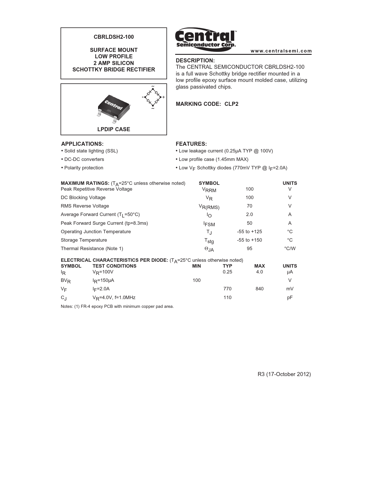

The CENTRAL SEMICONDUCTOR CBRLDSH2-100
SCHOTTKY BRIDGE RECTIFIER
is a full wave Schottky bridge rectifier mounted in a low profile epoxy surface mount molded case, utilizing glass passivated chips.
MARKING CODE: CLP2 LPDIP CASE APPLICATIONS: FEATURES:
Solid state lighting (SSL)
Low leakage current (0.25μA TYP @ 100V)
DC-DC converters
Low profile case (1.45mm MAX)
Polarity protection
Low VF Schottky diodes (770mV TYP @ IF=2.0A)
MAXIMUM RATINGS:
(TA=25°C unless otherwise noted)
SYMBOL UNITS
Peak Repetitive Reverse Voltage VRRM 100 V DC Blocking Voltage VR 100 V RMS Reverse Voltage VR(RMS) 70 V Average Forward Current (TL=50°C) IO 2.0 A Peak Forward Surge Current (tp=8.3ms) IFSM 50 A Operating Junction Temperature TJ -55 to +125 °C Storage Temperature Tstg -55 to +150 °C Thermal Resistance (Note 1) ΘJA 95 °C/W
ELECTRICAL CHARACTERISTICS PER DIODE:
SYMBOL TEST CONDITIONS MIN TYP MAX UNITS
IR VR=100V 0.25 4.0 μA BVR IR=150μA 100 V VF IF=2.0A 770 840 mV CJ VR=4.0V, f=1.0MHz 110 pF Notes: (1) FR-4 epoxy PCB with minimum copper pad area. R3 (17-October 2012)
