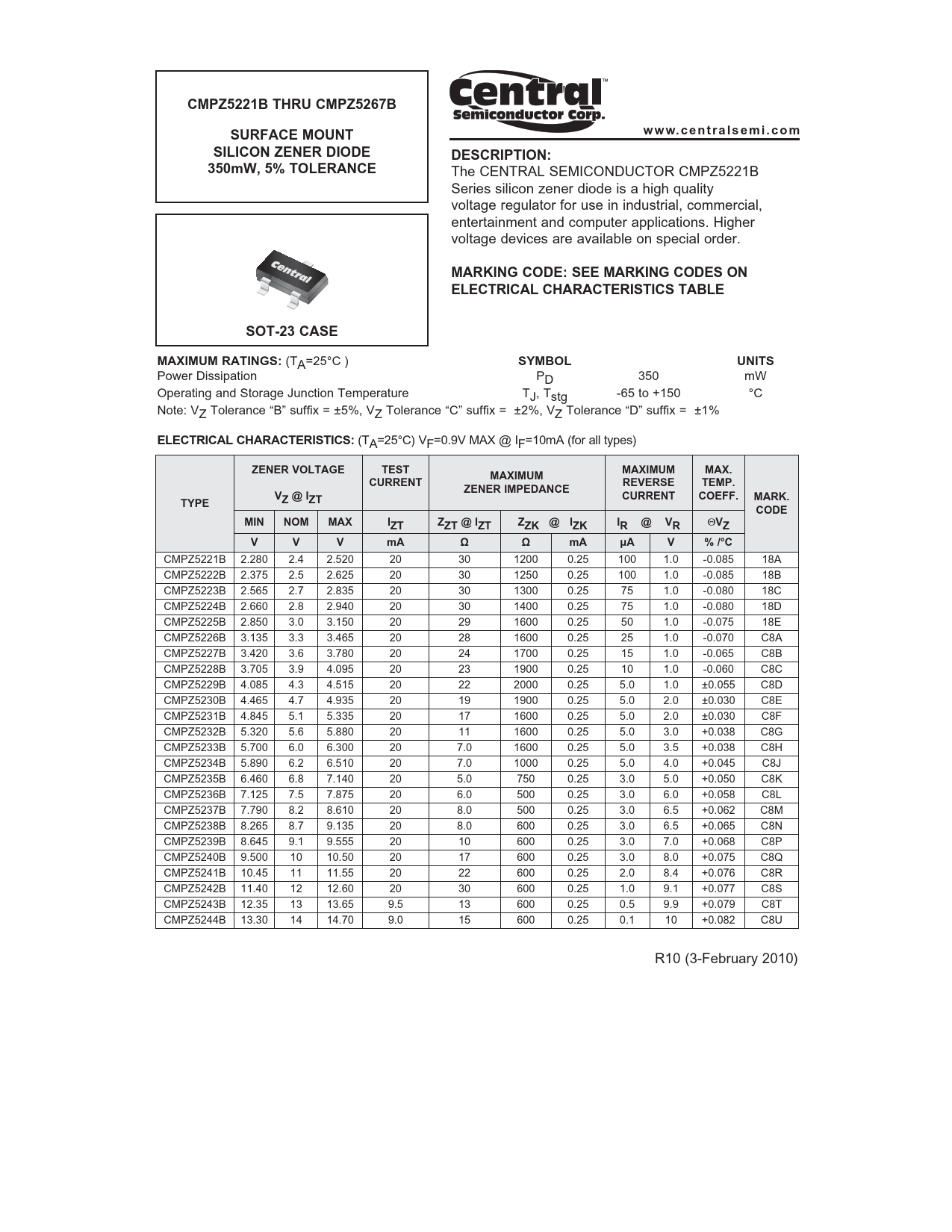

CMPZ5221B THRU CMPZ5267B. SURFACE MOUNT. w w w. c e n t r a l s e m i . c o m. SILICON ZENER DIODE. DESCRIPTION:
CMPZ5221B THRU CMPZ5267B SURFACE MOUNT w w w. c e n t r a l s e m i . c o m SILICON ZENER DIODE DESCRIPTION: 350mW, 5% TOLERANCE
The CENTRAL SEMICONDUCTOR CMPZ5221B Series silicon zener diode is a high quality voltage regulator for use in industrial, commercial, entertainment and computer applications. Higher voltage devices are available on special order.
MARKING CODE: SEE MARKING CODES ON ELECTRICAL CHARACTERISTICS TABLE SOT-23 CASE MAXIMUM RATINGS:
(TA=25°C )
SYMBOL UNITS
Power Dissipation PD 350 mW Operating and Storage Junction Temperature TJ, Tstg -65 to +150 °C Note: VZ Tolerance “B” suffix = ±5%, VZ Tolerance “C” suffix = ±2%, VZ Tolerance “D” suffix = ±1%
ELECTRICAL CHARACTERISTICS:
(TA=25°C) VF=0.9V MAX @ IF=10mA (for all types)
ZENER VOLTAGE TEST MAXIMUM MAX. MAXIMUM CURRENT REVERSE TEMP. ZENER IMPEDANCE V CURRENT COEFF. MARK. TYPE Z @ IZT CODE MIN NOM MAX IZT ZZT @ IZT ZZK @ IZK IR @ VR
Θ
VZ V V V mA Ω Ω mA μA V % /°C
CMPZ5221B 2.280 2.4 2.520 20 30 1200 0.25 100 1.0 -0.085 18A CMPZ5222B 2.375 2.5 2.625 20 30 1250 0.25 100 1.0 -0.085 18B CMPZ5223B 2.565 2.7 2.835 20 30 1300 0.25 75 1.0 -0.080 18C CMPZ5224B 2.660 2.8 2.940 20 30 1400 0.25 75 1.0 -0.080 18D CMPZ5225B 2.850 3.0 3.150 20 29 1600 0.25 50 1.0 -0.075 18E CMPZ5226B 3.135 3.3 3.465 20 28 1600 0.25 25 1.0 -0.070 C8A CMPZ5227B 3.420 3.6 3.780 20 24 1700 0.25 15 1.0 -0.065 C8B CMPZ5228B 3.705 3.9 4.095 20 23 1900 0.25 10 1.0 -0.060 C8C CMPZ5229B 4.085 4.3 4.515 20 22 2000 0.25 5.0 1.0 ±0.055 C8D CMPZ5230B 4.465 4.7 4.935 20 19 1900 0.25 5.0 2.0 ±0.030 C8E CMPZ5231B 4.845 5.1 5.335 20 17 1600 0.25 5.0 2.0 ±0.030 C8F CMPZ5232B 5.320 5.6 5.880 20 11 1600 0.25 5.0 3.0 +0.038 C8G CMPZ5233B 5.700 6.0 6.300 20 7.0 1600 0.25 5.0 3.5 +0.038 C8H CMPZ5234B 5.890 6.2 6.510 20 7.0 1000 0.25 5.0 4.0 +0.045 C8J CMPZ5235B 6.460 6.8 7.140 20 5.0 750 0.25 3.0 5.0 +0.050 C8K CMPZ5236B 7.125 7.5 7.875 20 6.0 500 0.25 3.0 6.0 +0.058 C8L CMPZ5237B 7.790 8.2 8.610 20 8.0 500 0.25 3.0 6.5 +0.062 C8M CMPZ5238B 8.265 8.7 9.135 20 8.0 600 0.25 3.0 6.5 +0.065 C8N CMPZ5239B 8.645 9.1 9.555 20 10 600 0.25 3.0 7.0 +0.068 C8P CMPZ5240B 9.500 10 10.50 20 17 600 0.25 3.0 8.0 +0.075 C8Q CMPZ5241B 10.45 11 11.55 20 22 600 0.25 2.0 8.4 +0.076 C8R CMPZ5242B 11.40 12 12.60 20 30 600 0.25 1.0 9.1 +0.077 C8S CMPZ5243B 12.35 13 13.65 9.5 13 600 0.25 0.5 9.9 +0.079 C8T CMPZ5244B 13.30 14 14.70 9.0 15 600 0.25 0.1 10 +0.082 C8U R10 (3-February 2010)
