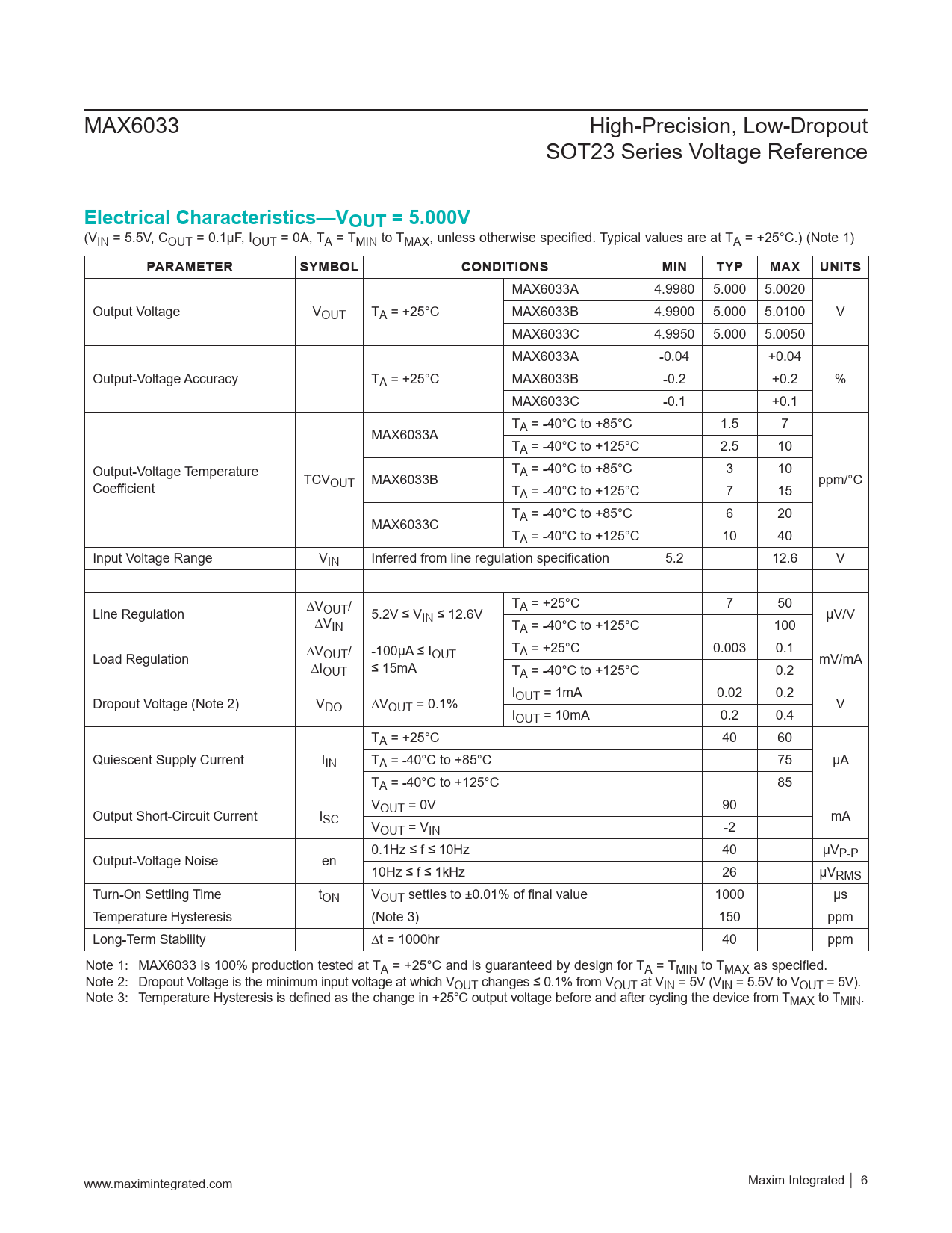

Pages / Page13 / 6 — Electrical Characteristics—VOUT = 5.000V. PARAMETER. SYMBOL. CONDITIONS. …
Electrical Characteristics—VOUT = 5.000V. PARAMETER. SYMBOL. CONDITIONS. MIN. TYP. MAX. UNITS
Electrical Characteristics—VOUT = 5.000V PARAMETER SYMBOL CONDITIONS MIN TYP MAX UNITS
MAX6033 High-Precision, Low-Dropout SOT23 Series Voltage Reference
(VIN = 5.5V, COUT = 0.1µF, IOUT = 0A, TA = TMIN to TMAX, unless otherwise specified. Typical values are at TA = +25°C.) (Note 1)
MAX6033A 4.9980 5.000 5.0020 Output Voltage VOUT TA = +25°C MAX6033B 4.9900 5.000 5.0100 V MAX6033C 4.9950 5.000 5.0050 MAX6033A -0.04 +0.04 Output-Voltage Accuracy TA = +25°C MAX6033B -0.2 +0.2 % MAX6033C -0.1 +0.1 T MAX6033A A = -40°C to +85°C 1.5 7 TA = -40°C to +125°C 2.5 10 Output-Voltage Temperature TA = -40°C to +85°C 3 10 Coefficient TCVOUT MAX6033B ppm/°C TA = -40°C to +125°C 7 15 T MAX6033C A = -40°C to +85°C 6 20 TA = -40°C to +125°C 10 40 Input Voltage Range VIN Inferred from line regulation specification 5.2 12.6 V T Line Regulation ∆VOUT/ A = +25°C 7 50 ∆V 5.2V ≤ VIN ≤ 12.6V µV/V IN TA = -40°C to +125°C 100 T Load Regulation ∆VOUT/ -100µA ≤ IOUT A = +25°C 0.003 0.1 ∆I mV/mA OUT ≤ 15mA TA = -40°C to +125°C 0.2 I Dropout Voltage (Note 2) V OUT = 1mA 0.02 0.2 DO ∆VOUT = 0.1% V IOUT = 10mA 0.2 0.4 TA = +25°C 40 60 Quiescent Supply Current IIN TA = -40°C to +85°C 75 µA TA = -40°C to +125°C 85 V Output Short-Circuit Current I OUT = 0V 90 SC mA VOUT = VIN -2 0.1Hz ≤ f ≤ 10Hz 40 µV Output-Voltage Noise en P-P 10Hz ≤ f ≤ 1kHz 26 µVRMS Turn-On Settling Time tON VOUT settles to ±0.01% of final value 1000 µs Temperature Hysteresis (Note 3) 150 ppm Long-Term Stability ∆t = 1000hr 40 ppm Note 1: MAX6033 is 100% production tested at TA = +25°C and is guaranteed by design for TA = TMIN to TMAX as specified. Note 2: Dropout Voltage is the minimum input voltage at which VOUT changes ≤ 0.1% from VOUT at VIN = 5V (VIN = 5.5V to VOUT = 5V). Note 3: Temperature Hysteresis is defined as the change in +25°C output voltage before and after cycling the device from TMAX to TMIN. www.maximintegrated.com Maxim Integrated │ 6 Document Outline _GoBack
