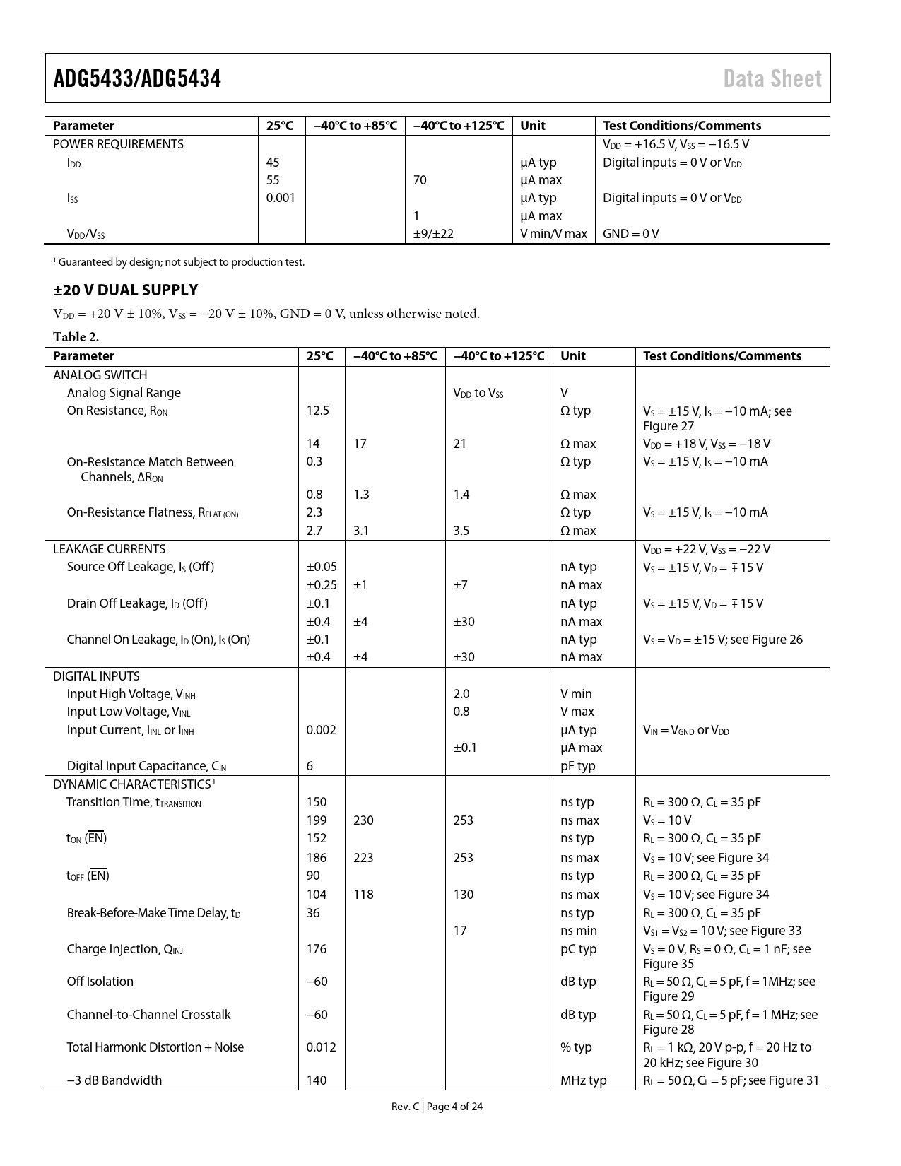

ADG5433/ADG5434. Data Sheet. Parameter. 25°C −40°C to +85°C −40°C to +125°C Unit. Test Conditions/Comments. ±20 V DUAL SUPPLY
ADG5433/ADG5434 Data Sheet Parameter 25°C −40°C to +85°C −40°C to +125°C Unit Test Conditions/Comments ±20 V DUAL SUPPLY
link to page 16 link to page 16 link to page 17 link to page 17 link to page 17 link to page 17 link to page 16 link to page 16 link to page 16 link to page 16 link to page 5
POWER REQUIREMENTS VDD = +16.5 V, VSS = −16.5 V IDD 45 µA typ Digital inputs = 0 V or VDD 55 70 µA max ISS 0.001 µA typ Digital inputs = 0 V or VDD 1 µA max VDD/VSS ±9/±22 V min/V max GND = 0 V 1 Guaranteed by design; not subject to production test.
±20 V DUAL SUPPLY
VDD = +20 V ± 10%, VSS = −20 V ± 10%, GND = 0 V, unless otherwise noted.
Table 2. Parameter 25°C −40°C to +85°C −40°C to +125°C Unit Test Conditions/Comments
ANALOG SWITCH Analog Signal Range VDD to VSS V On Resistance, RON 12.5 Ω typ VS = ±15 V, IS = −10 mA; see Figure 27 14 17 21 Ω max VDD = +18 V, VSS = −18 V On-Resistance Match Between 0.3 Ω typ VS = ±15 V, IS = −10 mA Channels, ∆RON 0.8 1.3 1.4 Ω max On-Resistance Flatness, RFLAT (ON) 2.3 Ω typ VS = ±15 V, IS = −10 mA 2.7 3.1 3.5 Ω max LEAKAGE CURRENTS VDD = +22 V, VSS = −22 V Source Off Leakage, IS (Off) ±0.05 nA typ VS = ±15 V, VD =  15 V ±0.25 ±1 ±7 nA max Drain Off Leakage, ID (Off) ±0.1 nA typ VS = ±15 V, VD =  15 V ±0.4 ±4 ±30 nA max Channel On Leakage, ID (On), IS (On) ±0.1 nA typ VS = VD = ±15 V; see Figure 26 ±0.4 ±4 ±30 nA max DIGITAL INPUTS Input High Voltage, VINH 2.0 V min Input Low Voltage, VINL 0.8 V max Input Current, IINL or IINH 0.002 µA typ VIN = VGND or VDD ±0.1 µA max Digital Input Capacitance, CIN 6 pF typ DYNAMIC CHARACTERISTICS1 Transition Time, tTRANSITION 150 ns typ RL = 300 Ω, CL = 35 pF 199 230 253 ns max VS = 10 V tON (EN) 152 ns typ RL = 300 Ω, CL = 35 pF 186 223 253 ns max VS = 10 V; see Figure 34 tOFF (EN) 90 ns typ RL = 300 Ω, CL = 35 pF 104 118 130 ns max VS = 10 V; see Figure 34 Break-Before-Make Time Delay, tD 36 ns typ RL = 300 Ω, CL = 35 pF 17 ns min VS1 = VS2 = 10 V; see Figure 33 Charge Injection, QINJ 176 pC typ VS = 0 V, RS = 0 Ω, CL = 1 nF; see Figure 35 Off Isolation −60 dB typ RL = 50 Ω, CL = 5 pF, f = 1MHz; see Figure 29 Channel-to-Channel Crosstalk −60 dB typ RL = 50 Ω, CL = 5 pF, f = 1 MHz; see Figure 28 Total Harmonic Distortion + Noise 0.012 % typ RL = 1 kΩ, 20 V p-p, f = 20 Hz to 20 kHz; see Figure 30 −3 dB Bandwidth 140 MHz typ RL = 50 Ω, CL = 5 pF; see Figure 31 Rev. C | Page 4 of 24 Document Outline Features Applications Functional Block Diagrams General Description Product Highlights Revision History Specifications ±15 V Dual Supply ±20 V Dual Supply 12 V Single Supply 36 V Single Supply Continuous Current per Channel, Sx or Dx Absolute Maximum Ratings ESD Caution Pin Configurations and Function Descriptions Typical Performance Characteristics Test Circuits Terminology Trench Isolation Applications Information Outline Dimensions Ordering Guide
