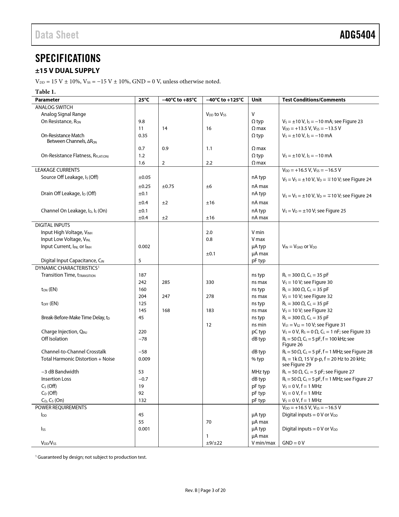

Data Sheet. ADG5404. SPECIFICATIONS ±15 V DUAL SUPPLY. Table 1. Parameter. 25°C. −40°C to +85°C. −40°C to +125°C. Unit
Data Sheet ADG5404 SPECIFICATIONS ±15 V DUAL SUPPLY Table 1 Parameter 25°C −40°C to +85°C −40°C to +125°C Unit
link to page 14 link to page 14 link to page 14 link to page 14 link to page 15 link to page 16 link to page 16 link to page 15 link to page 16 link to page 14 link to page 14 link to page 15 link to page 14 link to page 14
VDD = 15 V ± 10%, VSS = −15 V ± 10%, GND = 0 V, unless otherwise noted.
Table 1. Parameter 25°C −40°C to +85°C −40°C to +125°C Unit Test Conditions/Comments
ANALOG SWITCH Analog Signal Range VDD to VSS V On Resistance, RON 9.8 Ω typ VS = ±10 V, IS = −10 mA; see Figure 23 11 14 16 Ω max VDD = +13.5 V, VSS = −13.5 V On-Resistance Match 0.35 Ω typ VS = ±10 V, IS = −10 mA Between Channels, ∆RON 0.7 0.9 1.1 Ω max On-Resistance Flatness, RFLAT(ON) 1.2 Ω typ VS = ±10 V, IS = −10 mA 1.6 2 2.2 Ω max LEAKAGE CURRENTS VDD = +16.5 V, VSS = −16.5 V Source Off Leakage, IS (Off) ±0.05 nA typ VS = VS = ±10 V, VD = ∓10 V; see Figure 24 ±0.25 ±0.75 ±6 nA max Drain Off Leakage, ID (Off) ±0.1 nA typ VS = VS = ±10 V, VD = ∓10 V; see Figure 24 ±0.4 ±2 ±16 nA max Channel On Leakage, ID, IS (On) ±0.1 nA typ VS = VD = ±10 V; see Figure 25 ±0.4 ±2 ±16 nA max DIGITAL INPUTS Input High Voltage, VINH 2.0 V min Input Low Voltage, VINL 0.8 V max Input Current, IINL or IINH 0.002 µA typ VIN = VGND or VDD ±0.1 µA max Digital Input Capacitance, CIN 5 pF typ DYNAMIC CHARACTERISTICS1 Transition Time, tTRANSITION 187 ns typ RL = 300 Ω, CL = 35 pF 242 285 330 ns max VS = 10 V; see Figure 30 tON (EN) 160 ns typ RL = 300 Ω, CL = 35 pF 204 247 278 ns max VS = 10 V; see Figure 32 tOFF (EN) 125 ns typ RL = 300 Ω, CL = 35 pF 145 168 183 ns max VS = 10 V; see Figure 32 Break-Before-Make Time Delay, tD 45 ns typ RL = 300 Ω, CL = 35 pF 12 ns min VS1 = VS2 = 10 V; see Figure 31 Charge Injection, QINJ 220 pC typ VS = 0 V, RS = 0 Ω, CL = 1 nF; see Figure 33 Off Isolation −78 dB typ RL = 50 Ω, CL = 5 pF, f = 100 kHz; see Figure 26 Channel-to-Channel Crosstalk −58 dB typ RL = 50 Ω, CL = 5 pF, f = 1 MHz; see Figure 28 Total Harmonic Distortion + Noise 0.009 % typ RL = 1k Ω, 15 V p-p, f = 20 Hz to 20 kHz; see Figure 29 −3 dB Bandwidth 53 MHz typ RL = 50 Ω, CL = 5 pF; see Figure 27 Insertion Loss −0.7 dB typ RL = 50 Ω, CL = 5 pF, f = 1 MHz; see Figure 27 CS (Off) 19 pF typ VS = 0 V, f = 1 MHz CD (Off) 92 pF typ VS = 0 V, f = 1 MHz CD, CS (On) 132 pF typ VS = 0 V, f = 1 MHz POWER REQUIREMENTS VDD = +16.5 V, VSS = −16.5 V IDD 45 µA typ Digital inputs = 0 V or VDD 55 70 µA max ISS 0.001 µA typ Digital inputs = 0 V or VDD 1 µA max VDD/VSS ±9/±22 V min/max GND = 0 V 1 Guaranteed by design; not subject to production test. Rev. B | Page 3 of 20 Document Outline FEATURES APPLICATIONS FUNCTIONAL BLOCK DIAGRAM GENERAL DESCRIPTION PRODUCT HIGHLIGHTS REVISION HISTORY SPECIFICATIONS ±15 V DUAL SUPPLY ±20 V DUAL SUPPLY +12 V SINGLE SUPPLY +36 V SINGLE SUPPLY CONTINUOUS CURRENT PER CHANNEL, S OR D ABSOLUTE MAXIMUM RATINGS ESD CAUTION PIN CONFIGURATIONS AND FUNCTION DESCRIPTIONS TRUTH TABLE TYPICAL PERFORMANCE CHARACTERISTICS TEST CIRCUITS TERMINOLOGY TRENCH ISOLATION APPLICATIONS INFORMATION OUTLINE DIMENSIONS ORDERING GUIDE
