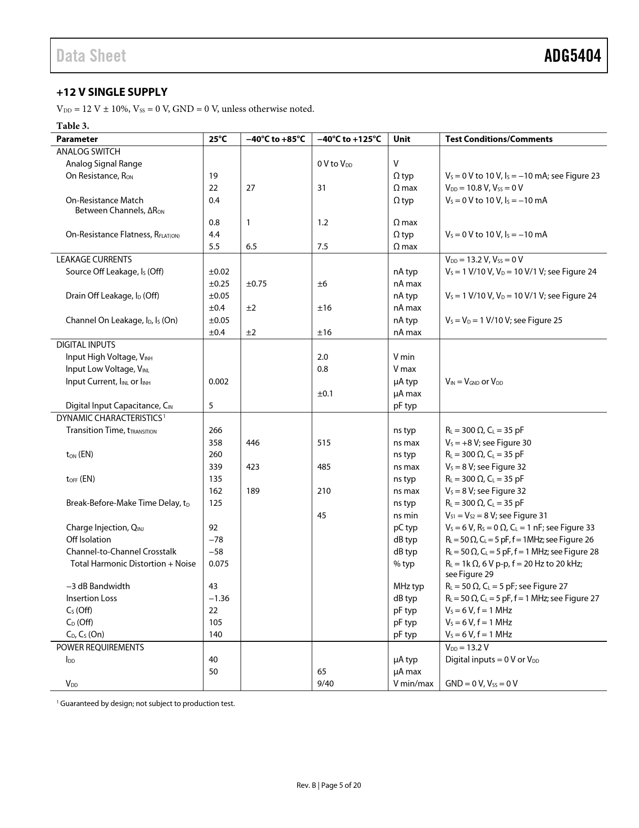

Data Sheet. ADG5404. +12 V SINGLE SUPPLY. Table 3. Parameter. 25°C. −40°C to +85°C. −40°C to +125°C. Unit. Test Conditions/Comments
Data Sheet ADG5404 +12 V SINGLE SUPPLY Table 3 Parameter 25°C −40°C to +85°C −40°C to +125°C Unit Test Conditions/Comments
link to page 14 link to page 14 link to page 14 link to page 14 link to page 15 link to page 16 link to page 16 link to page 15 link to page 16 link to page 14 link to page 14 link to page 15 link to page 14 link to page 14
VDD = 12 V ± 10%, VSS = 0 V, GND = 0 V, unless otherwise noted.
Table 3. Parameter 25°C −40°C to +85°C −40°C to +125°C Unit Test Conditions/Comments
ANALOG SWITCH Analog Signal Range 0 V to VDD V On Resistance, RON 19 Ω typ VS = 0 V to 10 V, IS = −10 mA; see Figure 23 22 27 31 Ω max VDD = 10.8 V, VSS = 0 V On-Resistance Match 0.4 Ω typ VS = 0 V to 10 V, IS = −10 mA Between Channels, ∆RON 0.8 1 1.2 Ω max On-Resistance Flatness, RFLAT(ON) 4.4 Ω typ VS = 0 V to 10 V, IS = −10 mA 5.5 6.5 7.5 Ω max LEAKAGE CURRENTS VDD = 13.2 V, VSS = 0 V Source Off Leakage, IS (Off) ±0.02 nA typ VS = 1 V/10 V, VD = 10 V/1 V; see Figure 24 ±0.25 ±0.75 ±6 nA max Drain Off Leakage, ID (Off) ±0.05 nA typ VS = 1 V/10 V, VD = 10 V/1 V; see Figure 24 ±0.4 ±2 ±16 nA max Channel On Leakage, ID, IS (On) ±0.05 nA typ VS = VD = 1 V/10 V; see Figure 25 ±0.4 ±2 ±16 nA max DIGITAL INPUTS Input High Voltage, VINH 2.0 V min Input Low Voltage, VINL 0.8 V max Input Current, IINL or IINH 0.002 µA typ VIN = VGND or VDD ±0.1 µA max Digital Input Capacitance, CIN 5 pF typ DYNAMIC CHARACTERISTICS1 Transition Time, tTRANSITION 266 ns typ RL = 300 Ω, CL = 35 pF 358 446 515 ns max VS = +8 V; see Figure 30 tON (EN) 260 ns typ RL = 300 Ω, CL = 35 pF 339 423 485 ns max VS = 8 V; see Figure 32 tOFF (EN) 135 ns typ RL = 300 Ω, CL = 35 pF 162 189 210 ns max VS = 8 V; see Figure 32 Break-Before-Make Time Delay, tD 125 ns typ RL = 300 Ω, CL = 35 pF 45 ns min VS1 = VS2 = 8 V; see Figure 31 Charge Injection, QINJ 92 pC typ VS = 6 V, RS = 0 Ω, CL = 1 nF; see Figure 33 Off Isolation −78 dB typ RL = 50 Ω, CL = 5 pF, f = 1MHz; see Figure 26 Channel-to-Channel Crosstalk −58 dB typ RL = 50 Ω, CL = 5 pF, f = 1 MHz; see Figure 28 Total Harmonic Distortion + Noise 0.075 % typ RL = 1k Ω, 6 V p-p, f = 20 Hz to 20 kHz; see Figure 29 −3 dB Bandwidth 43 MHz typ RL = 50 Ω, CL = 5 pF; see Figure 27 Insertion Loss −1.36 dB typ RL = 50 Ω, CL = 5 pF, f = 1 MHz; see Figure 27 CS (Off) 22 pF typ VS = 6 V, f = 1 MHz CD (Off) 105 pF typ VS = 6 V, f = 1 MHz CD, CS (On) 140 pF typ VS = 6 V, f = 1 MHz POWER REQUIREMENTS VDD = 13.2 V IDD 40 µA typ Digital inputs = 0 V or VDD 50 65 µA max VDD 9/40 V min/max GND = 0 V, VSS = 0 V 1 Guaranteed by design; not subject to production test. Rev. B | Page 5 of 20 Document Outline FEATURES APPLICATIONS FUNCTIONAL BLOCK DIAGRAM GENERAL DESCRIPTION PRODUCT HIGHLIGHTS REVISION HISTORY SPECIFICATIONS ±15 V DUAL SUPPLY ±20 V DUAL SUPPLY +12 V SINGLE SUPPLY +36 V SINGLE SUPPLY CONTINUOUS CURRENT PER CHANNEL, S OR D ABSOLUTE MAXIMUM RATINGS ESD CAUTION PIN CONFIGURATIONS AND FUNCTION DESCRIPTIONS TRUTH TABLE TYPICAL PERFORMANCE CHARACTERISTICS TEST CIRCUITS TERMINOLOGY TRENCH ISOLATION APPLICATIONS INFORMATION OUTLINE DIMENSIONS ORDERING GUIDE
