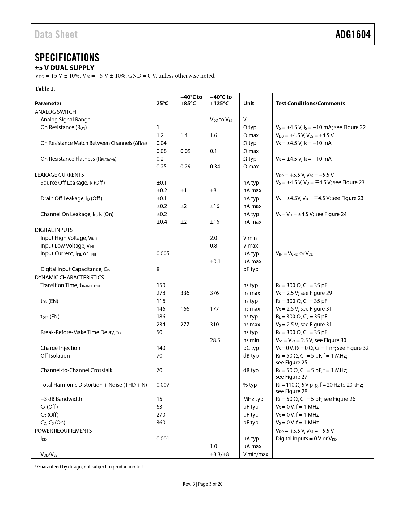

Data Sheet ADG1604 SPECIFICATIONS ±5 V DUAL SUPPLY
VDD = +5 V ± 10%, VSS = −5 V ± 10%, GND = 0 V, unless otherwise noted.
Table 1. −40°C to −40°C to Parameter 25°C +85°C +125°C Unit Test Conditions/Comments
ANALOG SWITCH Analog Signal Range VDD to VSS V On Resistance (RON) 1 Ω typ VS = ±4.5 V, IS = −10 mA; see Figure 22 1.2 1.4 1.6 Ω max VDD = ±4.5 V, VSS = ±4.5 V On Resistance Match Between Channels (∆RON) 0.04 Ω typ VS = ±4.5 V, IS = −10 mA 0.08 0.09 0.1 Ω max On Resistance Flatness (RFLAT(ON)) 0.2 Ω typ VS = ±4.5 V, IS = −10 mA 0.25 0.29 0.34 Ω max LEAKAGE CURRENTS VDD = +5.5 V, VSS = −5.5 V Source Off Leakage, IS (Off) ±0.1 nA typ VS = ±4.5 V, VD = ∓4.5 V; see Figure 23 ±0.2 ±1 ±8 nA max Drain Off Leakage, ID (Off) ±0.1 nA typ VS = ±4.5V, VD = ∓4.5 V; see Figure 23 ±0.2 ±2 ±16 nA max Channel On Leakage, ID, IS (On) ±0.2 nA typ VS = VD = ±4.5 V; see Figure 24 ±0.4 ±2 ±16 nA max DIGITAL INPUTS Input High Voltage, VINH 2.0 V min Input Low Voltage, VINL 0.8 V max Input Current, IINL or IINH 0.005 µA typ VIN = VGND or VDD ±0.1 µA max Digital Input Capacitance, CIN 8 pF typ DYNAMIC CHARACTERISTICS1 Transition Time, tTRANSITION 150 ns typ RL = 300 Ω, CL = 35 pF 278 336 376 ns max VS = 2.5 V; see Figure 29 tON (EN) 116 ns typ RL = 300 Ω, CL = 35 pF 146 166 177 ns max VS = 2.5 V; see Figure 31 tOFF (EN) 186 ns typ RL = 300 Ω, CL = 35 pF 234 277 310 ns max VS = 2.5 V; see Figure 31 Break-Before-Make Time Delay, tD 50 ns typ RL = 300 Ω, CL = 35 pF 28.5 ns min VS1 = VS2 = 2.5 V; see Figure 30 Charge Injection 140 pC typ VS = 0 V, RS = 0 Ω, CL = 1 nF; see Figure 32 Off Isolation 70 dB typ RL = 50 Ω, CL = 5 pF, f = 1 MHz; see Figure 25 Channel-to-Channel Crosstalk 70 dB typ RL = 50 Ω, CL = 5 pF, f = 1 MHz; see Figure 27 Total Harmonic Distortion + Noise (THD + N) 0.007 % typ RL = 110 Ω, 5 V p-p, f = 20 Hz to 20 kHz; see Figure 28 −3 dB Bandwidth 15 MHz typ RL = 50 Ω, CL = 5 pF; see Figure 26 CS (Off) 63 pF typ VS = 0 V, f = 1 MHz CD (Off) 270 pF typ VS = 0 V, f = 1 MHz CD, CS (On) 360 pF typ VS = 0 V, f = 1 MHz POWER REQUIREMENTS VDD = +5.5 V, VSS = −5.5 V IDD 0.001 µA typ Digital inputs = 0 V or VDD 1.0 µA max VDD/VSS ±3.3/±8 V min/max 1 Guaranteed by design, not subject to production test. Rev. B | Page 3 of 20 Document Outline FEATURES APPLICATIONS FUNCTIONAL BLOCK DIAGRAM GENERAL DESCRIPTION PRODUCT HIGHLIGHTS TABLE OF CONTENTS REVISION HISTORY SPECIFICATIONS ±5 V DUAL SUPPLY 12 V SINGLE SUPPLY 5 V SINGLE SUPPLY 3.3 V SINGLE SUPPLY CONTINUOUS CURRENT PER CHANNEL, S OR D ABSOLUTE MAXIMUM RATINGS ESD CAUTION PIN CONFIGURATIONS AND FUNCTION DESCRIPTIONS TYPICAL PERFORMANCE CHARACTERISTICS TEST CIRCUITS TERMINOLOGY OUTLINE DIMENSIONS ORDERING GUIDE
