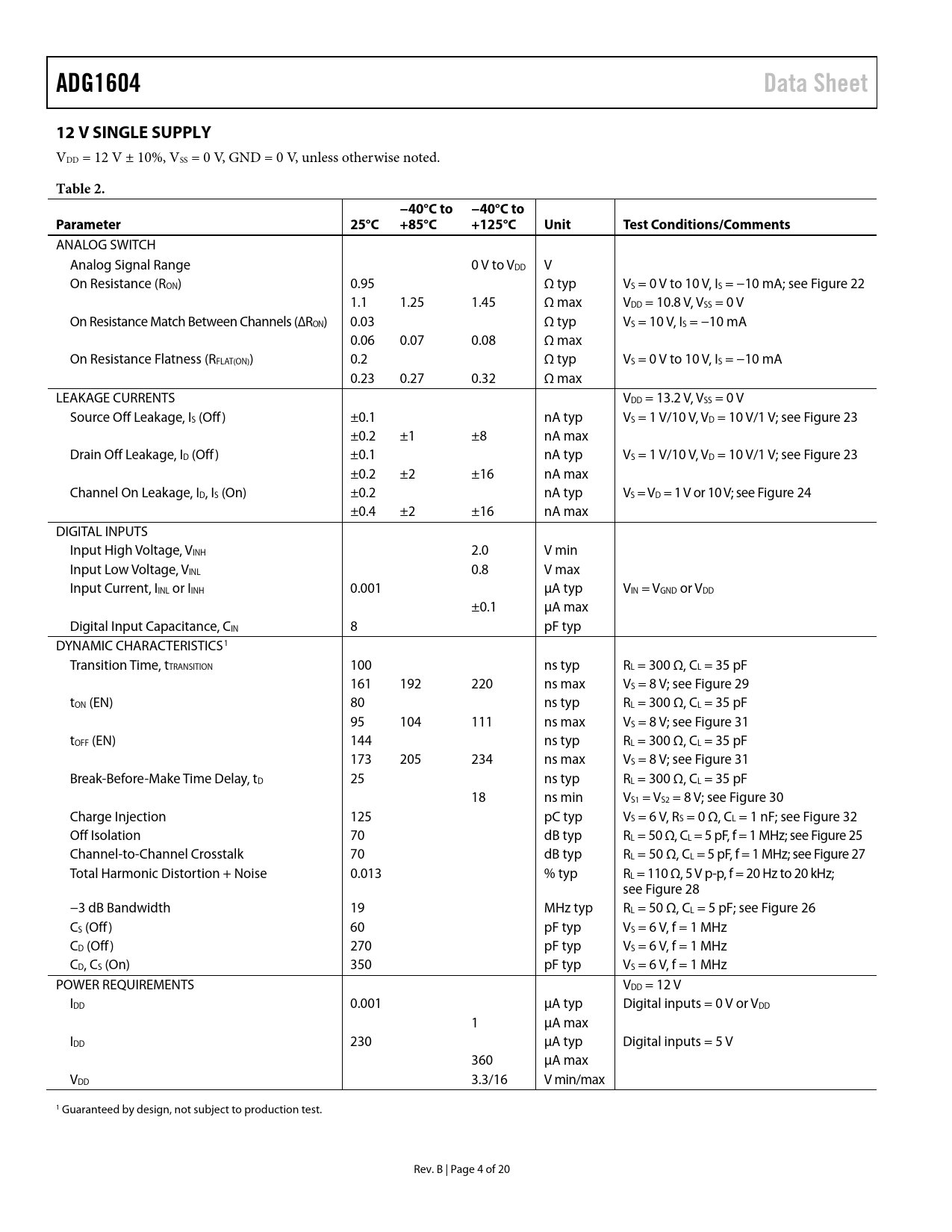

ADG1604. Data Sheet. 12 V SINGLE SUPPLY. Table 2. −40°C to −40°C to. Parameter. 25°C +85°C. +125°C. Unit. Test Conditions/Comments
ADG1604 Data Sheet 12 V SINGLE SUPPLY Table 2 −40°C to −40°C to Parameter 25°C +85°C +125°C Unit Test Conditions/Comments
link to page 13 link to page 13 link to page 13 link to page 13 link to page 14 link to page 15 link to page 15 link to page 14 link to page 15 link to page 13 link to page 13 link to page 14 link to page 13
VDD = 12 V ± 10%, VSS = 0 V, GND = 0 V, unless otherwise noted.
Table 2. −40°C to −40°C to Parameter 25°C +85°C +125°C Unit Test Conditions/Comments
ANALOG SWITCH Analog Signal Range 0 V to VDD V On Resistance (RON) 0.95 Ω typ VS = 0 V to 10 V, IS = −10 mA; see Figure 22 1.1 1.25 1.45 Ω max VDD = 10.8 V, VSS = 0 V On Resistance Match Between Channels (∆RON) 0.03 Ω typ VS = 10 V, IS = −10 mA 0.06 0.07 0.08 Ω max On Resistance Flatness (RFLAT(ON)) 0.2 Ω typ VS = 0 V to 10 V, IS = −10 mA 0.23 0.27 0.32 Ω max LEAKAGE CURRENTS VDD = 13.2 V, VSS = 0 V Source Off Leakage, IS (Off) ±0.1 nA typ VS = 1 V/10 V, VD = 10 V/1 V; see Figure 23 ±0.2 ±1 ±8 nA max Drain Off Leakage, ID (Off) ±0.1 nA typ VS = 1 V/10 V, VD = 10 V/1 V; see Figure 23 ±0.2 ±2 ±16 nA max Channel On Leakage, ID, IS (On) ±0.2 nA typ VS = VD = 1 V or 10 V; see Figure 24 ±0.4 ±2 ±16 nA max DIGITAL INPUTS Input High Voltage, VINH 2.0 V min Input Low Voltage, VINL 0.8 V max Input Current, IINL or IINH 0.001 µA typ VIN = VGND or VDD ±0.1 µA max Digital Input Capacitance, CIN 8 pF typ DYNAMIC CHARACTERISTICS1 Transition Time, tTRANSITION 100 ns typ RL = 300 Ω, CL = 35 pF 161 192 220 ns max VS = 8 V; see Figure 29 tON (EN) 80 ns typ RL = 300 Ω, CL = 35 pF 95 104 111 ns max VS = 8 V; see Figure 31 tOFF (EN) 144 ns typ RL = 300 Ω, CL = 35 pF 173 205 234 ns max VS = 8 V; see Figure 31 Break-Before-Make Time Delay, tD 25 ns typ RL = 300 Ω, CL = 35 pF 18 ns min VS1 = VS2 = 8 V; see Figure 30 Charge Injection 125 pC typ VS = 6 V, RS = 0 Ω, CL = 1 nF; see Figure 32 Off Isolation 70 dB typ RL = 50 Ω, CL = 5 pF, f = 1 MHz; see Figure 25 Channel-to-Channel Crosstalk 70 dB typ RL = 50 Ω, CL = 5 pF, f = 1 MHz; see Figure 27 Total Harmonic Distortion + Noise 0.013 % typ RL = 110 Ω, 5 V p-p, f = 20 Hz to 20 kHz; see Figure 28 −3 dB Bandwidth 19 MHz typ RL = 50 Ω, CL = 5 pF; see Figure 26 CS (Off) 60 pF typ VS = 6 V, f = 1 MHz CD (Off) 270 pF typ VS = 6 V, f = 1 MHz CD, CS (On) 350 pF typ VS = 6 V, f = 1 MHz POWER REQUIREMENTS VDD = 12 V IDD 0.001 µA typ Digital inputs = 0 V or VDD 1 µA max IDD 230 µA typ Digital inputs = 5 V 360 µA max VDD 3.3/16 V min/max 1 Guaranteed by design, not subject to production test. Rev. B | Page 4 of 20 Document Outline FEATURES APPLICATIONS FUNCTIONAL BLOCK DIAGRAM GENERAL DESCRIPTION PRODUCT HIGHLIGHTS TABLE OF CONTENTS REVISION HISTORY SPECIFICATIONS ±5 V DUAL SUPPLY 12 V SINGLE SUPPLY 5 V SINGLE SUPPLY 3.3 V SINGLE SUPPLY CONTINUOUS CURRENT PER CHANNEL, S OR D ABSOLUTE MAXIMUM RATINGS ESD CAUTION PIN CONFIGURATIONS AND FUNCTION DESCRIPTIONS TYPICAL PERFORMANCE CHARACTERISTICS TEST CIRCUITS TERMINOLOGY OUTLINE DIMENSIONS ORDERING GUIDE
