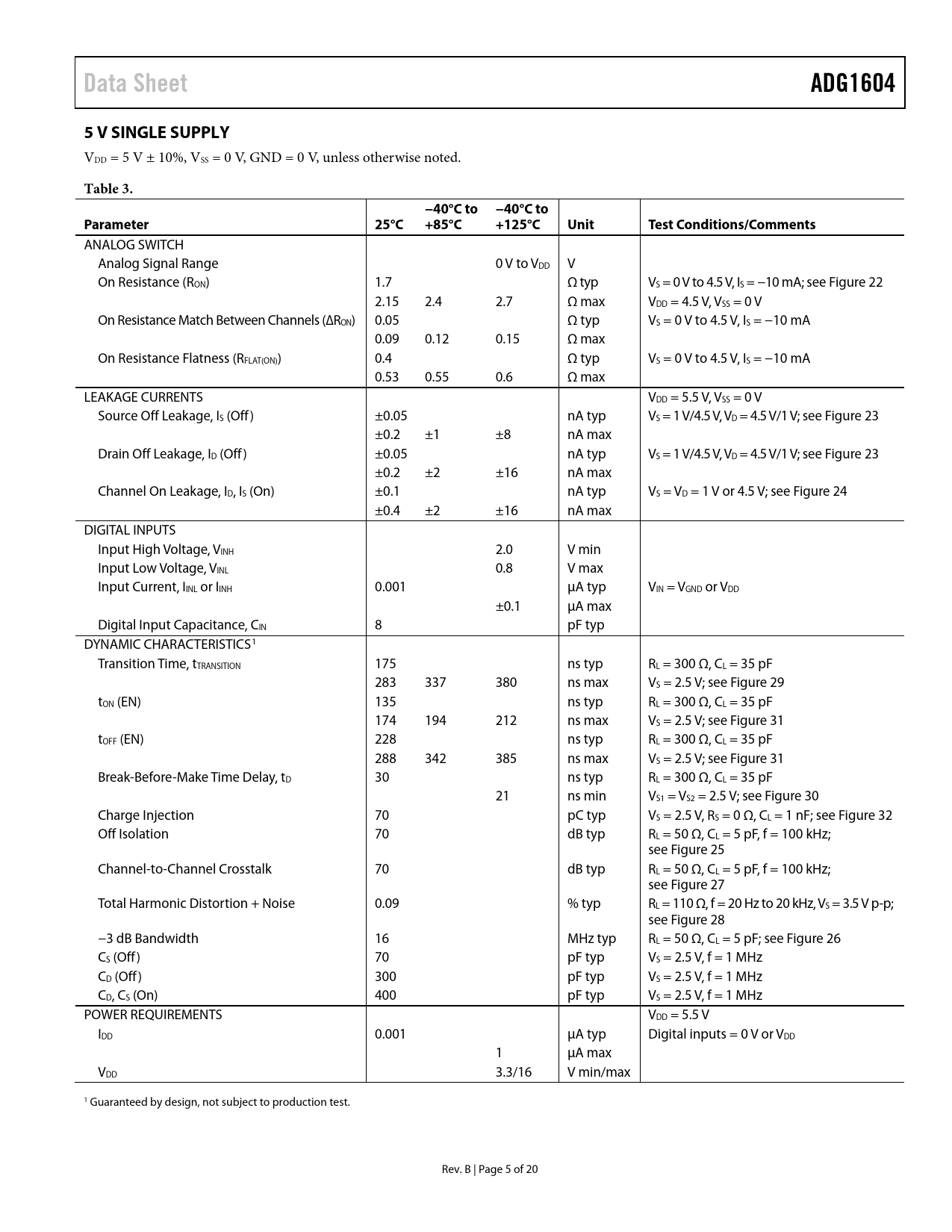

VDD = 5 V ± 10%, VSS = 0 V, GND = 0 V, unless otherwise noted.
Table 3. −40°C to −40°C to Parameter 25°C +85°C +125°C Unit Test Conditions/Comments
ANALOG SWITCH Analog Signal Range 0 V to VDD V On Resistance (RON) 1.7 Ω typ VS = 0 V to 4.5 V, IS = −10 mA; see Figure 22 2.15 2.4 2.7 Ω max VDD = 4.5 V, VSS = 0 V On Resistance Match Between Channels (∆RON) 0.05 Ω typ VS = 0 V to 4.5 V, IS = −10 mA 0.09 0.12 0.15 Ω max On Resistance Flatness (RFLAT(ON)) 0.4 Ω typ VS = 0 V to 4.5 V, IS = −10 mA 0.53 0.55 0.6 Ω max LEAKAGE CURRENTS VDD = 5.5 V, VSS = 0 V Source Off Leakage, IS (Off) ±0.05 nA typ VS = 1 V/4.5 V, VD = 4.5 V/1 V; see Figure 23 ±0.2 ±1 ±8 nA max Drain Off Leakage, ID (Off) ±0.05 nA typ VS = 1 V/4.5 V, VD = 4.5 V/1 V; see Figure 23 ±0.2 ±2 ±16 nA max Channel On Leakage, ID, IS (On) ±0.1 nA typ VS = VD = 1 V or 4.5 V; see Figure 24 ±0.4 ±2 ±16 nA max DIGITAL INPUTS Input High Voltage, VINH 2.0 V min Input Low Voltage, VINL 0.8 V max Input Current, IINL or IINH 0.001 µA typ VIN = VGND or VDD ±0.1 µA max Digital Input Capacitance, CIN 8 pF typ DYNAMIC CHARACTERISTICS1 Transition Time, tTRANSITION 175 ns typ RL = 300 Ω, CL = 35 pF 283 337 380 ns max VS = 2.5 V; see Figure 29 tON (EN) 135 ns typ RL = 300 Ω, CL = 35 pF 174 194 212 ns max VS = 2.5 V; see Figure 31 tOFF (EN) 228 ns typ RL = 300 Ω, CL = 35 pF 288 342 385 ns max VS = 2.5 V; see Figure 31 Break-Before-Make Time Delay, tD 30 ns typ RL = 300 Ω, CL = 35 pF 21 ns min VS1 = VS2 = 2.5 V; see Figure 30 Charge Injection 70 pC typ VS = 2.5 V, RS = 0 Ω, CL = 1 nF; see Figure 32 Off Isolation 70 dB typ RL = 50 Ω, CL = 5 pF, f = 100 kHz; see Figure 25 Channel-to-Channel Crosstalk 70 dB typ RL = 50 Ω, CL = 5 pF, f = 100 kHz; see Figure 27 Total Harmonic Distortion + Noise 0.09 % typ RL = 110 Ω, f = 20 Hz to 20 kHz, VS = 3.5 V p-p; see Figure 28 −3 dB Bandwidth 16 MHz typ RL = 50 Ω, CL = 5 pF; see Figure 26 CS (Off) 70 pF typ VS = 2.5 V, f = 1 MHz CD (Off) 300 pF typ VS = 2.5 V, f = 1 MHz CD, CS (On) 400 pF typ VS = 2.5 V, f = 1 MHz POWER REQUIREMENTS VDD = 5.5 V IDD 0.001 µA typ Digital inputs = 0 V or VDD 1 µA max VDD 3.3/16 V min/max 1 Guaranteed by design, not subject to production test. Rev. B | Page 5 of 20 Document Outline FEATURES APPLICATIONS FUNCTIONAL BLOCK DIAGRAM GENERAL DESCRIPTION PRODUCT HIGHLIGHTS TABLE OF CONTENTS REVISION HISTORY SPECIFICATIONS ±5 V DUAL SUPPLY 12 V SINGLE SUPPLY 5 V SINGLE SUPPLY 3.3 V SINGLE SUPPLY CONTINUOUS CURRENT PER CHANNEL, S OR D ABSOLUTE MAXIMUM RATINGS ESD CAUTION PIN CONFIGURATIONS AND FUNCTION DESCRIPTIONS TYPICAL PERFORMANCE CHARACTERISTICS TEST CIRCUITS TERMINOLOGY OUTLINE DIMENSIONS ORDERING GUIDE
