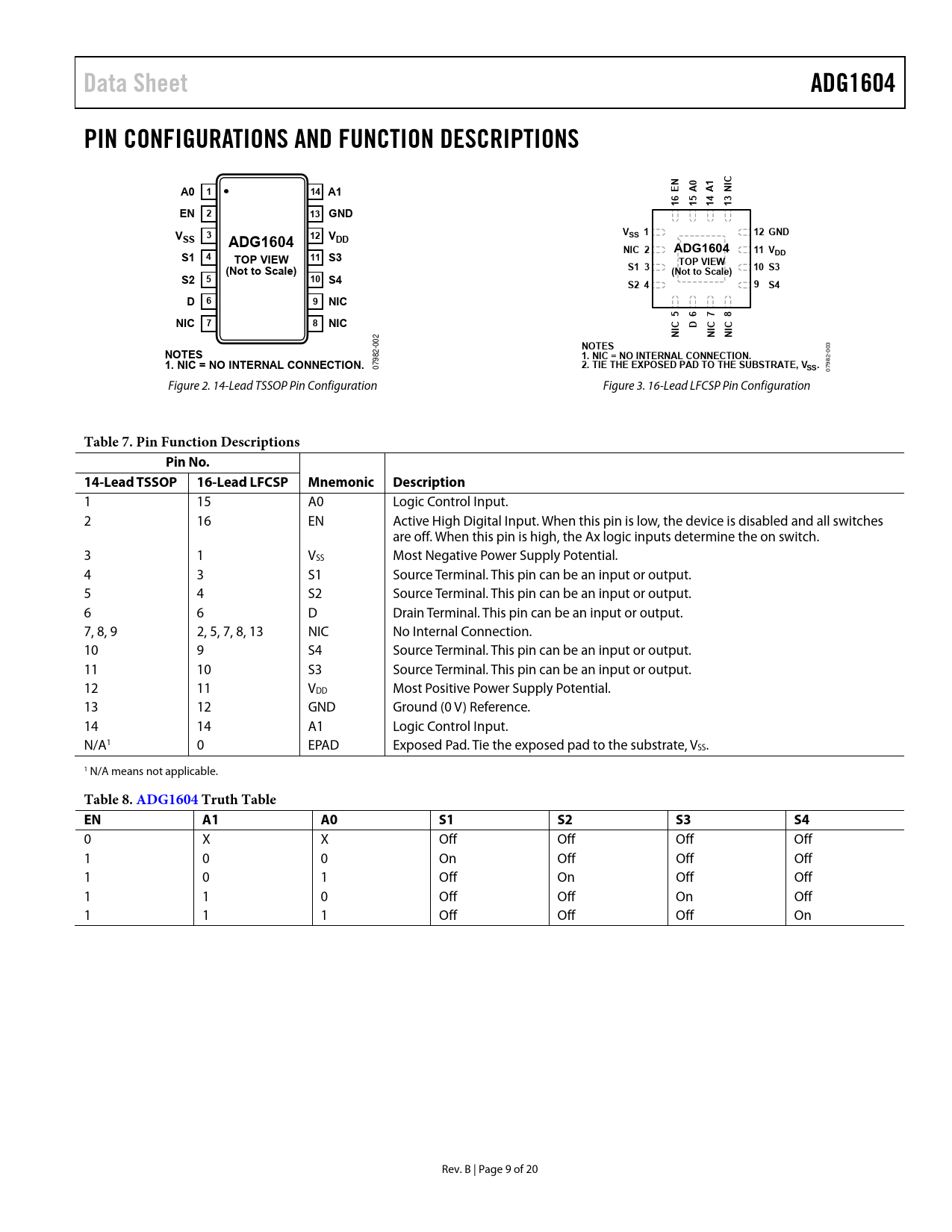

Data Sheet. ADG1604. PIN CONFIGURATIONS AND FUNCTION DESCRIPTIONS. A0 1. 14 A1. EN 2. 13 GND. 12 GND. ADG1604 12 VDD. NIC 2. 11 V. S1 4
Data Sheet ADG1604 PIN CONFIGURATIONS AND FUNCTION DESCRIPTIONS A0 1 14 A1 EN 2 13 GND 12 GND ADG1604 12 VDD NIC 2 11 V S1 4
Data Sheet ADG1604 PIN CONFIGURATIONS AND FUNCTION DESCRIPTIONS C A0 1 14 A1 EN A0 A1 NI 61 51 41 31 EN 2 13 GND V 3 V 1 12 GND SS ADG1604 12 VDD SS NIC 2 ADG1604 11 V S1 4 11 DD TOP VIEW S3 TOP VIEW (Not to Scale) S1 3 10 S3 (Not to Scale) S2 5 10 S4 S2 4 9 S4 D 6 9 NIC 5 6 7 8 NIC 7 8 NIC C D C C NI NI NI
002
NOTES NOTES
003 82-
1. NIC = NO INTERNAL CONNECTION. 1. NIC = NO INTERNAL CONNECTION.
82- 079
2. TIE THE EXPOSED PAD TO THE SUBSTRATE, VSS.
079 Figure 2. 14-Lead TSSOP Pin Configuration Figure 3. 16-Lead LFCSP Pin Configuration
Table 7. Pin Function Descriptions Pin No. 14-Lead TSSOP 16-Lead LFCSP Mnemonic Description
1 15 A0 Logic Control Input. 2 16 EN Active High Digital Input. When this pin is low, the device is disabled and all switches are off. When this pin is high, the Ax logic inputs determine the on switch. 3 1 VSS Most Negative Power Supply Potential. 4 3 S1 Source Terminal. This pin can be an input or output. 5 4 S2 Source Terminal. This pin can be an input or output. 6 6 D Drain Terminal. This pin can be an input or output. 7, 8, 9 2, 5, 7, 8, 13 NIC No Internal Connection. 10 9 S4 Source Terminal. This pin can be an input or output. 11 10 S3 Source Terminal. This pin can be an input or output. 12 11 VDD Most Positive Power Supply Potential. 13 12 GND Ground (0 V) Reference. 14 14 A1 Logic Control Input. N/A1 0 EPAD Exposed Pad. Tie the exposed pad to the substrate, VSS. 1 N/A means not applicable.
Table 8. ADG1604 Truth Table EN A1 A0 S1 S2 S3 S4
0 X X Off Off Off Off 1 0 0 On Off Off Off 1 0 1 Off On Off Off 1 1 0 Off Off On Off 1 1 1 Off Off Off On Rev. B | Page 9 of 20 Document Outline FEATURES APPLICATIONS FUNCTIONAL BLOCK DIAGRAM GENERAL DESCRIPTION PRODUCT HIGHLIGHTS TABLE OF CONTENTS REVISION HISTORY SPECIFICATIONS ±5 V DUAL SUPPLY 12 V SINGLE SUPPLY 5 V SINGLE SUPPLY 3.3 V SINGLE SUPPLY CONTINUOUS CURRENT PER CHANNEL, S OR D ABSOLUTE MAXIMUM RATINGS ESD CAUTION PIN CONFIGURATIONS AND FUNCTION DESCRIPTIONS TYPICAL PERFORMANCE CHARACTERISTICS TEST CIRCUITS TERMINOLOGY OUTLINE DIMENSIONS ORDERING GUIDE
