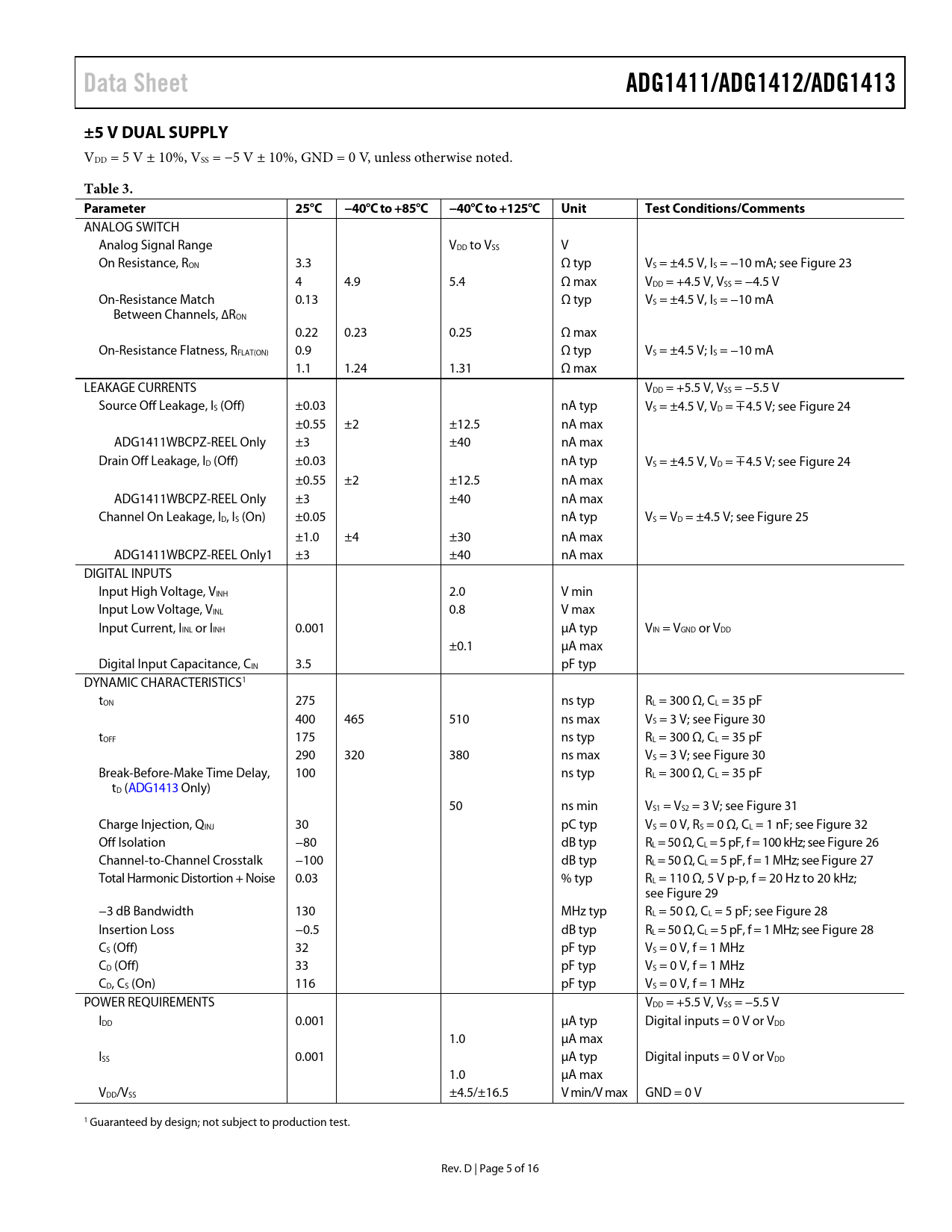

Data Sheet. ADG1411/ADG1412/ADG1413. ±5 V DUAL SUPPLY. Table 3. Parameter. 25°C. −40°C to +85°C. −40°C to +125°C. Unit
Data Sheet ADG1411/ADG1412/ADG1413 ±5 V DUAL SUPPLY Table 3 Parameter 25°C −40°C to +85°C −40°C to +125°C Unit
link to page 13 link to page 13 link to page 13 link to page 13 link to page 14 link to page 14 link to page 14 link to page 14 link to page 13 link to page 13 link to page 14 link to page 13 link to page 13
VDD = 5 V ± 10%, VSS = −5 V ± 10%, GND = 0 V, unless otherwise noted.
Table 3. Parameter 25°C −40°C to +85°C −40°C to +125°C Unit Test Conditions/Comments
ANALOG SWITCH Analog Signal Range VDD to VSS V On Resistance, RON 3.3 Ω typ VS = ±4.5 V, IS = −10 mA; see Figure 23 4 4.9 5.4 Ω max VDD = +4.5 V, VSS = −4.5 V On-Resistance Match 0.13 Ω typ VS = ±4.5 V, IS = −10 mA Between Channels, ∆RON 0.22 0.23 0.25 Ω max On-Resistance Flatness, RFLAT(ON) 0.9 Ω typ VS = ±4.5 V; IS = −10 mA 1.1 1.24 1.31 Ω max LEAKAGE CURRENTS VDD = +5.5 V, VSS = −5.5 V Source Off Leakage, IS (Off) ±0.03 nA typ VS = ±4.5 V, VD = ∓4.5 V; see Figure 24 ±0.55 ±2 ±12.5 nA max ADG1411WBCPZ-REEL Only ±3 ±40 nA max Drain Off Leakage, ID (Off) ±0.03 nA typ VS = ±4.5 V, VD = ∓4.5 V; see Figure 24 ±0.55 ±2 ±12.5 nA max ADG1411WBCPZ-REEL Only ±3 ±40 nA max Channel On Leakage, ID, IS (On) ±0.05 nA typ VS = VD = ±4.5 V; see Figure 25 ±1.0 ±4 ±30 nA max ADG1411WBCPZ-REEL Only1 ±3 ±40 nA max DIGITAL INPUTS Input High Voltage, VINH 2.0 V min Input Low Voltage, VINL 0.8 V max Input Current, IINL or IINH 0.001 µA typ VIN = VGND or VDD ±0.1 µA max Digital Input Capacitance, CIN 3.5 pF typ DYNAMIC CHARACTERISTICS1 tON 275 ns typ RL = 300 Ω, CL = 35 pF 400 465 510 ns max VS = 3 V; see Figure 30 tOFF 175 ns typ RL = 300 Ω, CL = 35 pF 290 320 380 ns max VS = 3 V; see Figure 30 Break-Before-Make Time Delay, 100 ns typ RL = 300 Ω, CL = 35 pF tD (ADG1413 Only) 50 ns min VS1 = VS2 = 3 V; see Figure 31 Charge Injection, QINJ 30 pC typ VS = 0 V, RS = 0 Ω, CL = 1 nF; see Figure 32 Off Isolation −80 dB typ RL = 50 Ω, CL = 5 pF, f = 100 kHz; see Figure 26 Channel-to-Channel Crosstalk −100 dB typ RL = 50 Ω, CL = 5 pF, f = 1 MHz; see Figure 27 Total Harmonic Distortion + Noise 0.03 % typ RL = 110 Ω, 5 V p-p, f = 20 Hz to 20 kHz; see Figure 29 −3 dB Bandwidth 130 MHz typ RL = 50 Ω, CL = 5 pF; see Figure 28 Insertion Loss −0.5 dB typ RL = 50 Ω, CL = 5 pF, f = 1 MHz; see Figure 28 CS (Off) 32 pF typ VS = 0 V, f = 1 MHz CD (Off) 33 pF typ VS = 0 V, f = 1 MHz CD, CS (On) 116 pF typ VS = 0 V, f = 1 MHz POWER REQUIREMENTS VDD = +5.5 V, VSS = −5.5 V IDD 0.001 µA typ Digital inputs = 0 V or VDD 1.0 µA max ISS 0.001 µA typ Digital inputs = 0 V or VDD 1.0 µA max VDD/VSS ±4.5/±16.5 V min/V max GND = 0 V 1 Guaranteed by design; not subject to production test. Rev. D | Page 5 of 16 Document Outline FEATURES APPLICATIONS FUNCTIONAL BLOCK DIAGRAM GENERAL DESCRIPTION PRODUCT HIGHLIGHTS TABLE OF CONTENTS REVISION HISTORY SPECIFICATIONS ±15 V DUAL SUPPLY +12 V SINGLE SUPPLY ±5 V DUAL SUPPLY ABSOLUTE MAXIMUM RATINGS ESD CAUTION PIN CONFIGURATIONS AND FUNCTION DESCRIPTIONS TYPICAL PERFORMANCE CHARACTERISTICS TERMINOLOGY TEST CIRCUITS OUTLINE DIMENSIONS ORDERING GUIDE AUTOMOTIVE PRODUCTS
