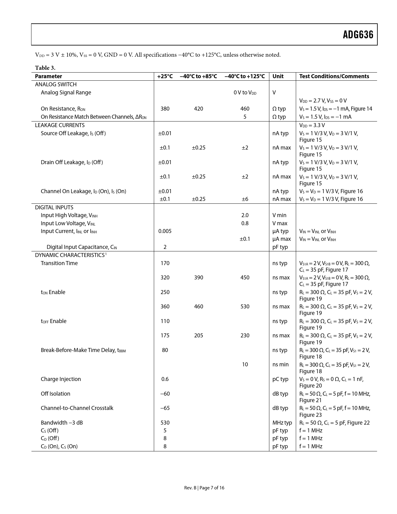

VDD = 3 V ± 10%, VSS = 0 V, GND = 0 V. All specifications −40°C to +125°C, unless otherwise noted.
Table 3. Parameter +25°C −40°C to +85°C −40°C to +125°C Unit Test Conditions/Comments
ANALOG SWITCH Analog Signal Range 0 V to VDD V VDD = 2.7 V, VSS = 0 V On Resistance, RON 380 420 460 Ω typ VS = 1.5 V, IDS = −1 mA, Figure 14 On Resistance Match Between Channels, ΔRON 5 Ω typ VS = 1.5 V, IDS = −1 mA LEAKAGE CURRENTS VDD = 3.3 V Source Off Leakage, IS (Off ) ±0.01 nA typ VS = 1 V/3 V, VD = 3 V/1 V, Figure 15 ±0.1 ±0.25 ±2 nA max VS = 1 V/3 V, VD = 3 V/1 V, Figure 15 Drain Off Leakage, ID (Off ) ±0.01 nA typ VS = 1 V/3 V, VD = 3 V/1 V, Figure 15 ±0.1 ±0.25 ±2 nA max VS = 1 V/3 V, VD = 3 V/1 V, Figure 15 Channel On Leakage, ID (On), IS (On) ±0.01 nA typ VS = VD = 1 V/3 V, Figure 16 ±0.1 ±0.25 ±6 nA max VS = VD = 1 V/3 V, Figure 16 DIGITAL INPUTS Input High Voltage, VINH 2.0 V min Input Low Voltage, VINL 0.8 V max Input Current, IINL or IINH 0.005 μA typ VIN = VINL or VINH ±0.1 μA max VIN = VINL or VINH Digital Input Capacitance, CIN 2 pF typ DYNAMIC CHARACTERISTICS1 Transition Time 170 ns typ VS1A = 2 V, VS1B = 0 V, RL = 300 Ω, CL = 35 pF, Figure 17 320 390 450 ns max VS1A = 2 V, VS1B = 0 V, RL = 300 Ω, CL = 35 pF, Figure 17 tON Enable 250 ns typ RL = 300 Ω, CL = 35 pF, VS = 2 V, Figure 19 360 460 530 ns max RL = 300 Ω, CL = 35 pF, VS = 2 V, Figure 19 tOFF Enable 110 ns typ RL = 300 Ω, CL = 35 pF, VS = 2 V, Figure 19 175 205 230 ns max RL = 300 Ω, CL = 35 pF, VS = 2 V, Figure 19 Break-Before-Make Time Delay, tBBM 80 ns typ RL = 300 Ω, CL = 35 pF, VS1 = 2 V, Figure 18 10 ns min RL = 300 Ω, CL = 35 pF, VS1 = 2 V, Figure 18 Charge Injection 0.6 pC typ VS = 0 V, RS = 0 Ω, CL = 1 nF, Figure 20 Off Isolation −60 dB typ RL = 50 Ω, CL = 5 pF, f = 10 MHz, Figure 21 Channel-to-Channel Crosstalk −65 dB typ RL = 50 Ω, CL = 5 pF, f = 10 MHz, Figure 23 Bandwidth −3 dB 530 MHz typ RL = 50 Ω, CL = 5 pF, Figure 22 CS (Off ) 5 pF typ f = 1 MHz CD (Off ) 8 pF typ f = 1 MHz CD (On), CS (On) 8 pF typ f = 1 MHz Rev. B | Page 7 of 16 Document Outline FEATURES APPLICATIONS FUNCTIONAL BLOCK DIAGRAM GENERAL DESCRIPTION PRODUCT HIGHLIGHTS TABLE OF CONTENTS REVISION HISTORY SPECIFICATIONS DUAL SUPPLY SINGLE SUPPLY ABSOLUTE MAXIMUM RATINGS ESD CAUTION PIN CONFIGURATION AND FUNCTION DESCRIPTIONS TYPICAL PERFORMANCE CHARACTERISTICS TEST CIRCUITS TERMINOLOGY OUTLINE DIMENSIONS ORDERING GUIDE
