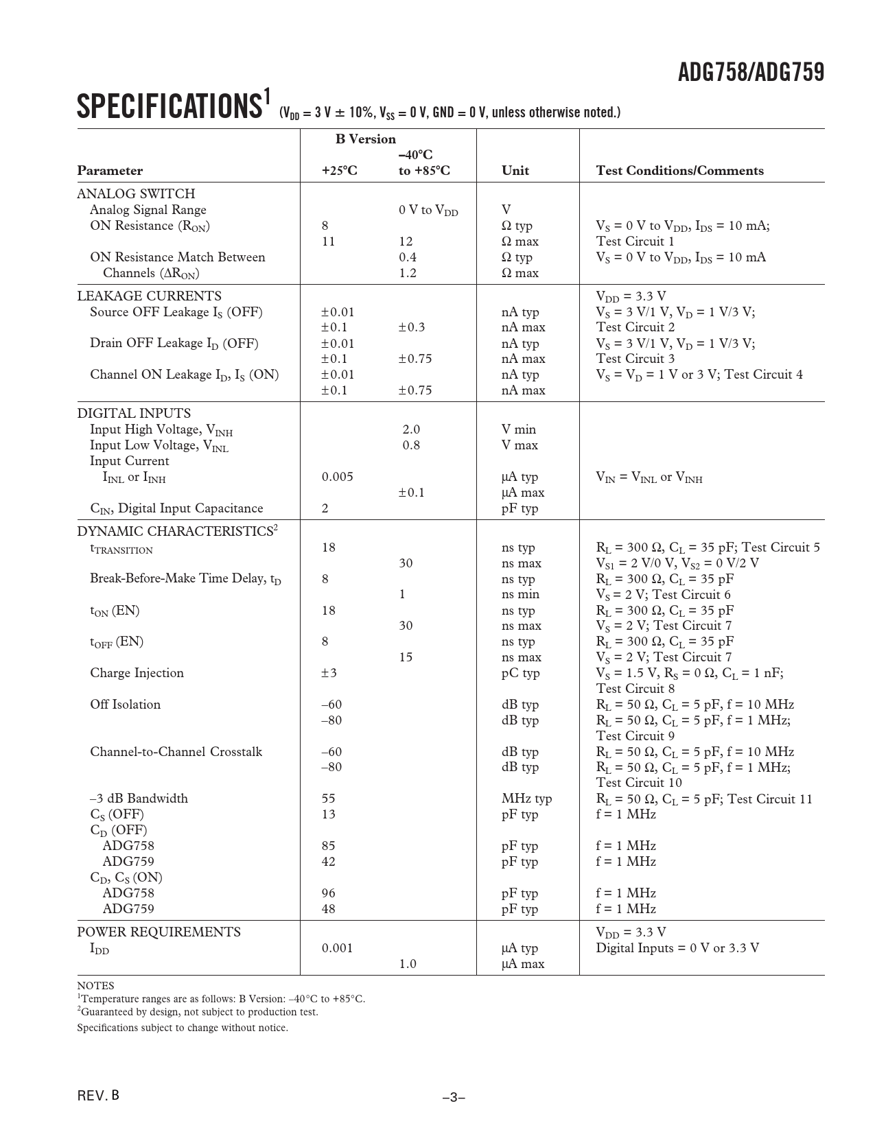

ADG758/ADG759. SPECIFICATIONS1 (VDD = 3 V. 10%, VSS = 0 V, GND = 0 V, unless otherwise noted.). B Version. –40. Parameter. +25
ADG758/ADG759 SPECIFICATIONS1 (VDD = 3 V 10%, VSS = 0 V, GND = 0 V, unless otherwise noted.) B Version –40 Parameter +25
ADG758/ADG759 SPECIFICATIONS1 (VDD = 3 V 10%, VSS = 0 V, GND = 0 V, unless otherwise noted.) B Version –40 C Parameter +25 C to +85 C Unit Test Conditions/Comments
ANALOG SWITCH Analog Signal Range 0 V to VDD V ON Resistance (RON) 8 Ω typ VS = 0 V to VDD, IDS = 10 mA; 11 12 Ω max Test Circuit 1 ON Resistance Match Between 0.4 Ω typ VS = 0 V to VDD, IDS = 10 mA Channels (∆RON) 1.2 Ω max LEAKAGE CURRENTS VDD = 3.3 V Source OFF Leakage IS (OFF) ±0.01 nA typ VS = 3 V/1 V, VD = 1 V/3 V; ±0.1 ±0.3 nA max Test Circuit 2 Drain OFF Leakage ID (OFF) ±0.01 nA typ VS = 3 V/1 V, VD = 1 V/3 V; ±0.1 ±0.75 nA max Test Circuit 3 Channel ON Leakage ID, IS (ON) ±0.01 nA typ VS = VD = 1 V or 3 V; Test Circuit 4 ±0.1 ±0.75 nA max DIGITAL INPUTS Input High Voltage, VINH 2.0 V min Input Low Voltage, VINL 0.8 V max Input Current IINL or IINH 0.005 µA typ VIN = VINL or VINH ±0.1 µA max CIN, Digital Input Capacitance 2 pF typ DYNAMIC CHARACTERISTICS2 tTRANSITION 18 ns typ RL = 300 Ω, CL = 35 pF; Test Circuit 5 30 ns max VS1 = 2 V/0 V, VS2 = 0 V/2 V Break-Before-Make Time Delay, tD 8 ns typ RL = 300 Ω, CL = 35 pF 1 ns min VS = 2 V; Test Circuit 6 tON (EN) 18 ns typ RL = 300 Ω, CL = 35 pF 30 ns max VS = 2 V; Test Circuit 7 tOFF (EN) 8 ns typ RL = 300 Ω, CL = 35 pF 15 ns max VS = 2 V; Test Circuit 7 Charge Injection ±3 pC typ VS = 1.5 V, RS = 0 Ω, CL = 1 nF; Test Circuit 8 Off Isolation –60 dB typ RL = 50 Ω, CL = 5 pF, f = 10 MHz –80 dB typ RL = 50 Ω, CL = 5 pF, f = 1 MHz; Test Circuit 9 Channel-to-Channel Crosstalk –60 dB typ RL = 50 Ω, CL = 5 pF, f = 10 MHz –80 dB typ RL = 50 Ω, CL = 5 pF, f = 1 MHz; Test Circuit 10 –3 dB Bandwidth 55 MHz typ RL = 50 Ω, CL = 5 pF; Test Circuit 11 CS (OFF) 13 pF typ f = 1 MHz CD (OFF) ADG758 85 pF typ f = 1 MHz ADG759 42 pF typ f = 1 MHz CD, CS (ON) ADG758 96 pF typ f = 1 MHz ADG759 48 pF typ f = 1 MHz POWER REQUIREMENTS VDD = 3.3 V IDD 0.001 µA typ Digital Inputs = 0 V or 3.3 V 1.0 µA max NOTES 1Temperature ranges are as follows: B Version: –40°C to +85°C. 2Guaranteed by design, not subject to production test. Specifications subject to change without notice. REV. B –3–
