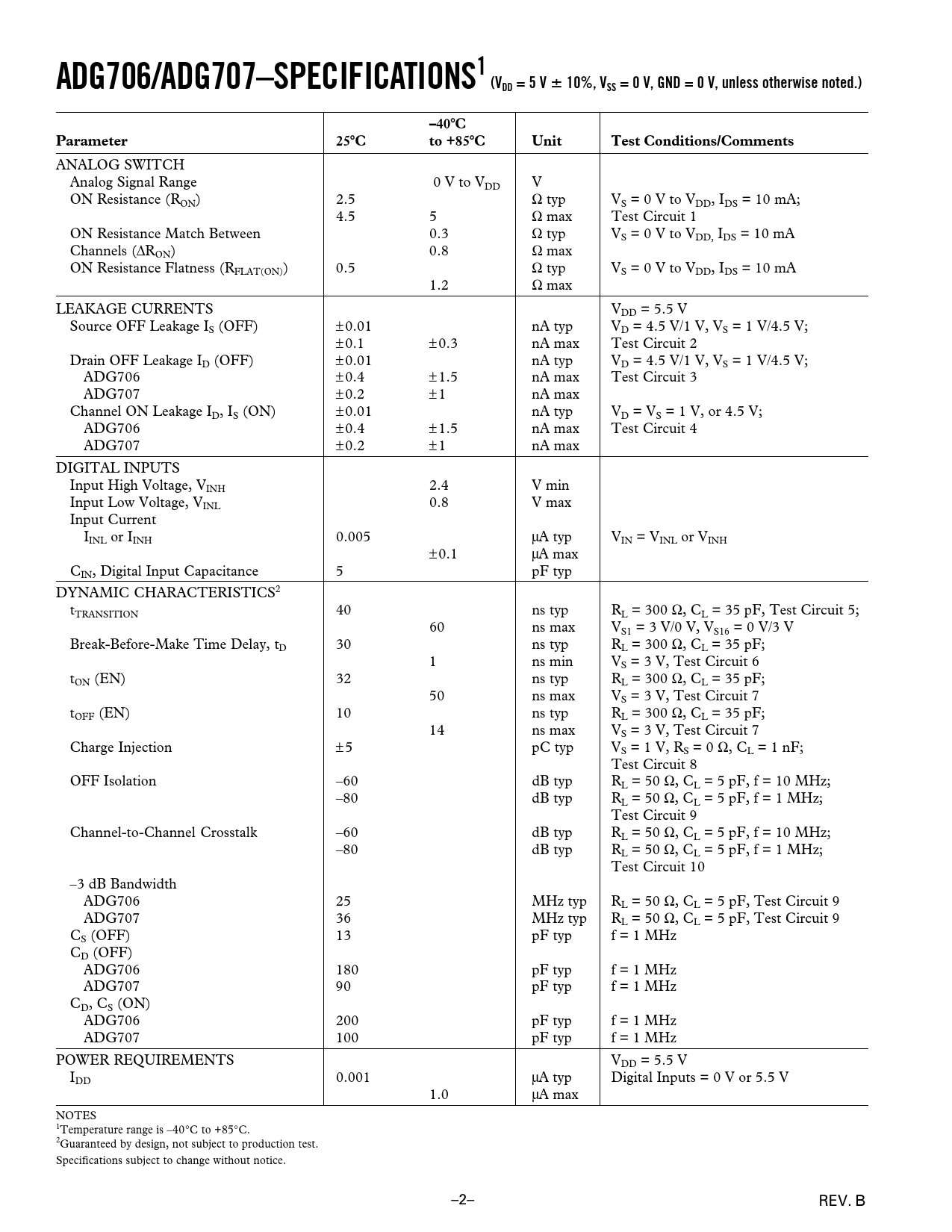

ADG706/ADG707–SPECIFICATIONS1 (VDD = 5 V. 10%, VSS = 0 V, GND = 0 V, unless otherwise noted.). –40. Parameter. to +85. Unit
ADG706/ADG707–SPECIFICATIONS1 (VDD = 5 V 10%, VSS = 0 V, GND = 0 V, unless otherwise noted.) –40 Parameter to +85 Unit
C Parameter 25
C to +85
C Unit Test Conditions/Comments
ANALOG SWITCH Analog Signal Range 0 V to VDD V ON Resistance (RON) 2.5 Ω typ VS = 0 V to VDD, IDS = 10 mA; 4.5 5 Ω max Test Circuit 1 ON Resistance Match Between 0.3 Ω typ VS = 0 V to VDD, IDS = 10 mA Channels (∆RON) 0.8 Ω max ON Resistance Flatness (RFLAT(ON)) 0.5 Ω typ VS = 0 V to VDD, IDS = 10 mA 1.2 Ω max LEAKAGE CURRENTS VDD = 5.5 V Source OFF Leakage IS (OFF) ±0.01 nA typ VD = 4.5 V/1 V, VS = 1 V/4.5 V; ±0.1 ±0.3 nA max Test Circuit 2 Drain OFF Leakage ID (OFF) ±0.01 nA typ VD = 4.5 V/1 V, VS = 1 V/4.5 V; ADG706 ±0.4 ±1.5 nA max Test Circuit 3 ADG707 ±0.2 ±1 nA max Channel ON Leakage ID, IS (ON) ±0.01 nA typ VD = VS = 1 V, or 4.5 V; ADG706 ±0.4 ±1.5 nA max Test Circuit 4 ADG707 ±0.2 ±1 nA max DIGITAL INPUTS Input High Voltage, VINH 2.4 V min Input Low Voltage, VINL 0.8 V max Input Current IINL or IINH 0.005 µA typ VIN = VINL or VINH ±0.1 µA max CIN, Digital Input Capacitance 5 pF typ DYNAMIC CHARACTERISTICS2 tTRANSITION 40 ns typ RL = 300 Ω, CL = 35 pF, Test Circuit 5; 60 ns max VS1 = 3 V/0 V, VS16 = 0 V/3 V Break-Before-Make Time Delay, tD 30 ns typ RL = 300 Ω, CL = 35 pF; 1 ns min VS = 3 V, Test Circuit 6 tON (EN) 32 ns typ RL = 300 Ω, CL = 35 pF; 50 ns max VS = 3 V, Test Circuit 7 tOFF (EN) 10 ns typ RL = 300 Ω, CL = 35 pF; 14 ns max VS = 3 V, Test Circuit 7 Charge Injection ±5 pC typ VS = 1 V, RS = 0 Ω, CL = 1 nF; Test Circuit 8 OFF Isolation –60 dB typ RL = 50 Ω, CL = 5 pF, f = 10 MHz; –80 dB typ RL = 50 Ω, CL = 5 pF, f = 1 MHz; Test Circuit 9 Channel-to-Channel Crosstalk –60 dB typ RL = 50 Ω, CL = 5 pF, f = 10 MHz; –80 dB typ RL = 50 Ω, CL = 5 pF, f = 1 MHz; Test Circuit 10 –3 dB Bandwidth ADG706 25 MHz typ RL = 50 Ω, CL = 5 pF, Test Circuit 9 ADG707 36 MHz typ RL = 50 Ω, CL = 5 pF, Test Circuit 9 CS (OFF) 13 pF typ f = 1 MHz CD (OFF) ADG706 180 pF typ f = 1 MHz ADG707 90 pF typ f = 1 MHz CD, CS (ON) ADG706 200 pF typ f = 1 MHz ADG707 100 pF typ f = 1 MHz POWER REQUIREMENTS VDD = 5.5 V IDD 0.001 µA typ Digital Inputs = 0 V or 5.5 V 1.0 µA max NOTES 1Temperature range is –40°C to +85°C. 2Guaranteed by design, not subject to production test. Specifications subject to change without notice. –2– REV. B
