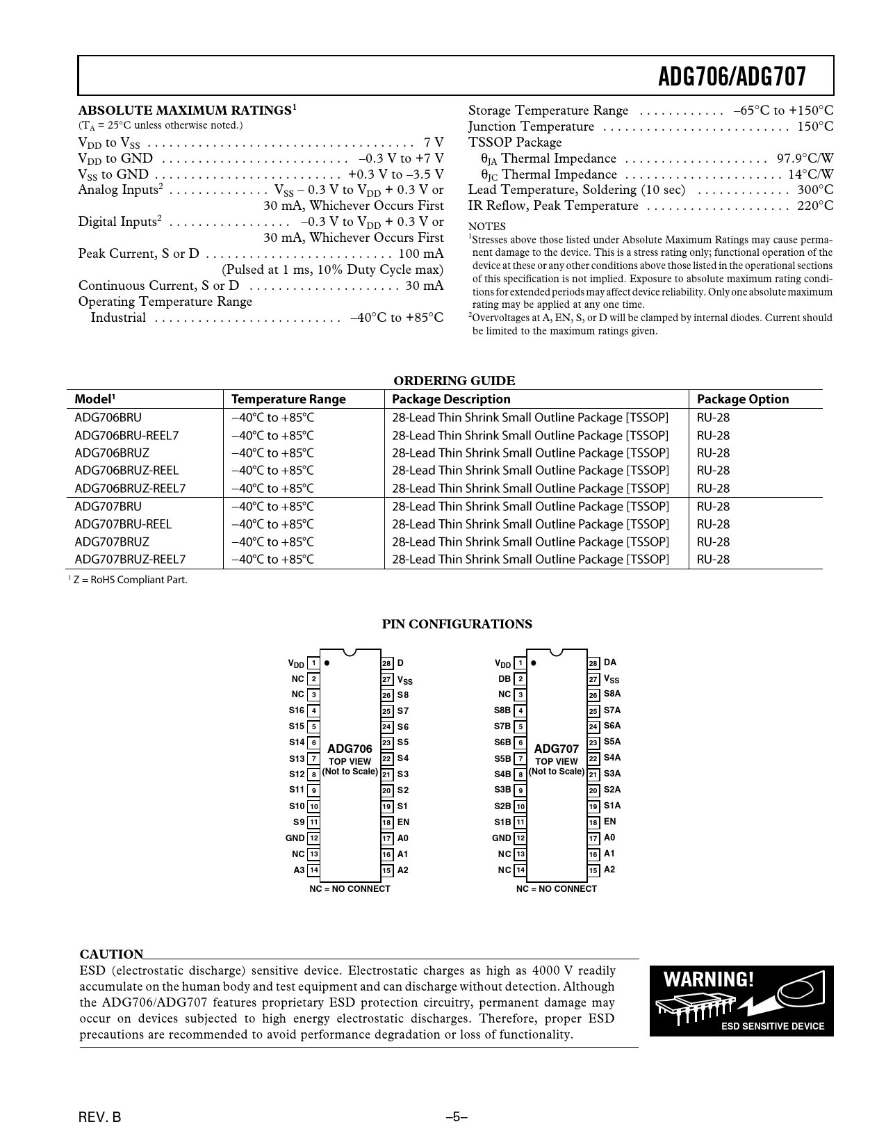

ADG706/ADG707 ABSOLUTE MAXIMUM RATINGS1
Storage Temperature Range . –65°C to +150°C (TA = 25°C unless otherwise noted.) Junction Temperature . 150°C VDD to VSS . 7 V TSSOP Package VDD to GND . –0.3 V to +7 V θJA Thermal Impedance . 97.9°C/W V θ SS to GND . +0.3 V to –3.5 V JC Thermal Impedance . 14°C/W Analog Inputs2 . VSS – 0.3 V to VDD + 0.3 V or Lead Temperature, Soldering (10 sec) . 300°C 30 mA, Whichever Occurs First IR Reflow, Peak Temperature . 220°C Digital Inputs2 . –0.3 V to VDD + 0.3 V or NOTES 30 mA, Whichever Occurs First 1Stresses above those listed under Absolute Maximum Ratings may cause perma- Peak Current, S or D . 100 mA nent damage to the device. This is a stress rating only; functional operation of the (Pulsed at 1 ms, 10% Duty Cycle max) device at these or any other conditions above those listed in the operational sections of this specification is not implied. Exposure to absolute maximum rating condi- Continuous Current, S or D . 30 mA tions for extended periods may affect device reliability. Only one absolute maximum Operating Temperature Range rating may be applied at any one time. Industrial . –40°C to +85°C 2Overvoltages at A, EN, S, or D will be clamped by internal diodes. Current should be limited to the maximum ratings given.
ORDERING GUIDE
1 Z = RoHS Compliant Part.
PIN CONFIGURATIONS V 1 28 DA DD D V 1 28 DD NC 2 27 V V SS DB 2 27 SS NC 3 26 S8 NC 3 26 S8A S16 4 25 S7 S8B 4 25 S7A S15 5 24 S6 S7B 5 24 S6A S14 6 23 S5 S6B 6 23 S5A ADG706 ADG707 S13 7 S4A TOP VIEW 22 S4 S5B 7 TOP VIEW 22 (Not to Scale) S12 8 21 S3 (Not to Scale) S4B 8 21 S3A S11 9 20 S2 S3B 9 20 S2A S10 10 19 S1 S2B 10 19 S1A S9 11 18 EN S1B 11 18 EN GND 12 17 A0 GND 12 17 A0 NC 13 16 A1 NC 13 16 A1 A3 14 15 A2 NC 14 15 A2 NC = NO CONNECT NC = NO CONNECT CAUTION
