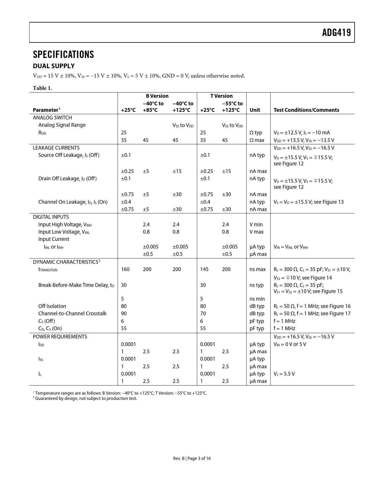

ADG419 SPECIFICATIONS DUAL SUPPLY
VDD = 15 V ± 10%, VSS = −15 V ± 10%, VL = 5 V ± 10%, GND = 0 V, unless otherwise noted.
Table 1. B Version T Version −40°C to −40°C to −55°C to Parameter1 +25° C +85°C +125°C +25°C +125°C Unit Test Conditions/Comments
ANALOG SWITCH
Analog Signal Range VSS to VDD VSS to VDD
RON 25 25 Ω typ VD = ±12.5 V, IS = −10 mA 35 45 45 35 45 Ω max VDD = +13.5 V, VSS = −13.5 V LEAKAGE CURRENTS VDD = +16.5 V, VSS = −16.5 V Source Off Leakage, IS (Off ) ±0.1 ±0.1 nA typ VD = ±15.5 V, VS = ∓15.5 V; see Figure 12 ±0.25 ±5 ±15 ±0.25 ±15 nA max Drain Off Leakage, ID (Off ) ±0.1 ±0.1 nA typ VD = ±15.5 V, VS = ∓15.5 V; see Figure 12 ±0.75 ±5 ±30 ±0.75 ±30 nA max Channel On Leakage, ID, IS (On) ±0.4 ±0.4 nA typ VS = VD = ±15.5 V; see Figure 13 ±0.75 ±5 ±30 ±0.75 ±30 nA max DIGITAL INPUTS Input High Voltage, VINH 2.4 2.4 2.4 V min Input Low Voltage, VINL 0.8 0.8 0.8 V max Input Current IINL or IINH ±0.005 ±0.005 ±0.005 μA typ VIN = VINL or VINH ±0.5 ±0.5 ±0.5 μA max DYNAMIC CHARACTERISTICS2 tTRANSITION 160 200 200 145 200 ns max RL = 300 Ω, CL = 35 pF; VS1 = ±10 V, VS2 = ∓10 V; see Figure 14 Break-Before-Make Time Delay, tD 30 30 ns typ RL = 300 Ω, CL = 35 pF; VS1 = VS2 = ±10 V; see Figure 15 5 5 ns min Off Isolation 80 80 dB typ RL = 50 Ω, f = 1 MHz; see Figure 16 Channel-to-Channel Crosstalk 90 70 dB typ RL = 50 Ω, f = 1 MHz; see Figure 17 CS (Off ) 6 6 pF typ f = 1 MHz CD, CS (On) 55 55 pF typ f = 1 MHz POWER REQUIREMENTS VDD = +16.5 V, VSS = −16.5 V IDD 0.0001 0.0001 μA typ VIN = 0 V or 5 V 1 2.5 2.5 1 2.5 μA max ISS 0.0001 0.0001 μA typ 1 2.5 2.5 1 2.5 μA max IL 0.0001 0.0001 μA typ VL = 5.5 V 1 2.5 2.5 1 2.5 μA max 1 Temperature ranges are as follows: B Version: −40°C to +125°C; T Version: −55°C to +125°C. 2 Guaranteed by design, not subject to production test. Rev. B | Page 3 of 16 Document Outline FEATURES APPLICATIONS GENERAL DESCRIPTION FUNCTIONAL BLOCK DIAGRAM PRODUCT HIGHLIGHTS TABLE OF CONTENTS REVISION HISTORY SPECIFICATIONS DUAL SUPPLY SINGLE SUPPLY ABSOLUTE MAXIMUM RATINGS ESD CAUTION PIN CONFIGURATION AND FUNCTION DESCRIPTIONS TYPICAL PERFORMANCE CHARACTERISTICS TEST CIRCUITS TERMINOLOGY OUTLINE DIMENSIONS ORDERING GUIDE
