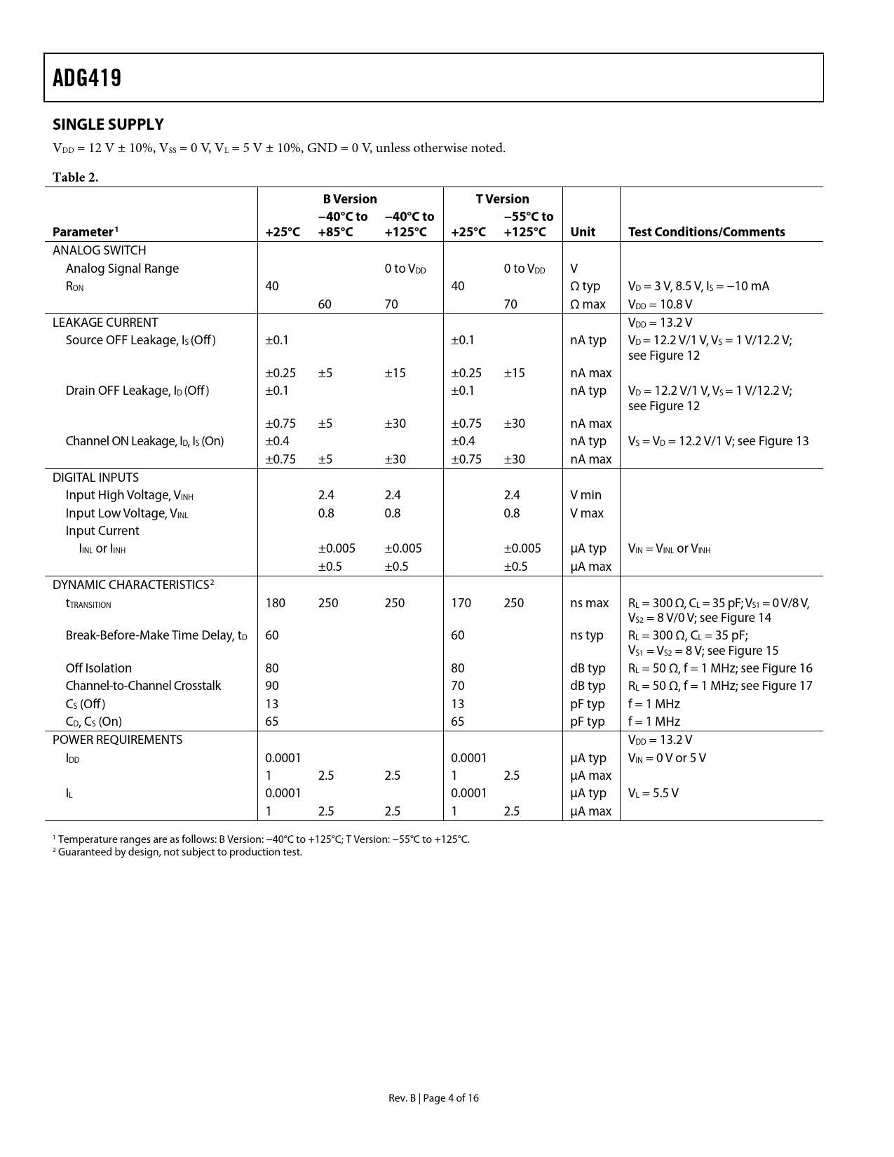

ADG419. SINGLE SUPPLY. Table 2. B Version. T Version. −40°C to. −55°C to. Parameter1. +25°C. +85°C. +125°C +25°C. +125°C. Unit
ADG419 SINGLE SUPPLY Table 2 B Version T Version −40°C to −55°C to Parameter1 +25°C +85°C +125°C +25°C +125°C Unit
link to page 4 link to page 9 link to page 9 link to page 9 link to page 4 link to page 9 link to page 9 link to page 10 link to page 10
VDD = 12 V ± 10%, VSS = 0 V, VL = 5 V ± 10%, GND = 0 V, unless otherwise noted.
Table 2. B Version T Version −40°C to −40°C to −55°C to Parameter1 +25°C +85°C +125°C +25°C +125°C Unit Test Conditions/Comments
ANALOG SWITCH Analog Signal Range 0 to VDD 0 to VDD V RON 40 40 Ω typ VD = 3 V, 8.5 V, IS = −10 mA 60 70 70 Ω max VDD = 10.8 V LEAKAGE CURRENT VDD = 13.2 V Source OFF Leakage, IS (Off ) ±0.1 ±0.1 nA typ VD = 12.2 V/1 V, VS = 1 V/12.2 V; see Figure 12 ±0.25 ±5 ±15 ±0.25 ±15 nA max Drain OFF Leakage, ID (Off ) ±0.1 ±0.1 nA typ VD = 12.2 V/1 V, VS = 1 V/12.2 V; see Figure 12 ±0.75 ±5 ±30 ±0.75 ±30 nA max Channel ON Leakage, ID, IS (On) ±0.4 ±0.4 nA typ VS = VD = 12.2 V/1 V; see Figure 13 ±0.75 ±5 ±30 ±0.75 ±30 nA max DIGITAL INPUTS Input High Voltage, VINH 2.4 2.4 2.4 V min Input Low Voltage, VINL 0.8 0.8 0.8 V max Input Current IINL or IINH ±0.005 ±0.005 ±0.005 μA typ VIN = VINL or VINH ±0.5 ±0.5 ±0.5 μA max DYNAMIC CHARACTERISTICS2 tTRANSITION 180 250 250 170 250 ns max RL = 300 Ω, CL = 35 pF; VS1 = 0 V/8 V, VS2 = 8 V/0 V; see Figure 14 Break-Before-Make Time Delay, tD 60 60 ns typ RL = 300 Ω, CL = 35 pF; VS1 = VS2 = 8 V; see Figure 15 Off Isolation 80 80 dB typ RL = 50 Ω, f = 1 MHz; see Figure 16 Channel-to-Channel Crosstalk 90 70 dB typ RL = 50 Ω, f = 1 MHz; see Figure 17 CS (Off ) 13 13 pF typ f = 1 MHz CD, CS (On) 65 65 pF typ f = 1 MHz POWER REQUIREMENTS VDD = 13.2 V IDD 0.0001 0.0001 μA typ VIN = 0 V or 5 V 1 2.5 2.5 1 2.5 μA max IL 0.0001 0.0001 μA typ VL = 5.5 V 1 2.5 2.5 1 2.5 μA max 1 Temperature ranges are as follows: B Version: −40°C to +125°C; T Version: −55°C to +125°C. 2 Guaranteed by design, not subject to production test.
