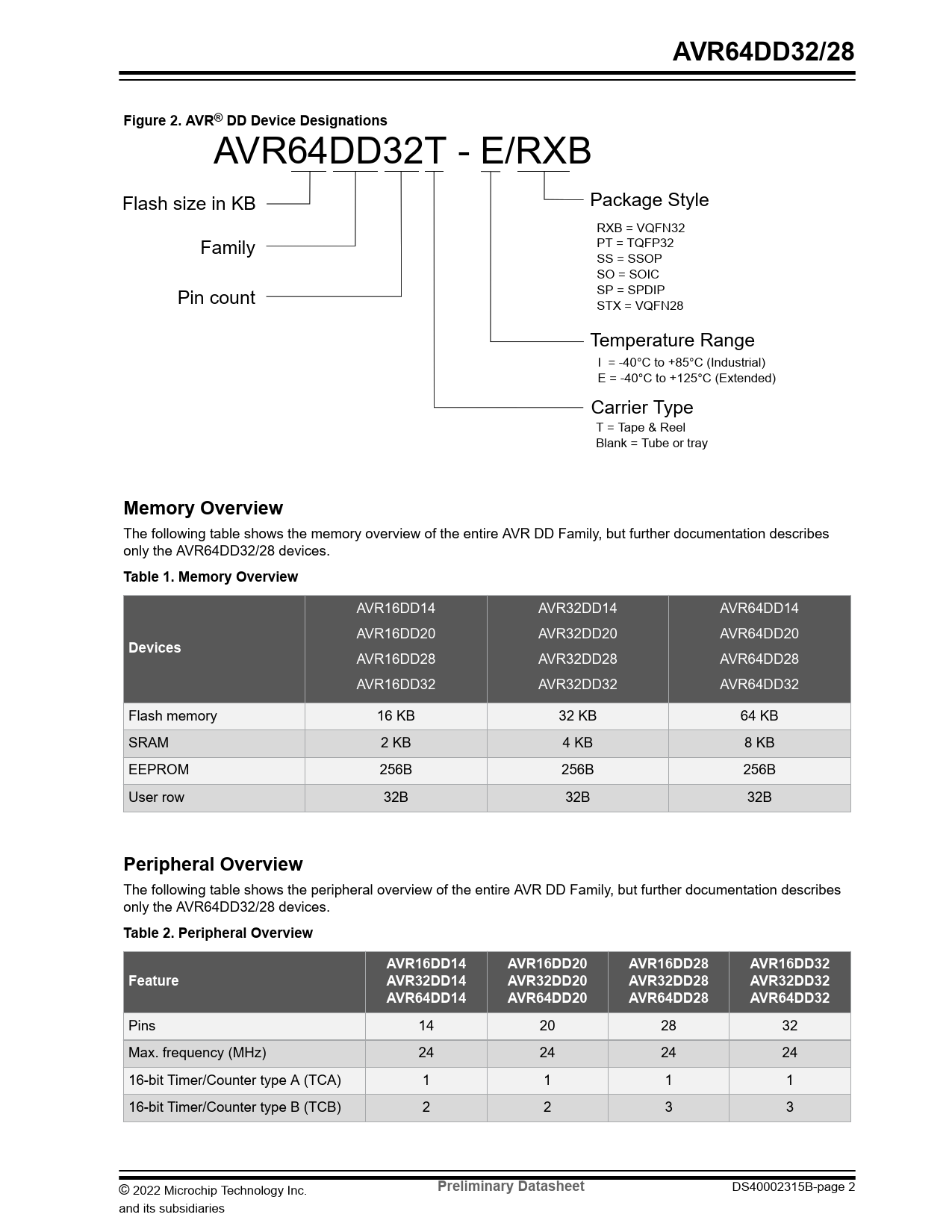

Pages / Page614 / 2 — AVR64DD32/28. Figure 2. AVR® DD Device Designations. Memory Overview. …
File Format / SizePDF / 7.8 Mb
AVR64DD32/28. Figure 2. AVR® DD Device Designations. Memory Overview. Table 1. Memory Overview. Devices. Peripheral Overview
AVR64DD32/28 Figure 2 AVR® DD Device Designations Memory Overview Table 1 Memory Overview Devices Peripheral Overview
AVR64DD32/28 Figure 2. AVR® DD Device Designations
AVR64DD32T - E/RXB Flash size in KB Package Style RXB = VQFN32 PT = TQFP32 Family SS = SSOP SO = SOIC SP = SPDIP Pin count STX = VQFN28 Temperature Range I = -40°C to +85°C (Industrial) E = -40°C to +125°C (Extended) Carrier Type T = Tape & Reel Blank = Tube or tray
Memory Overview
The following table shows the memory overview of the entire AVR DD Family, but further documentation describes only the AVR64DD32/28 devices.
AVR16DD14 AVR32DD14 AVR64DD14 AVR16DD20 AVR32DD20 AVR64DD20
AVR16DD28 AVR32DD28 AVR64DD28 AVR16DD32 AVR32DD32 AVR64DD32 Flash memory 16 KB 32 KB 64 KB SRAM 2 KB 4 KB 8 KB EEPROM 256B 256B 256B User row 32B 32B 32B
Peripheral Overview
The following table shows the peripheral overview of the entire AVR DD Family, but further documentation describes only the AVR64DD32/28 devices.
Table 2. Peripheral Overview AVR16DD14 AVR16DD20 AVR16DD28 AVR16DD32 Feature AVR32DD14 AVR32DD20 AVR32DD28 AVR32DD32 AVR64DD14 AVR64DD20 AVR64DD28 AVR64DD32
Pins 14 20 28 32 Max. frequency (MHz) 24 24 24 24 16-bit Timer/Counter type A (TCA) 1 1 1 1 16-bit Timer/Counter type B (TCB) 2 2 3 3 © 2022 Microchip Technology Inc.
