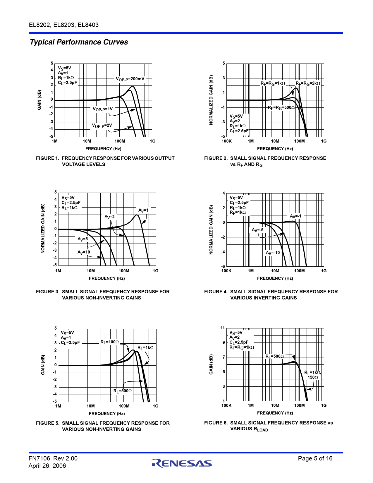

Pages / Page16 / 5 — Typical Performance Curves. VS=5V. AV=1. RL=1k. VOP-P=200mV. L=2.5pF. …
Typical Performance Curves. VS=5V. AV=1. RL=1k. VOP-P=200mV. L=2.5pF. F=RG=1k. F=RG=2k. dB) ( N. GAI. OP-P=1V. F=RG=500. AV=2. NORMALIZED GAIN (
Typical Performance Curves VS=5V AV=1 RL=1k VOP-P=200mV L=2.5pF F=RG=1k F=RG=2k dB) ( N GAI OP-P=1V F=RG=500 AV=2 NORMALIZED GAIN (
EL8202, EL8203, EL8403
Typical Performance Curves 5 5 VS=5V 4 AV=1 3 RL=1k VOP-P=200mV B) 3 C d L=2.5pF 2 R R F=RG=1k F=RG=2k 1 1 dB) ( N 0 -1 GAI V -1 R OP-P=1V F=RG=500 -2 VS=5V -3 -3 AV=2 V NORMALIZED GAIN ( R -4 OP-P=2V L=1k CL=2.5pF -5 -5 1M 10M 100M 1G 100K 1M 10M 100M 1G FREQUENCY (Hz) FREQUENCY (Hz) FIGURE 1. FREQUENCY RESPONSE FOR VARIOUS OUTPUT FIGURE 2. SMALL SIGNAL FREQUENCY RESPONSE VOLTAGE LEVELS vs RF AND RG 5 4 V 4 S=5V VS=5V CL=2.5pF CL=2.5pF B) 3 d RL=1k 2 R A L=1k V=1 2 RF=1k AV=2 AV=-1 1 0 0 AV=-5 -1 A -2 V=5 -2 -3 NORMALIZED GAIN ( AV=10 -4 NORMALIZED GAIN (dB) AV=-10 -4 -5 -6 1M 10M 100M 1G 100K 1M 10M 100M 1G FREQUENCY (Hz) FREQUENCY (Hz) FIGURE 3. SMALL SIGNAL FREQUENCY RESPONSE FOR FIGURE 4. SMALL SIGNAL FREQUENCY RESPONSE FOR VARIOUS NON-INVERTING GAINS VARIOUS INVERTING GAINS 5 11 VS=5V V 4 S=5V AV=1 AV=2 3 CL=2.5pF RL=100 9 CL=2.5pF RL=1k R 2 F=RG=1k 1 7 RL=500 dB) dB) ( ( N 0 N -1 GAI 5 GAI RL=1k , -2 150 -3 3 R -4 L=500 -5 1 1M 10M 100M 1G 100K 1M 10M 100M 1G FREQUENCY (Hz) FREQUENCY (Hz) FIGURE 5. SMALL SIGNAL FREQUENCY RESPONSE FOR FIGURE 6. SMALL SIGNAL FREQUENCY RESPONSE vs VARIOUS NON-INVERTING GAINS VARIOUS RLOAD
