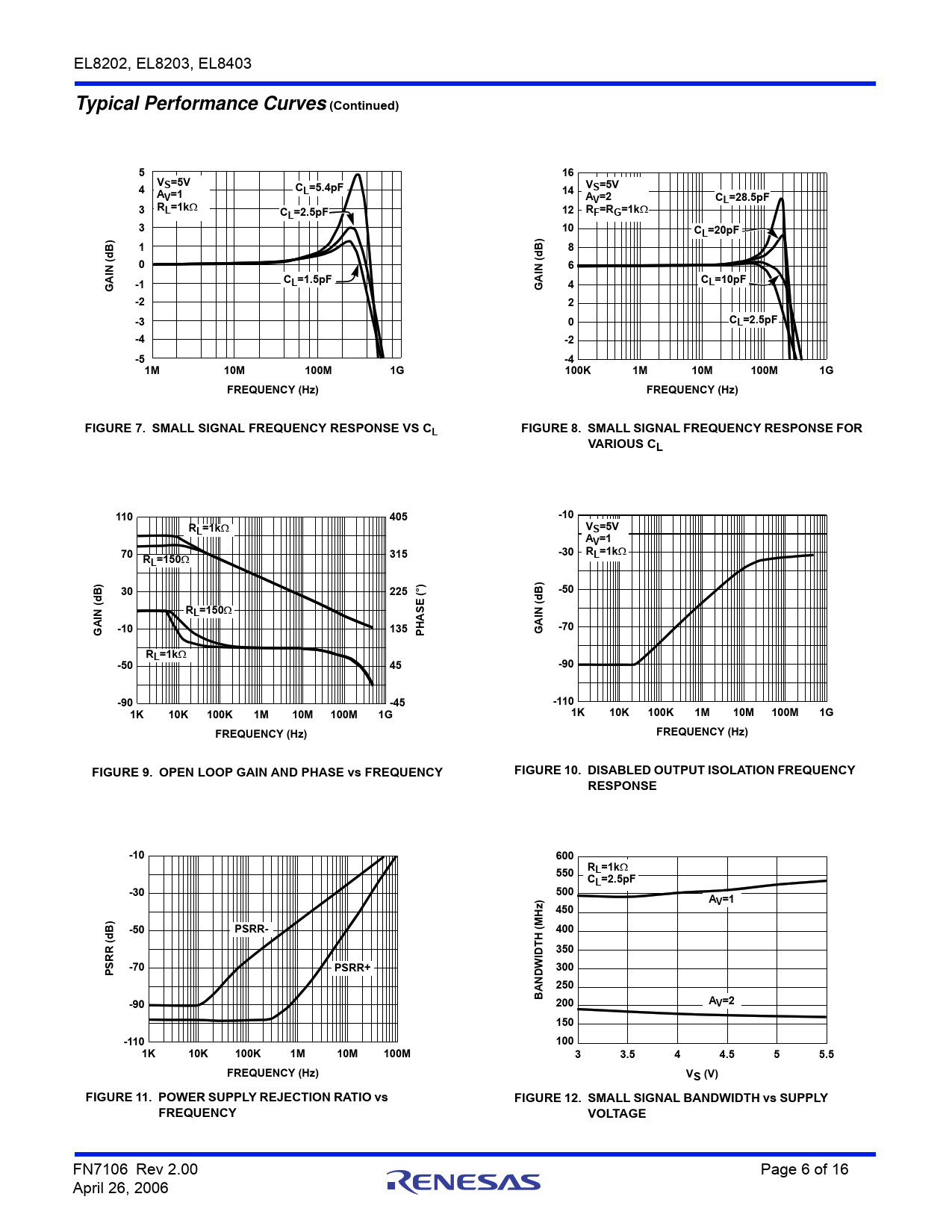

Typical Performance Curves. (Continued). VS=5V. L=5.4pF. S=5V. V=1. AV=2. CL=28.5pF. RL=1k. 12 R. L=2.5pF. F=RG=1k. L=20pF. dB) ( N. CL=10pF. GAI
Typical Performance Curves (Continued) VS=5V L=5.4pF S=5V V=1 AV=2 CL=28.5pF RL=1k 12 R L=2.5pF F=RG=1k L=20pF dB) ( N CL=10pF GAI
EL8202, EL8203, EL8403
Typical Performance Curves (Continued) 5 16 VS=5V 4 C V L=5.4pF S=5V A 14 V=1 AV=2 CL=28.5pF 3 RL=1k C 12 R L=2.5pF F=RG=1k 3 10 C ) L=20pF 1 8 dB) ( N 0 6 -1 C CL=10pF GAI L=1.5pF 4 GAIN (dB -2 2 -3 0 CL=2.5pF -4 -2 -5 -4 1M 10M 100M 1G 100K 1M 10M 100M 1G FREQUENCY (Hz) FREQUENCY (Hz) FIGURE 7. SMALL SIGNAL FREQUENCY RESPONSE VS CL FIGURE 8. SMALL SIGNAL FREQUENCY RESPONSE FOR VARIOUS CL 110 405 -10 RL=1k VS=5V AV=1 70 315 -30 R R L=1k L=150 ) ) B 30 225 (° -50 dB) (d ( N RL=150 N -10 GAI 135 PHASE -70 GAI RL=1k -50 45 -90 -90 -45 -110 1K 10K 100K 1M 10M 100M 1G 1K 10K 100K 1M 10M 100M 1G FREQUENCY (Hz) FREQUENCY (Hz) FIGURE 9. OPEN LOOP GAIN AND PHASE vs FREQUENCY FIGURE 10. DISABLED OUTPUT ISOLATION FREQUENCY RESPONSE -10 600 R 550 L=1k CL=2.5pF -30 500 AV=1 450 ) B -50 PSRR- 400 d 350 RR ( S -70 P PSRR+ 300 250 BANDWIDTH (MHz) -90 200 AV=2 150 -110 100 1K 10K 100K 1M 10M 100M 3 3.5 4 4.5 5 5.5 FREQUENCY (Hz) VS (V) FIGURE 11. POWER SUPPLY REJECTION RATIO vs FIGURE 12. SMALL SIGNAL BANDWIDTH vs SUPPLY FREQUENCY VOLTAGE
