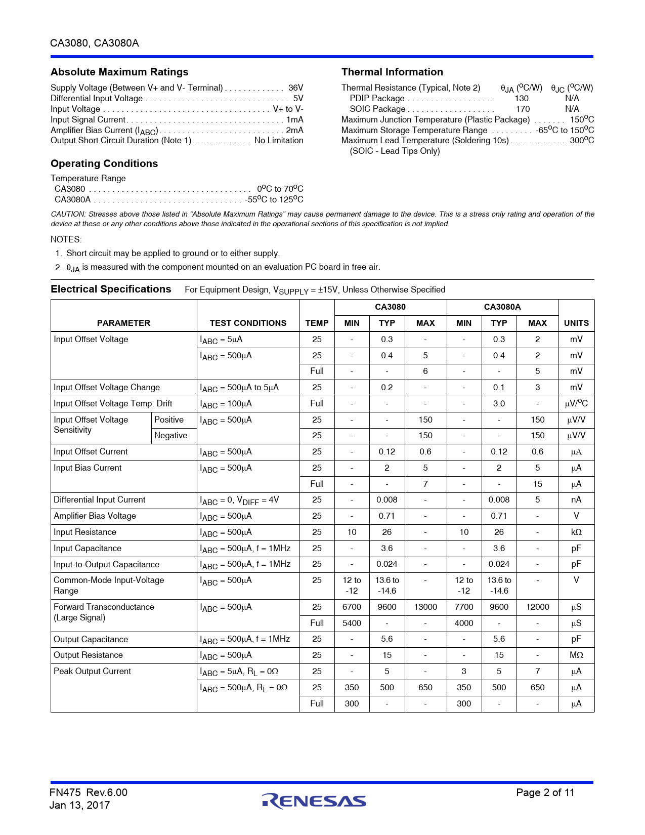

Datasheet CA3080, CA3080A (Intersil) - 2
ManufacturerIntersil
Description2MHz, Operational Transconductance Amplifier (OTA)
Pages / Page11 / 2 — Absolute Maximum Ratings. Thermal Information. Operating Conditions. …
Absolute Maximum Ratings. Thermal Information. Operating Conditions. Electrical Specifications. CA3080. CA3080A. PARAMETER
Absolute Maximum Ratings Thermal Information Operating Conditions Electrical Specifications CA3080 CA3080A PARAMETER
CA3080, CA3080A
Supply Voltage (Between V+ and V- Terminal) . 36V Thermal Resistance (Typical, Note 2) JA (oC/W) JC (oC/W) Differential Input Voltage . 5V PDIP Package . 130 N/A Input Voltage . V+ to V- SOIC Package . 170 N/A Input Signal Current. 1mA Maximum Junction Temperature (Plastic Package) . 150oC Amplifier Bias Current (IABC). 2mA Maximum Storage Temperature Range . -65oC to 150oC Output Short Circuit Duration (Note 1). No Limitation Maximum Lead Temperature (Soldering 10s) . 300oC (SOIC - Lead Tips Only)
Temperature Range CA3080 . 0oC to 70oC CA3080A . -55oC to 125oC CAUTION: Stresses above those listed in “Absolute Maximum Ratings” may cause permanent damage to the device. This is a stress only rating and operation of the device at these or any other conditions above those indicated in the operational sections of this specification is not implied. NOTES: 1. Short circuit may be applied to ground or to either supply. 2. JA is measured with the component mounted on an evaluation PC board in free air.
For Equipment Design, VSUPPLY = 15V, Unless Otherwise Specified
CA3080 CA3080A PARAMETER TEST CONDITIONS TEMP MIN TYP MAX MIN TYP MAX UNITS
Input Offset Voltage IABC = 5A 25 - 0.3 - - 0.3 2 mV IABC = 500A 25 - 0.4 5 - 0.4 2 mV Ful - - 6 - - 5 mV Input Offset Voltage Change IABC = 500A to 5A 25 - 0.2 - - 0.1 3 mV Input Offset Voltage Temp. Drift IABC = 100A Ful - - - - 3.0 - V/oC Input Offset Voltage Positive IABC = 500A 25 - - 150 - - 150 V/V Sensitivity Negative 25 - - 150 - - 150 V/V Input Offset Current IABC = 500A 25 - 0.12 0.6 - 0.12 0.6  Input Bias Current IABC = 500A 25 - 2 5 - 2 5 A Ful - - 7 - - 15 A Differential Input Current IABC = 0, VDIFF = 4V 25 - 0.008 - - 0.008 5 nA Amplifier Bias Voltage IABC = 500A 25 - 0.71 - - 0.71 - V Input Resistance IABC = 500A 25 10 26 - 10 26 - k Input Capacitance IABC = 500A, f = 1MHz 25 - 3.6 - - 3.6 - pF Input-to-Output Capacitance IABC = 500A, f = 1MHz 25 - 0.024 - - 0.024 - pF Common-Mode Input-Voltage IABC = 500A 25 12 to 13.6 to - 12 to 13.6 to - V Range -12 -14.6 -12 -14.6 Forward Transconductance IABC = 500A 25 6700 9600 13000 7700 9600 12000 S (Large Signal) Full 5400 - - 4000 - - S Output Capacitance IABC = 500Af = 1MHz 25 - 5.6 - - 5.6 - pF Output Resistance IABC = 500A 25 - 15 - - 15 - M Peak Output Current IABC = 5A, RL = 0 25 - 5 - 3 5 7 A IABC = 500A, RL = 0 25 350 500 650 350 500 650 A Full 300 - - 300 - - A FN475 Rev.6.00 Page 2 of 11 Jan 13, 2017
